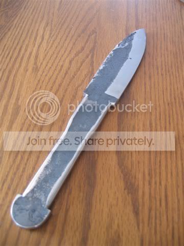

From the scketch book to the forge to the workbench... my knife is coming along slowly but surely.... I am an amature knife maker at best... so I tend to take the long way to avoid trashing a blade on the grinder...
The first pic is my plan on paper... alot of thought went into this knife... I incorporated everything I like and need from a hardworking Bushknive....
-1/4" stock of 1085 (after forging it ended up a little thicker)
-full convex grind
-I wanted to use it for flint and steel firestarting so I originally was going to leave the spine hard but decided to temper the spine for toughness and harden the butt for casting sparks.
-cord wrapped handle. I wanted to have a handle that was serviceable/replaceable in the field. it is ground to be comfortable to use bare in a pinch if you needed the cordage. There is a swell to prevent sliding since it has no guard (personal preference)
- I left hammer marks in it for the cool factor

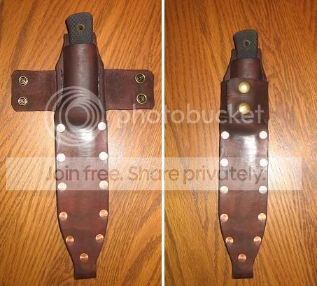

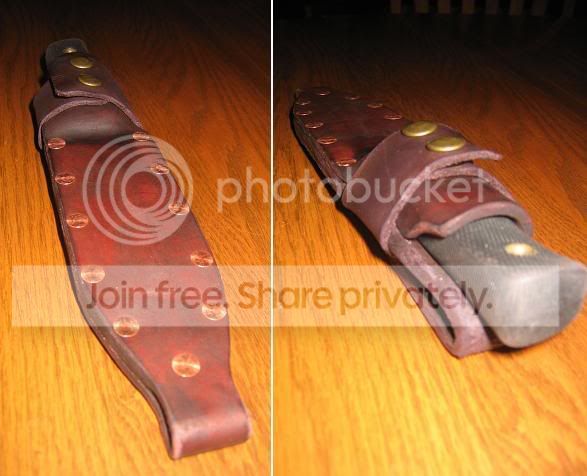

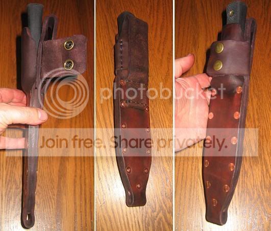

I'm also making the sheath right now and have included progress pics.

After the forge
After some filework
After more filework
Sheath progress pics..

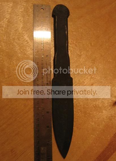

Like I said.... It took a lot of time trying to finalize this design. From length to width to balance. (It'd make a good thrower too) I have had several prototypes in the bush over the past 4-5 years and have been slowly tweeking this into shape. The Bushknife is special to me.... until something else pops up and the cycle begins all over again... the perfect knife is just out of reach it seems.... lol
What is different about this attempt is that I was fortunate to befriend Master Bladesmith, Wally Hayes... and he offered to help me with the forging and heat treat... He's a very generous, humble man and a great guitar player to boot!
Here is a pic of one of the prototypes...

Right now, I have a mini forge I made from the Zoeller site. I won't do the heat treat here... I'll do it at Wally's shop.
The leather stain is EcoFlow from Tandy... it's water based and evironmentally friendly. The leather is cuttoffs from shoe and saddle makers. After the sheath is finished I will hot dip it in a mixture of beeswax, paraffin, mink oil and pine pitch.
It will be riveted like this one I did for an SRK...
