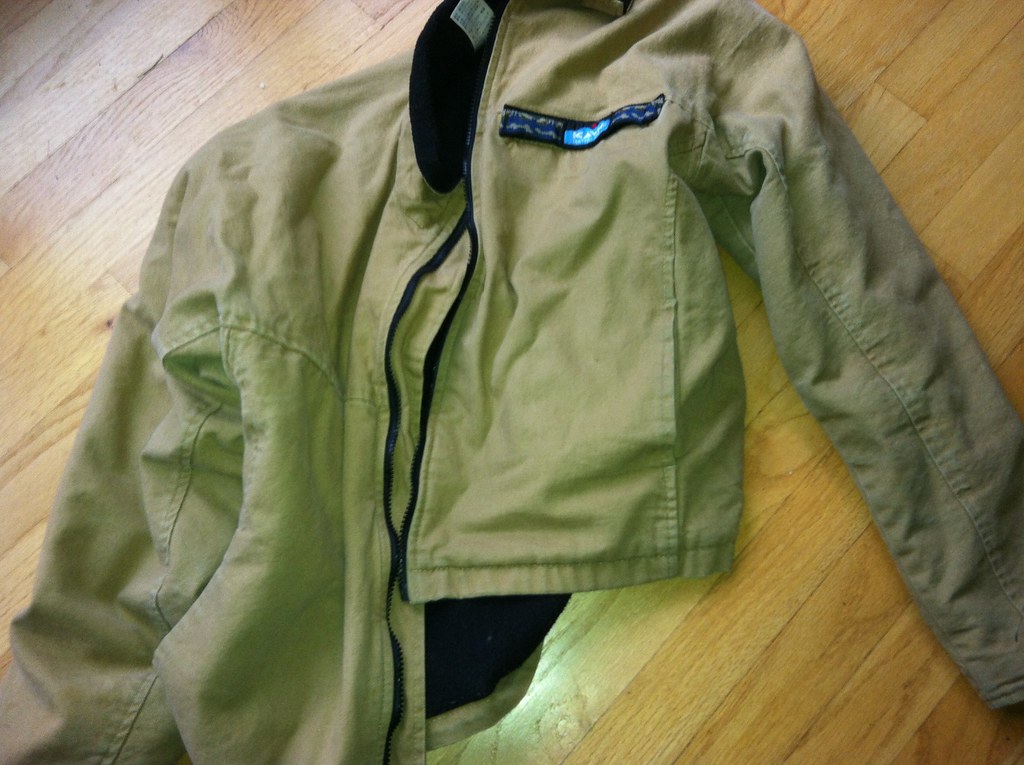

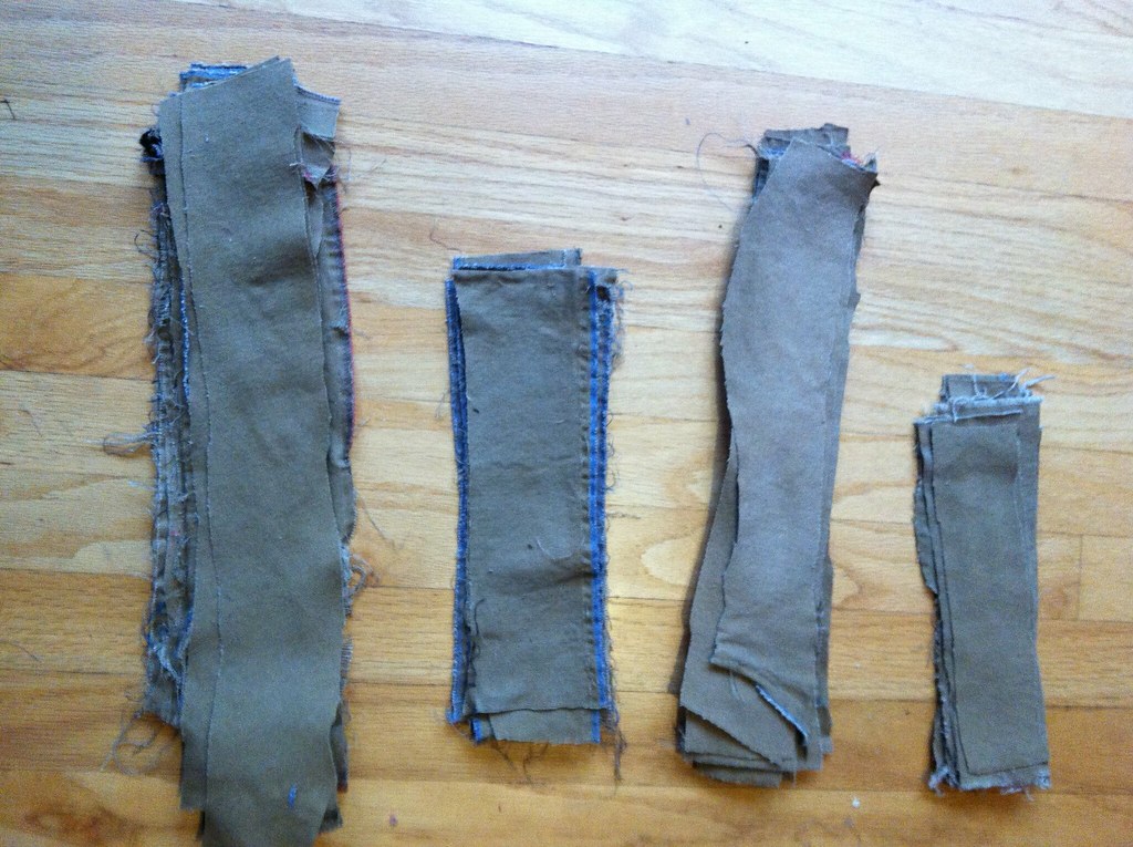

so, i watched a couple youtube videos about it. and, i figured...heck, i can do that. that's easy enough.
so, i found me a jacket at Goodwill

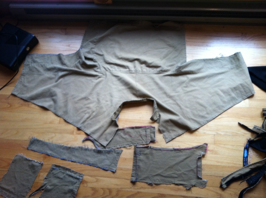

and proceeded to cut it up
keep cutting

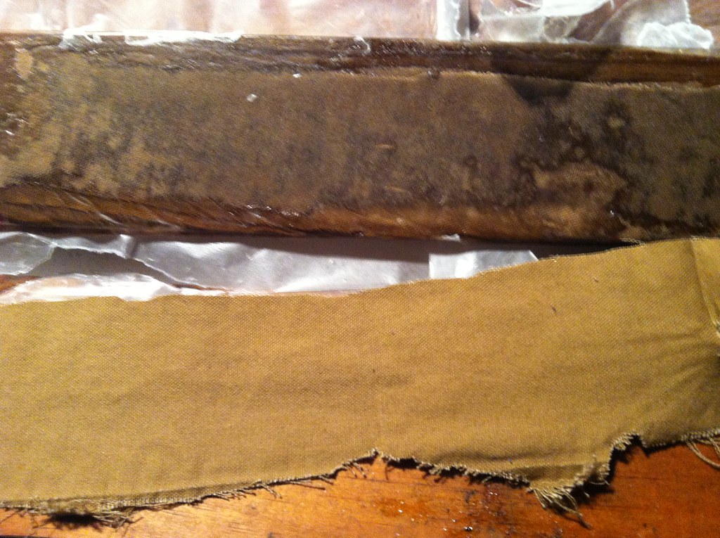

the top is final product...the bottom is just a raw comparison shot
now, on to the failure. it didn't work. it had 3 days to cure and it just didn't set up. it's still kinda floppy and it certainly isn't hard. i can dig my fingernail in, and really, the top layer is still mostly canvas.
a couple things i am wondering about
1) the videos were in the summer during the heat. they recommended using only half the hardener. that is what i did. perhaps the weather is cool enough that i needed to use more hardener
2) i was running out of resin at the end. maybe i just skimped.
3) i suck at making micarta (hi-oooo)
i will try again. but honestly, after going through the process....and knowing what micarta slabs cost....it's probably better to just buy micarta.
i know i saw someone on this forum who made micarta before, but for the life of me...i can't remember who it was. if anyone has any feedback...obviously, i could use it. :D
Stupid question; was it washed and dried, I would imagine grease and oil would mess with the set up. Also, I mix per the instructions on the resin can and have had no issues.

thanks guys. and yeah...that's what i figure too. i am definitely not going to skimp on the hardener my second go around. lesson learned. i fully expected it to be a learning experience anyway. so, i guess i was successful!! :D

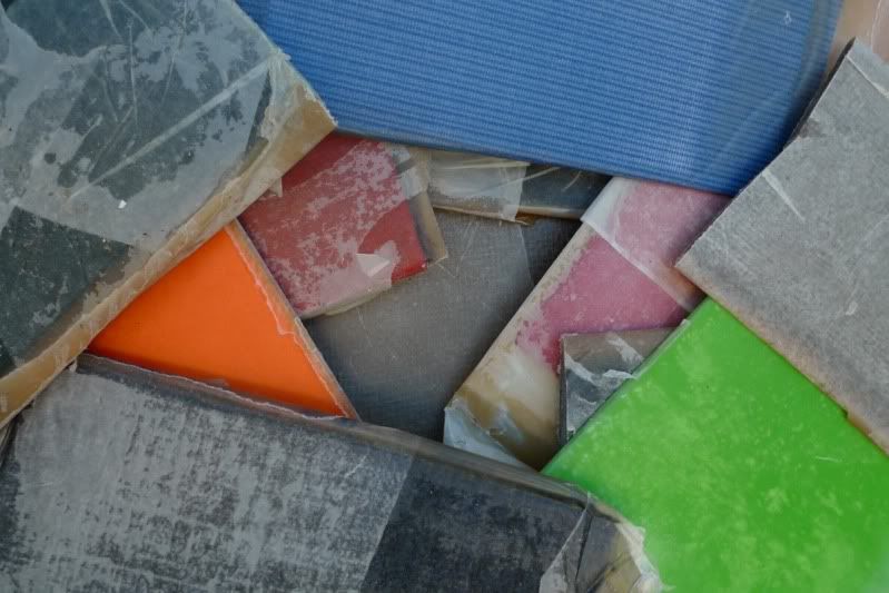

the GID are white cotton cloth micarta in which I added blue phosphor powder into the epoxy mixture
btw, back to the topic, I agree, you must be lack on hardener. I always use epoxy glue that needs 1:1 for the resin - hardener. I also use low/long setting glue. and I give plenty glue to avoid "flappy" fabrics.
this is what I got after pressing:
I build micarta myself because here the price of importing the micarta is.... more expensive :D

it's hard to say on the thickness. different materials will have different thickness. i didn't count, but i used about 10 strips of this jacket. it was a heavier "canvas" type material. after pressing, it may have been just about 1/4". i would have made it thicker, but i actually ran out of my resin mix.
specifically, i mixed 8 oz of resin with about 70 drops of hardener. it said use 14 drops per oz. that would have been 112. 56 would have then been half, so i used a little bit more than half. like others have said, i am going to actually follow the instructions this next time and see what i get. Plus, i am definitely going to start with more than 8 oz. just wanted to mention what i started with, in case you try to give it a go.
i suppose the amt of resin you need would also be dependent a bit on thickness of material. i suppose a thicker material would require more to get to saturation. i clearly didn't get it saturated either. so, this next time, i am going to start with at least 12 oz.

based in what I've experienced, normally after the pressing there's about 1/4 until half of the initial stack of sheets. but I put a lot of glue (I soaked the sheets in the glue before stacking) so YMMV.
I'm not fond of any epoxy/resin products, but what I use is the one used for fixing fiberglass boats. and they are based on 1:1 amount of resin and hardener (the package is about 250grams of resin and 250 grams of hardener in different cans), and it costs me under 10 bucks I think. I have a fellow knifeknut in my country, and he suggested me to steer away from epoxies that uses "drops" for the hardener, as it doesn't as strong as the epoxy I am using. But I have never tried another. hope this helps :)

I use G/Flex epoxy for glueing on handles. this is the good stuff. the 1-to-1 stuff. BUT...it is expensive. and, i wasn't going to buy a jug of it. the videos i've seen used this Fiberglass Resin stuff, and they didn't have a problem with it. as you said...it is the same stuff for patching boats. i will try doing it correctly, and see if i have better luck. :D

More hardener and more resin... it doesn't look like the resin soaked through the fabric. You may want to check the local fabric store and buy some canvas. They are only like $3.99 per yard and you get to pick the colors.
