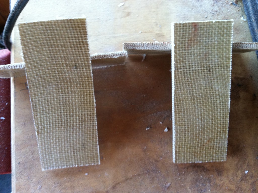

my first attempt at homemade micarta
looks the same myke. and, it is hard all the way through. it set up nice.

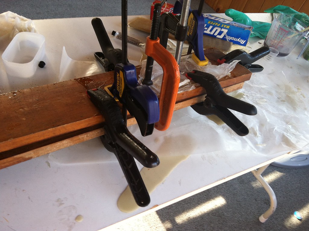

and yes, i had some scrap 1 x 6 (ish) wood that i cut down. i use multiple spring clamps and 2 C-clamps to press.

I got this burlap for maybe $3.00/yd at the fabric store. i only bought one yard and it looks like that should make me 3 sets of scales.
they had other colors, but i am sure the RIT dye would work, if you wanted to use it. i chose a light color, because i knew the resin would darken it up. so, keep that in mind as you are thinking about colors.
i got a new batch going today at lunch. someone asked about my setup, so snapped a quick pic.
came out pretty good, i think. not as thick as i had hoped, but i have some liner material. glueing it up right now!
thanks Peter. i can't wait to see how it looks all put together. i.e. i am interested to see how it looks formed and sanded.
