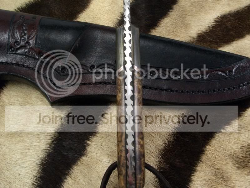

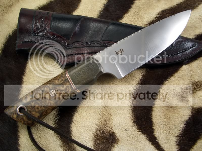

Here ya go,
Specs:
CPM 154 satin finished, fileworked
10" x 1.5" oal, 5" blade
Stabilized black ash burl handle material (Thank You Tracy Mickley) w/black spacers
Dovetailed birdseye damascus bolster
Copper/SS thong tube, Copper/SS mosaic pin, Copper/SS spacers
Sheath is my own
Thanks for looking!

Beautiful work on the knife and sheath. This may be your first dovetails but you nailed it perfectly.

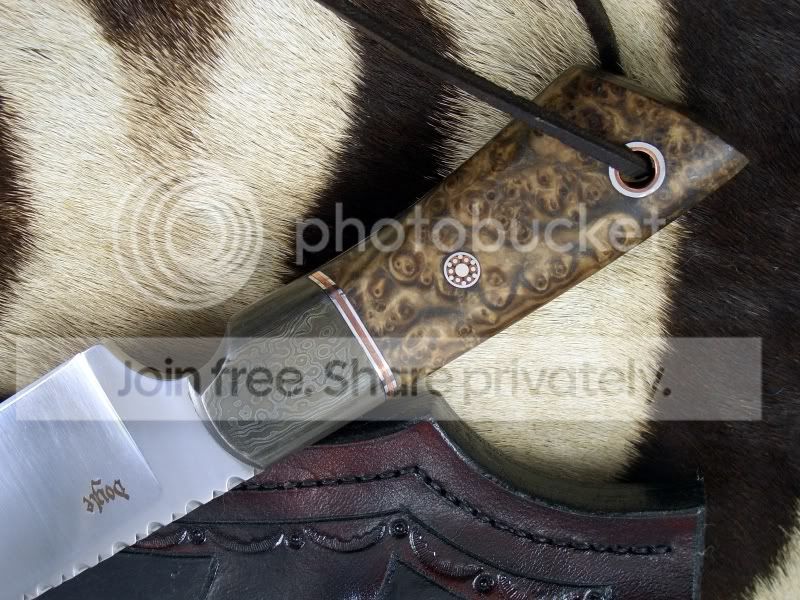

Beautifully crafted knife....love the use of stainless with copper....the bolster of damacus and ash burl handle are stunning.
Well done! Excellent match up of the black ash burl bird's eye patterned wood with the bird's eye patterned damascus bolsters. Thanks for posting.
I agree with Phil. The knife looks like it was built with the skill of a master craftsman and the eye of an artist. Excellent knife.

Phil,
I'm glad you noticed that. That's kinda the effect I was hoping for:thumbup:

Beautiful work and design! As others have said, it all flows together extremely well. I am curious as to how you attached the bolsters. I don't see any pins or other means. Did you weld them?
Randy
Hi Matt, Love the knife. Can you please tell me how your bolsters are attached i want to try damascus bolsters on a damascus blade but Im not sure how any tips. Thanks Brett
Nice. Is this done for art purposes? Personally all I see is stress raisers but for art I can see the value.
Brett,
The bolsters are hidden pinned using split roll pins, and then glued w/loctite speedbond 325.
Thanks again eneryone:D
Matt
