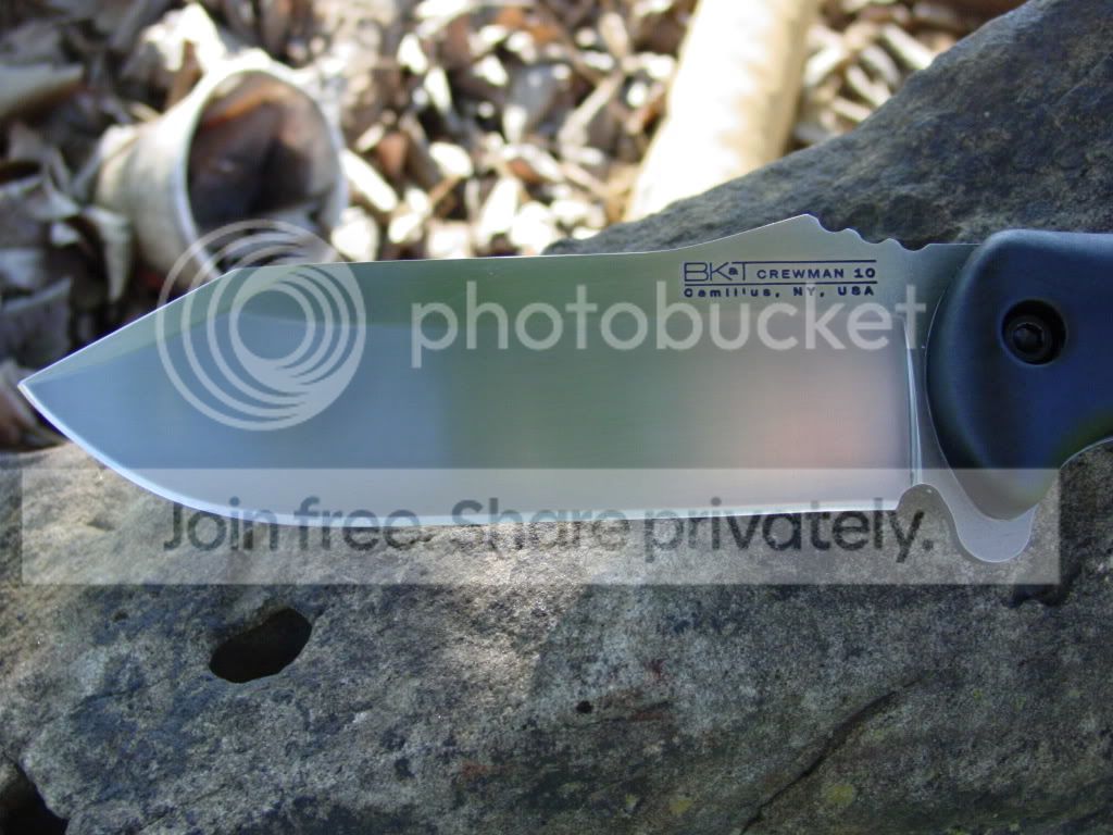

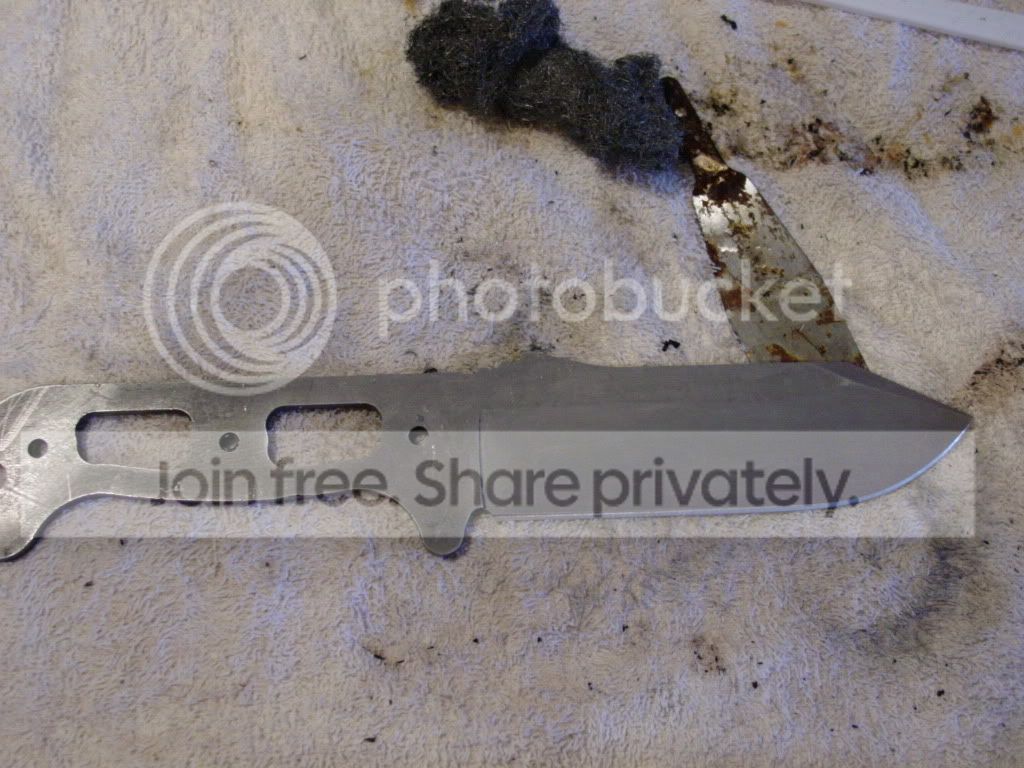

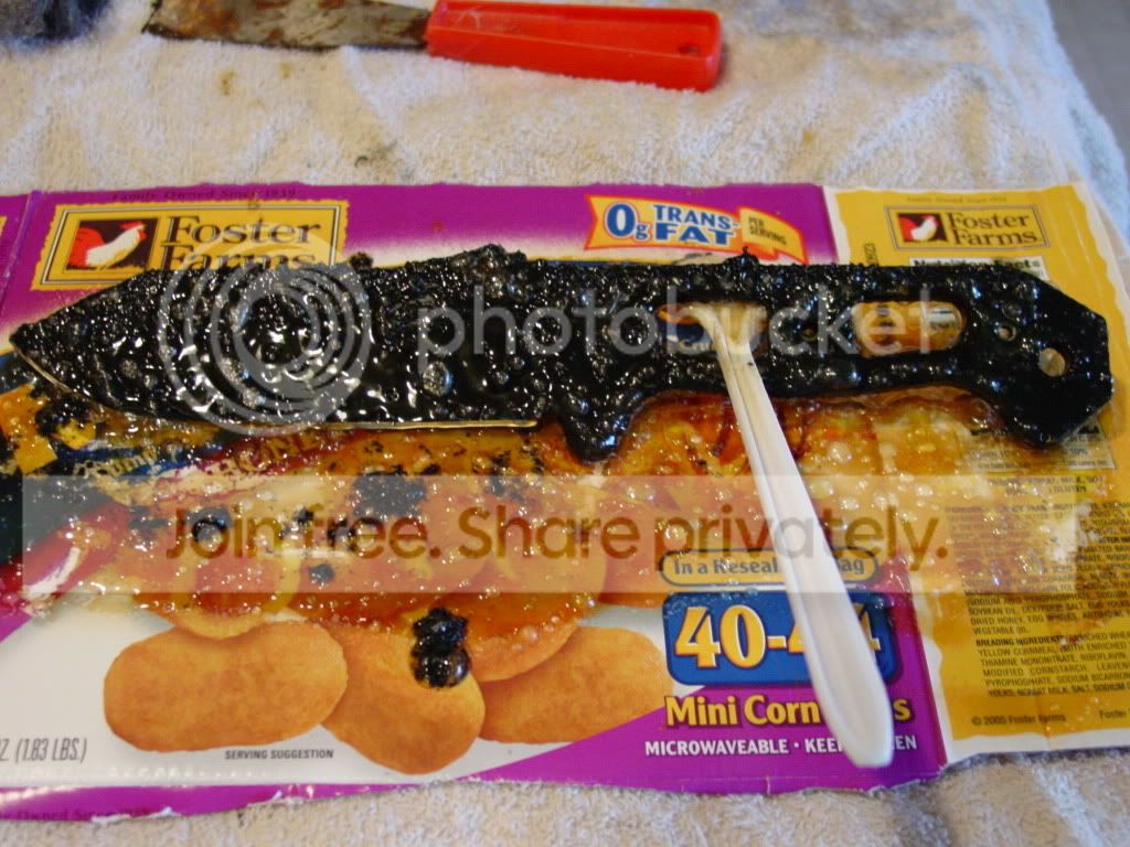

Here's my project and my first attempt to post pics. I had a Becker and wanted to get rid of that black coating. Pretty basic project compared to some on the forum but it's a start. I've still got a little work to touch it up, make a handle, and improve my picture taking.
Here's the coating soaking.
Here's the grey colored blade after removing the black coating.
Here's the blade almost finished. I probably won't work on it a whole lot more since it's going to be a worker. It seems like an entirely different blade without the black stuff.
I only polished the blade section. Although I kind of liked the grey patina. I going to start working on a wooden handle now.:)

Looks good! What did you use to strip off the black?
Thanks!
AndY
I used something called Sprayon Heavy Duty Paint Remover.
