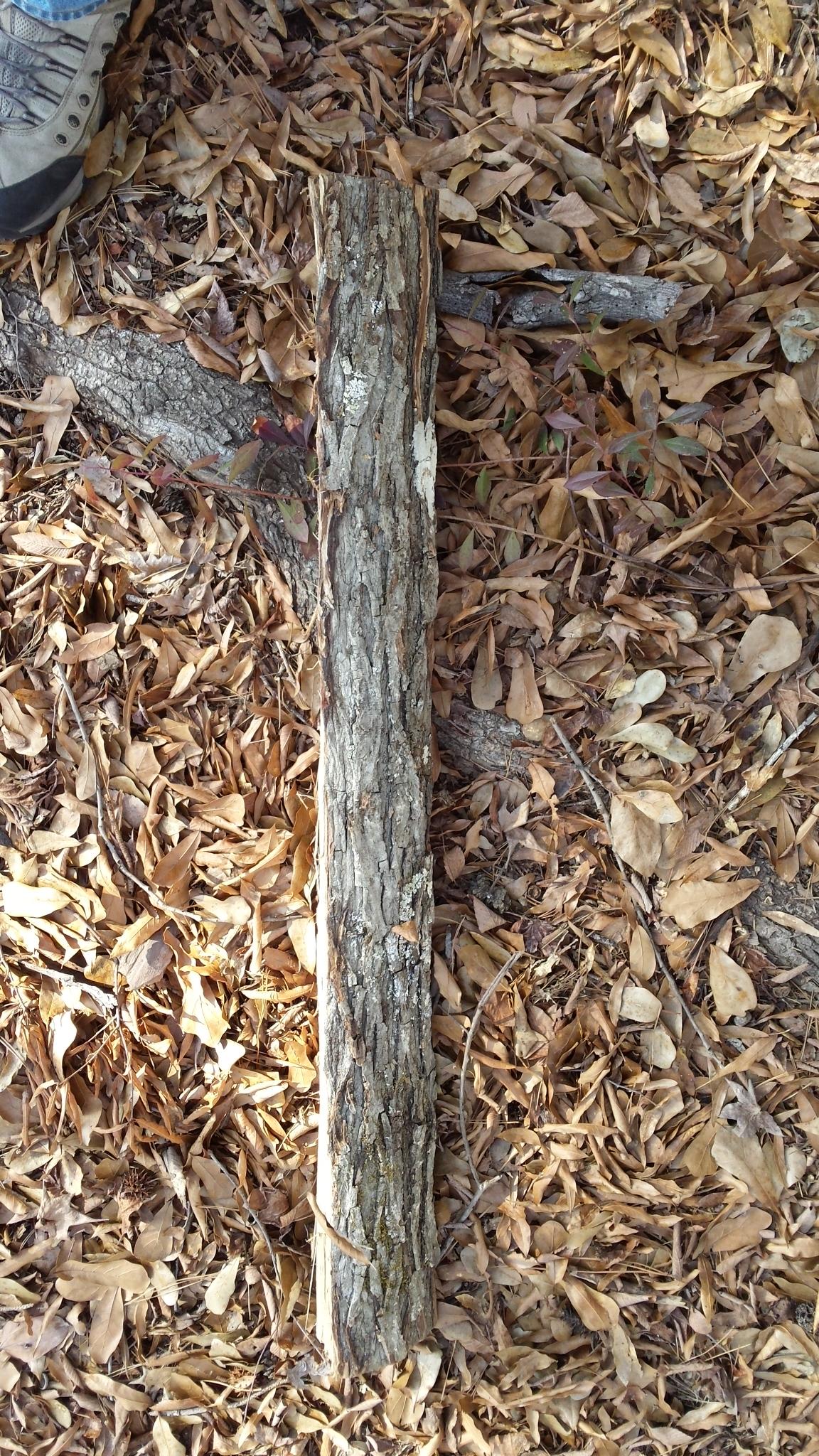

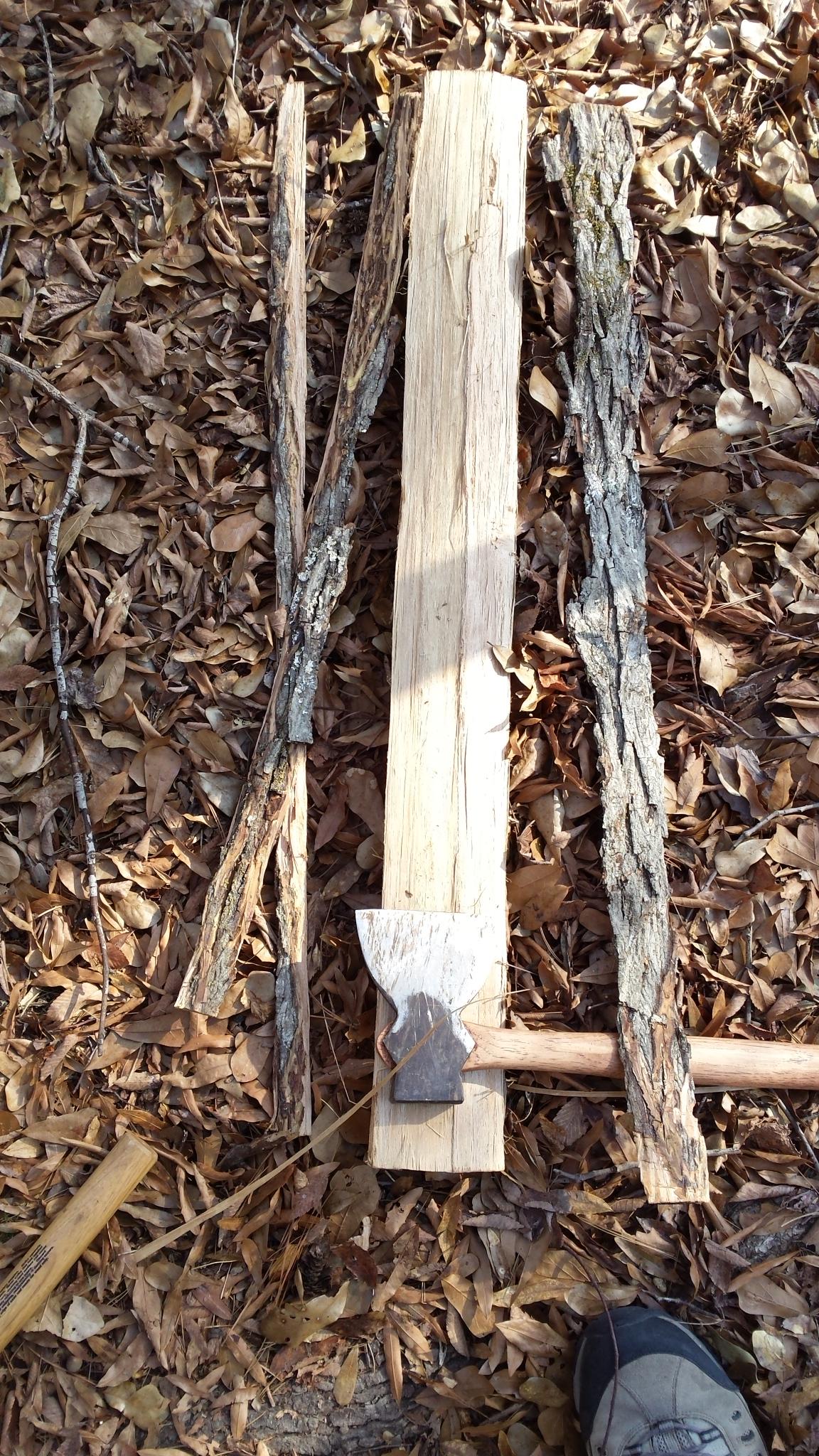

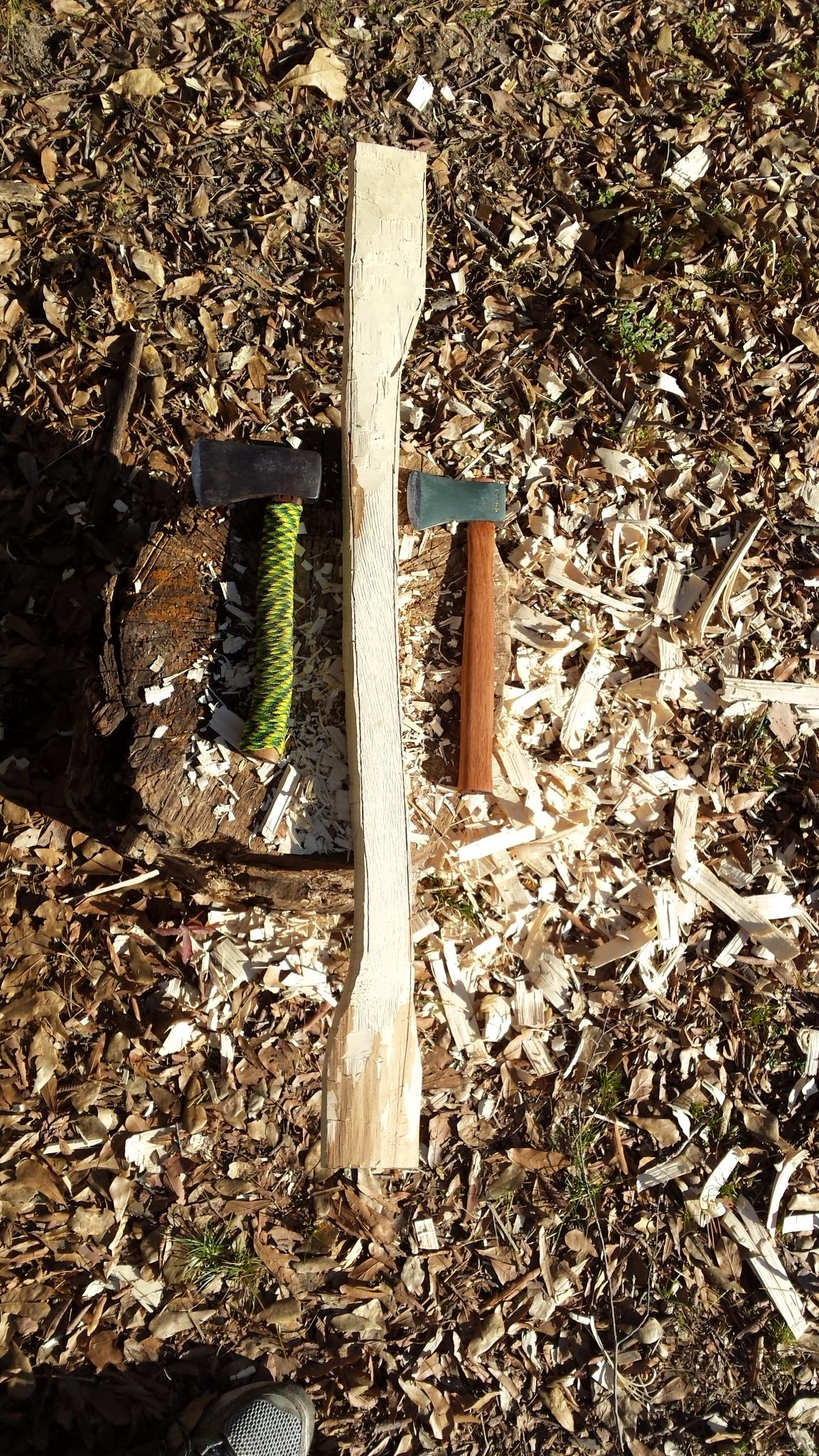

Made this one the hard way. No power tools. Hatchets, hand saw, rasps, and sand paper. I drew an outline on the stave from a pattern handle and the rest was by eye.
Got the bark off, it was on there real tight.

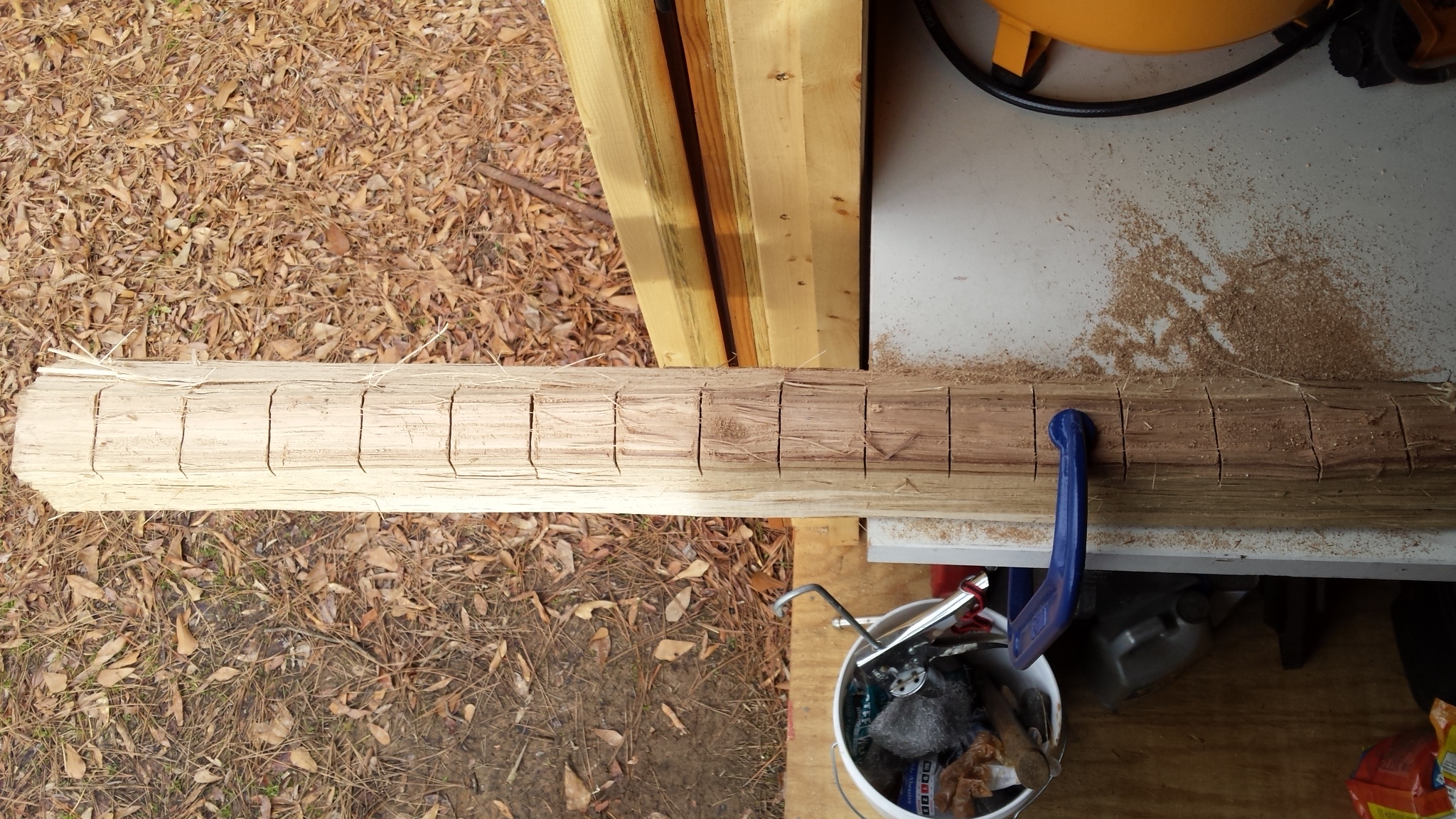

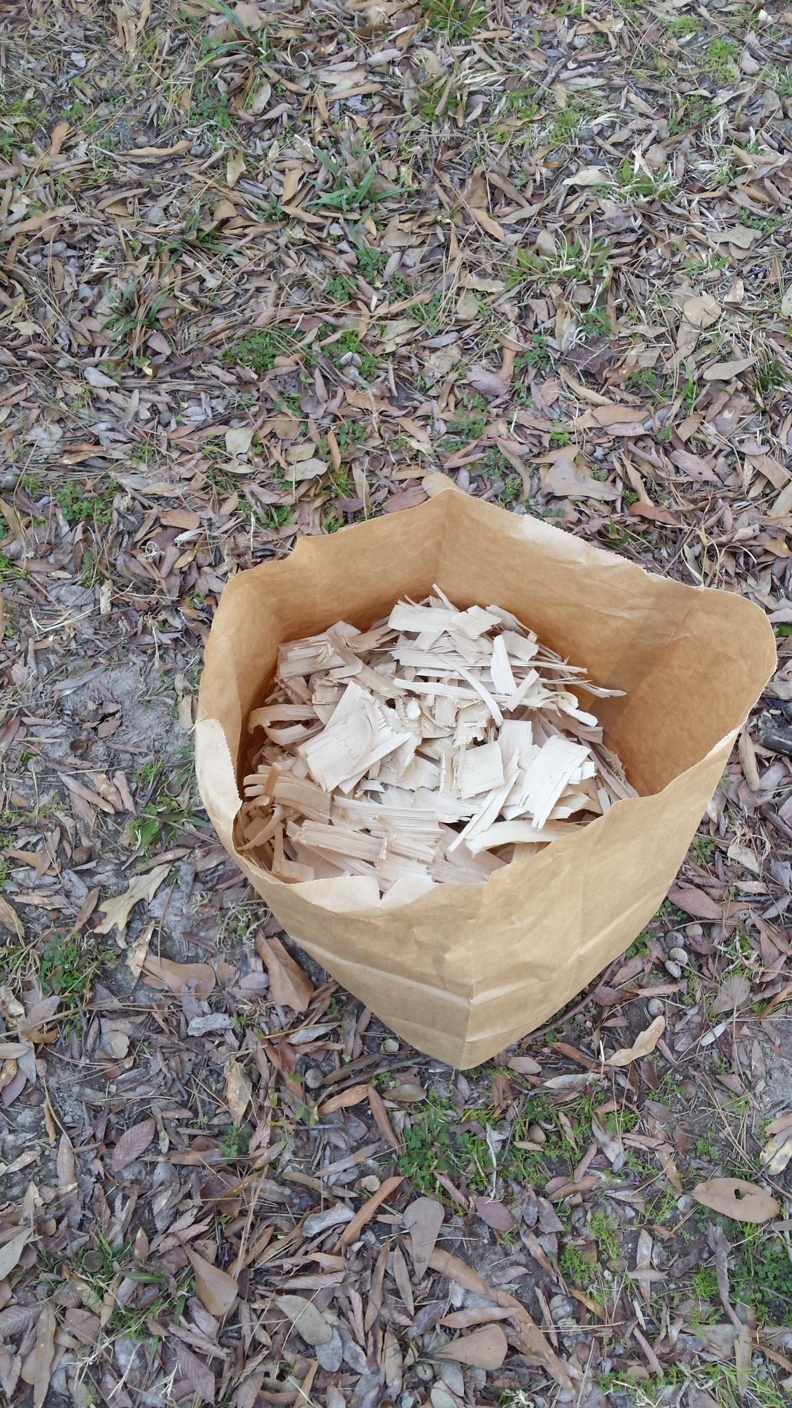

I cut down about 1.5" in sections and took them off with a hewing hatchet .
That thinned it down a bit.
Then roughed it to shape with hatchets.
The rest of thinning was done with hatchets and finished up with two different rasps.

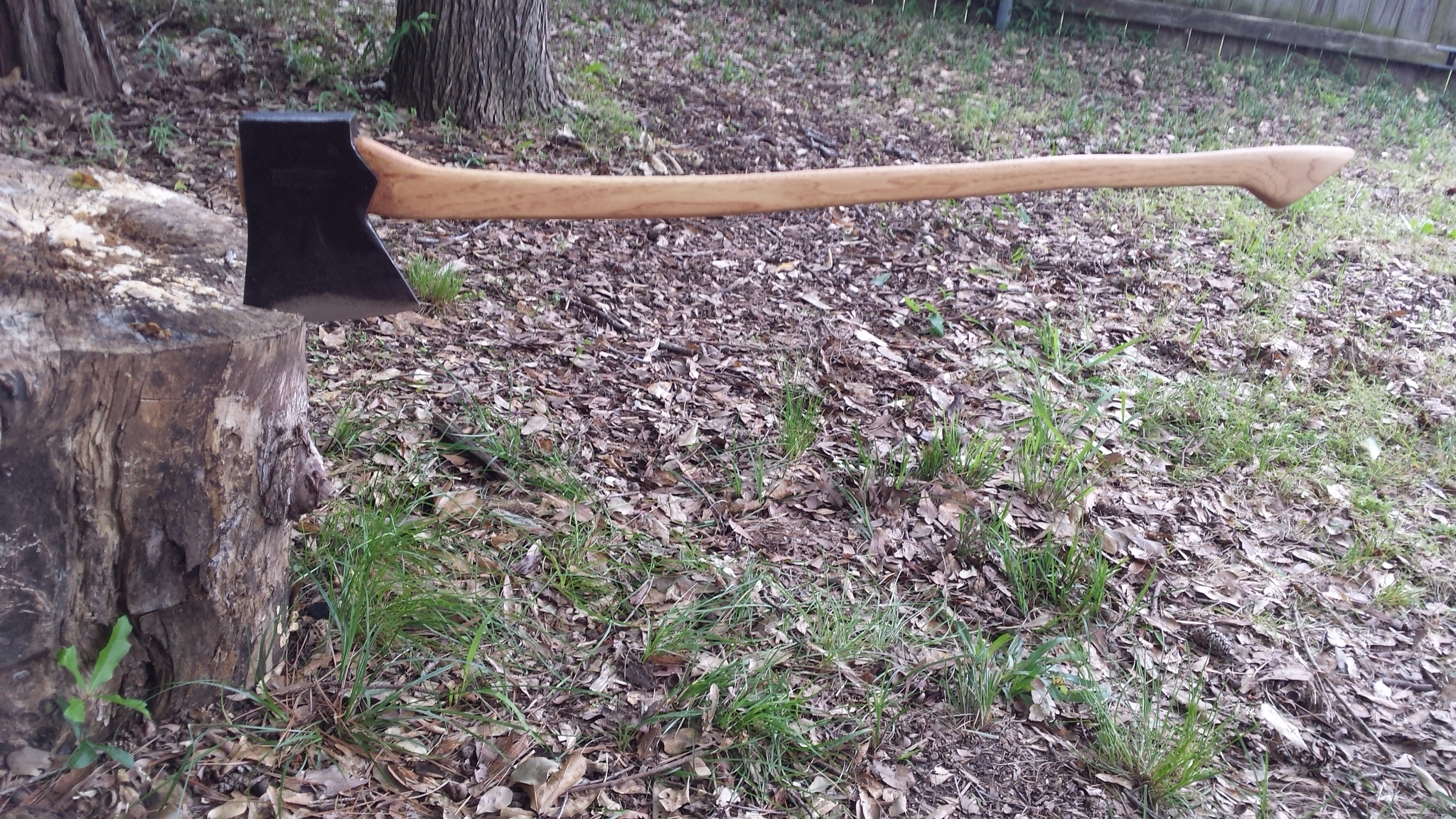

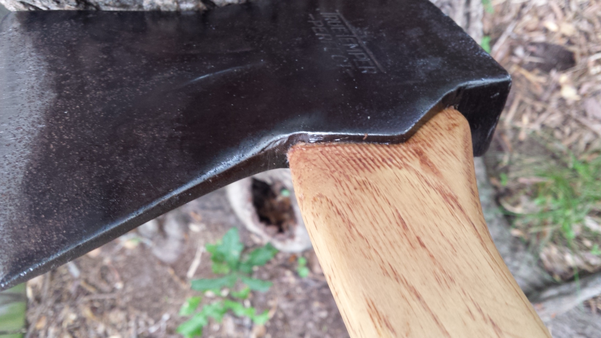

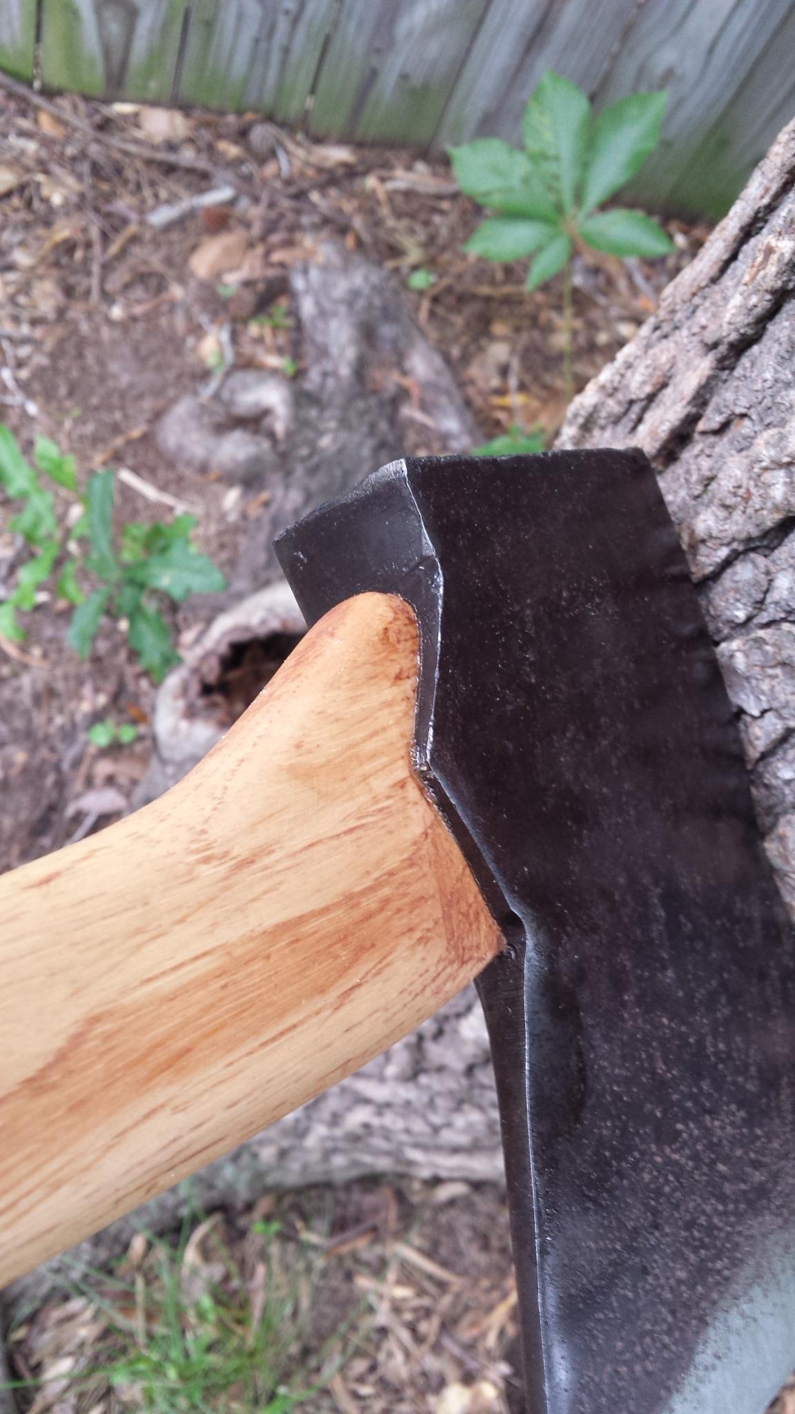

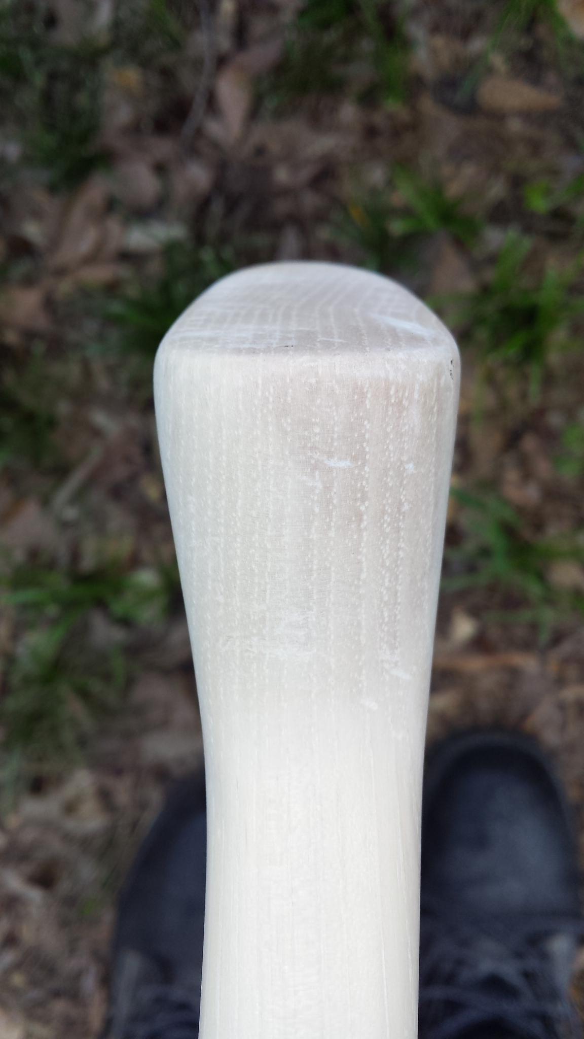

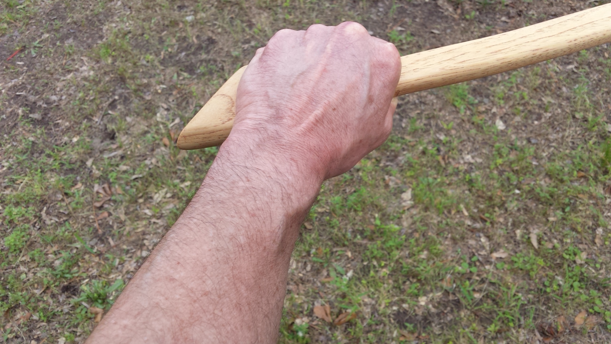

When I got to the fawns foot I decided to do something different. Feels good in hand. If it turns out uncomfortable in use there is plenty of wood to adjust the shape.
I have big hands so it feels good.

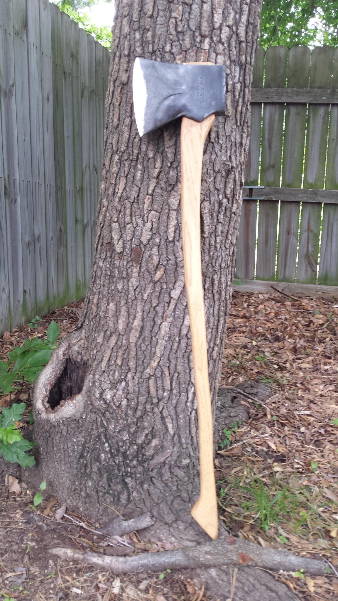

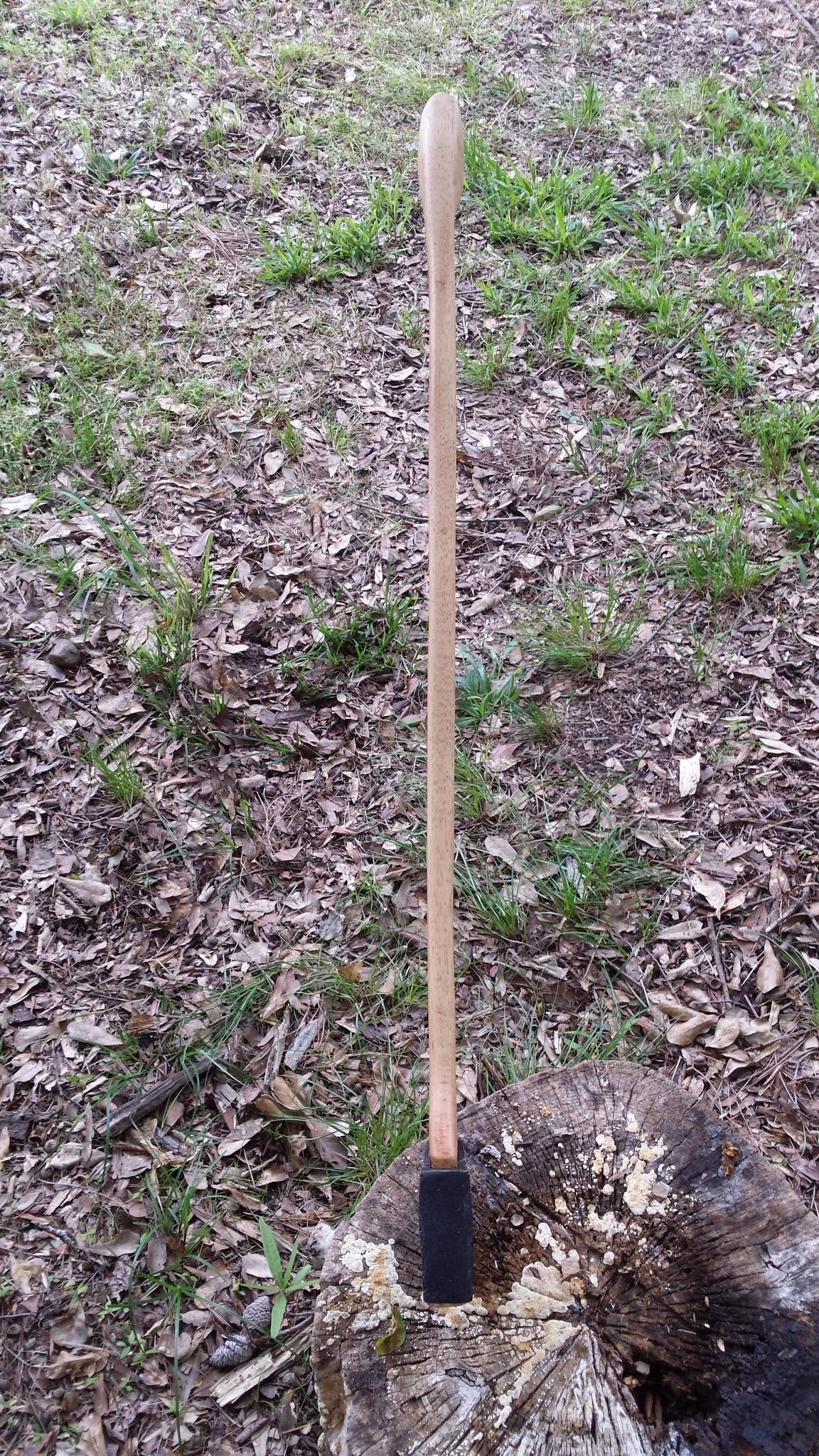

Here's the hang. Overall length is 36.5". After soaking up lots of BLO the handle weighed 1lb and 5 ounces. The jersey weighed in at exactly 3.5 lbs.

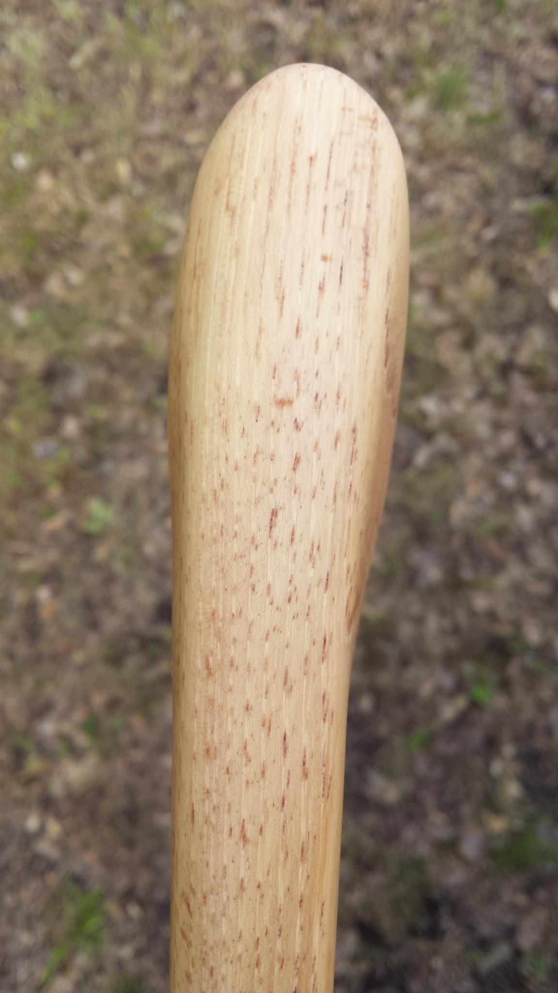

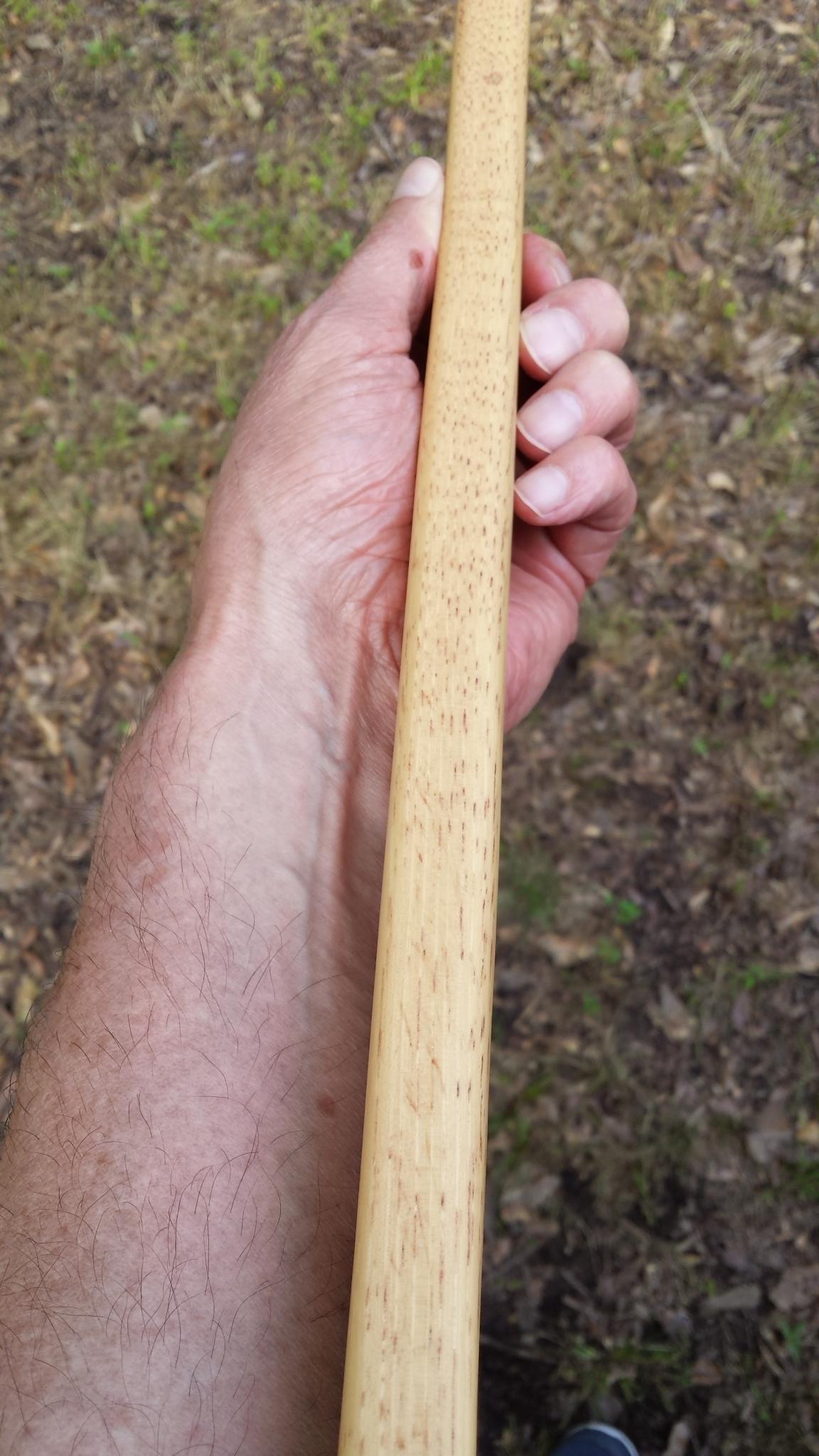

For those with grain orientation OCD

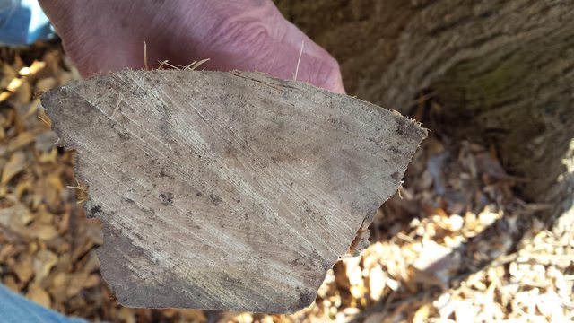

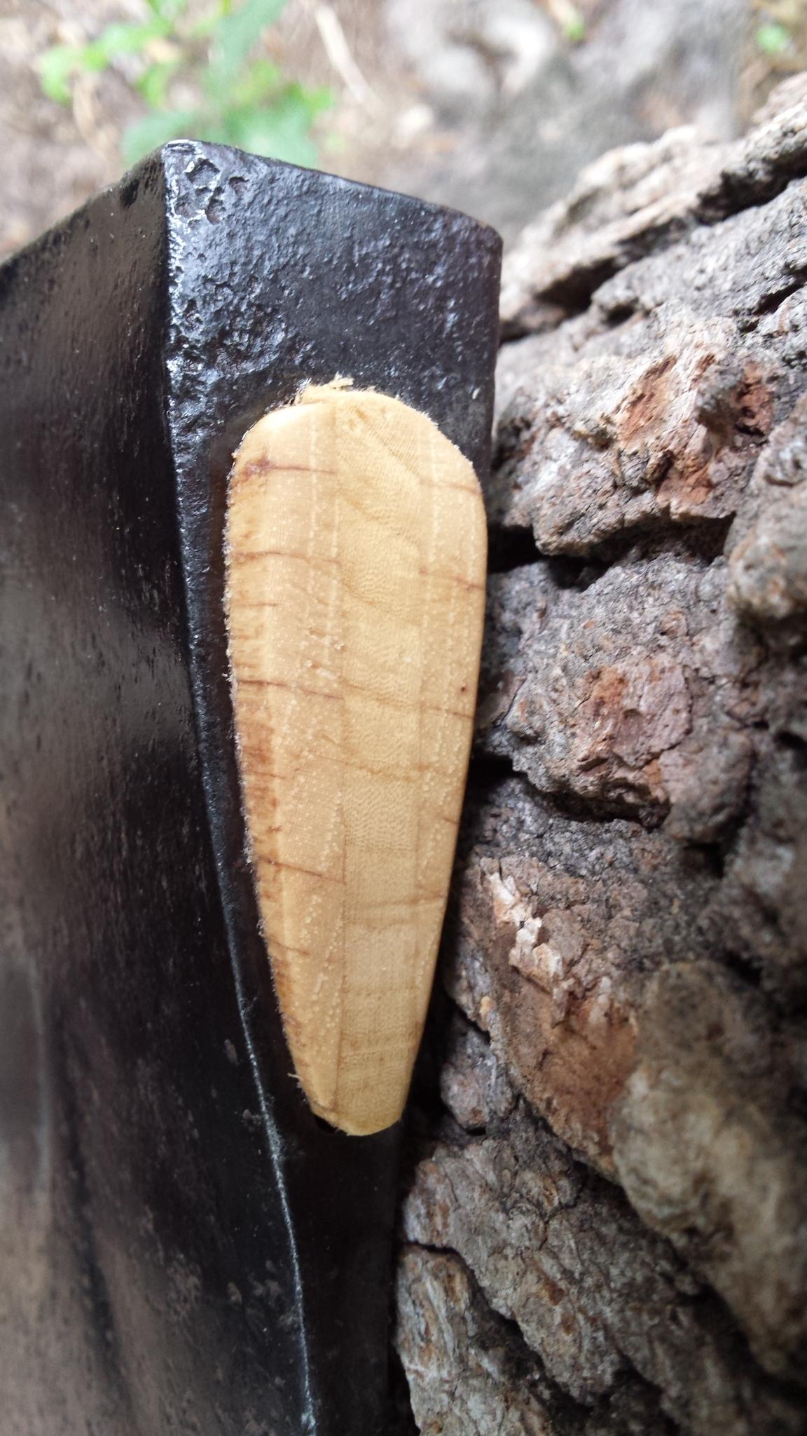

Runs straight all the way through.
There is a big difference between air dried hickory and kiln dried. This stave was the hardest piece of wood I've worked. It's a lot of work the way I went about it but I was in no hurry. I enjoyed it and have new found appreciation for life back in the day.

Well done! Feel free to beat your chest with pride in that accomplishment. In saving $15 over a store bought handle you earned $5000+ worth of knowledge and experience. And you'll probably never break that particular handle in your lifetime.

I don't think the long fawn's foot will be any problem - more likely a plus. It will never draw a blister in the heel of your palm like a clipped fawn's foot. And I like the drop at the eye to better balance the head.
Thoughtfully designed and well executed. Full marks!

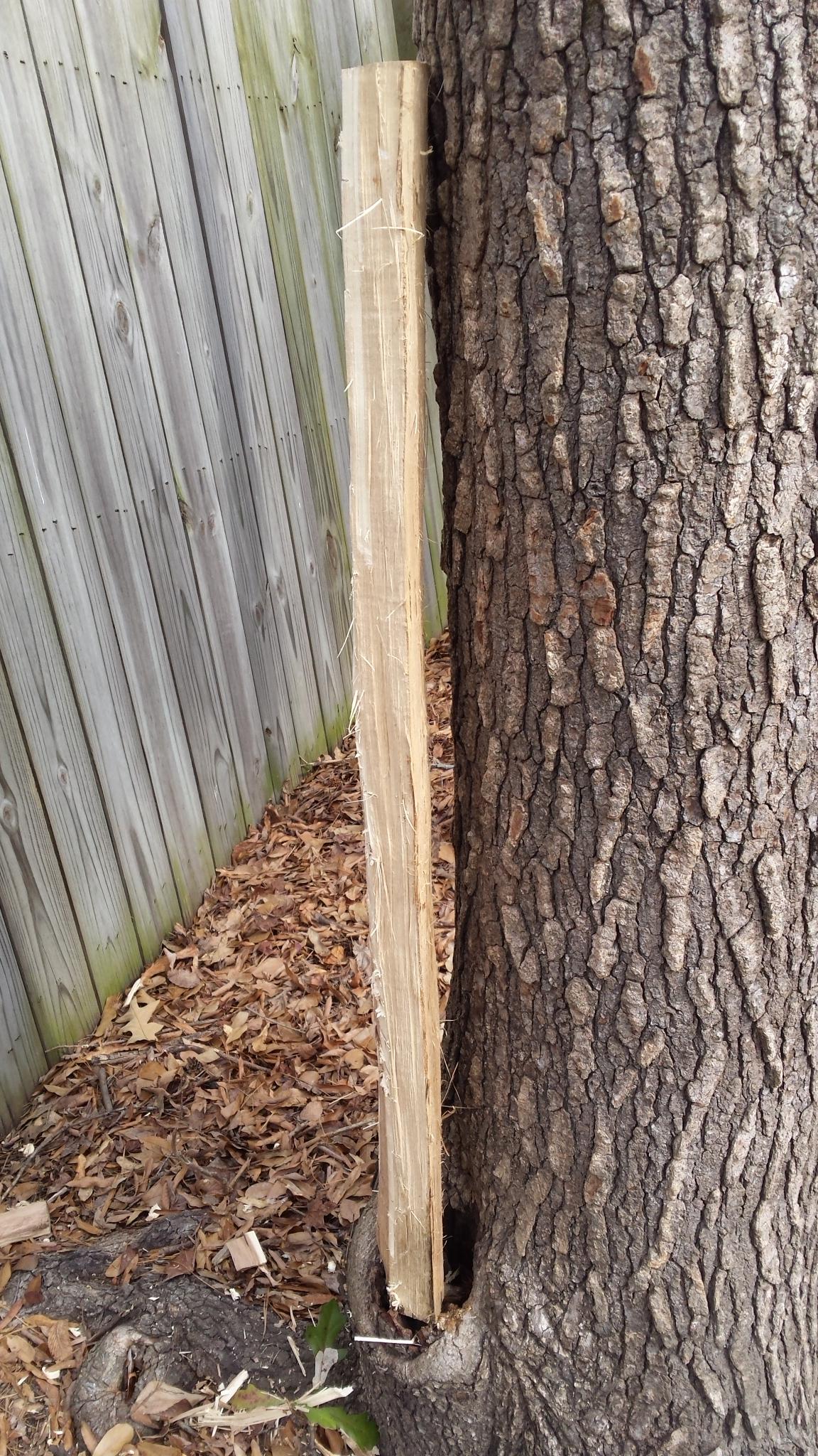

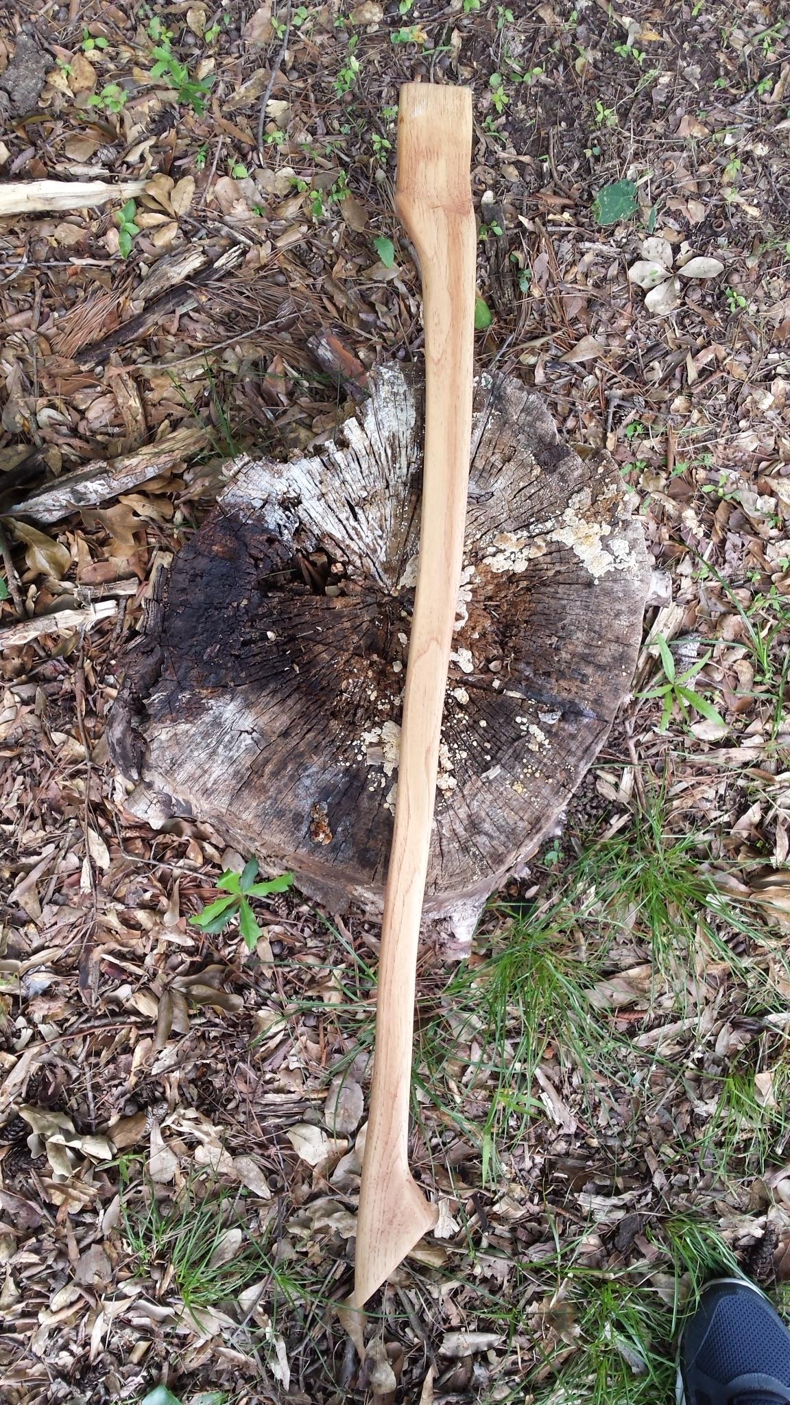

What hasn't been pointed out about riven staves; seek out as straight a one as you can, because a badly sideways-curved one defeats the whole purpose of the exercise. Unless of course you're carving/shaping a broad axe offset haft.
This one looked straight to me but apparently I created a bow in it along the way. With a little advice from Quinton I got it pretty close to perfectly flat.
