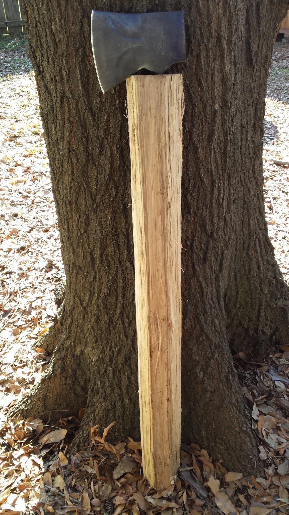

My first handle from a stave
it looks very good. I have a hatchet head I need to make a handle for (first attempt didn't go so well), appreciate all the pictures!
Post pictures of your hatchet head and you will get good advice on a handle. It may be easier to buy a handle and fit the head rather than make one from a stave. Thanks
This one looked straight to me but apparently I created a bow in it along the way. With a little advice from Quinton I got it pretty close to perfectly flat.
Nice looking piece of wood! My comment about straight vs crooked staves was not aimed to you. I could see right off that you selected wisely. You don't obtain straight staves from a crooked log!

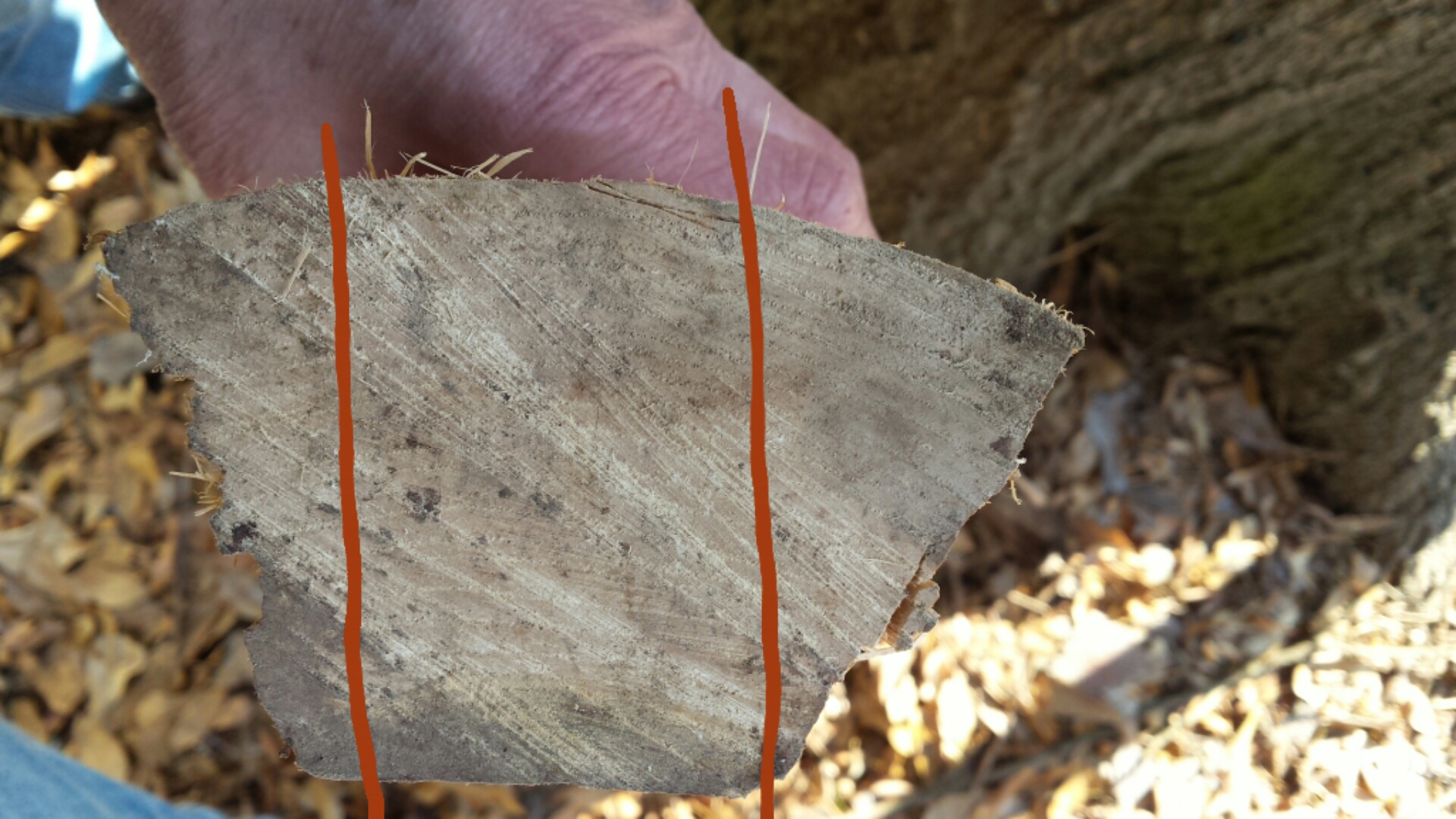

In order to have gone with horizontal grain on this handle I would have to work within the red lines. Not enough thickness as quinton stated earlier. But I'm waiting patiently on this new batch he is drying. Maybe I can talk him out of a good thick one.
And as you see it tapered down on the end for the fawns foot.
