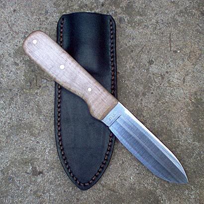

Hello all,

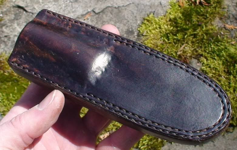

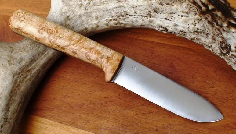

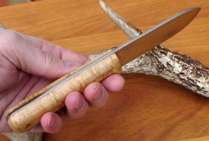

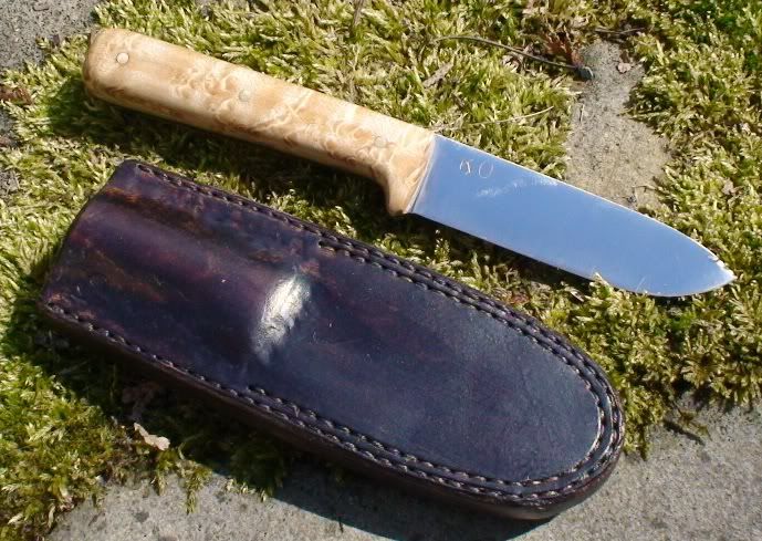

Here's some pictures I took yesterday of the first Kephart I made.
My goal was to follow the original "Kephart Sheath Knife" design as much as possible, but couldn't resist changing it a little, hopefully for the better.
The guard area on mine is a bit smaller to allow for the grip to be closer to the edge. I used 1/8" CPM154; I have the feeling Kephart's blade was thinner
, and it wasn't stainless :foot:... Also, mine has a convex blade with a tiny "v" edge (original seems flat grind, from the picture). The handle is stabilized birdseye maple, and the pin placement is a little different.

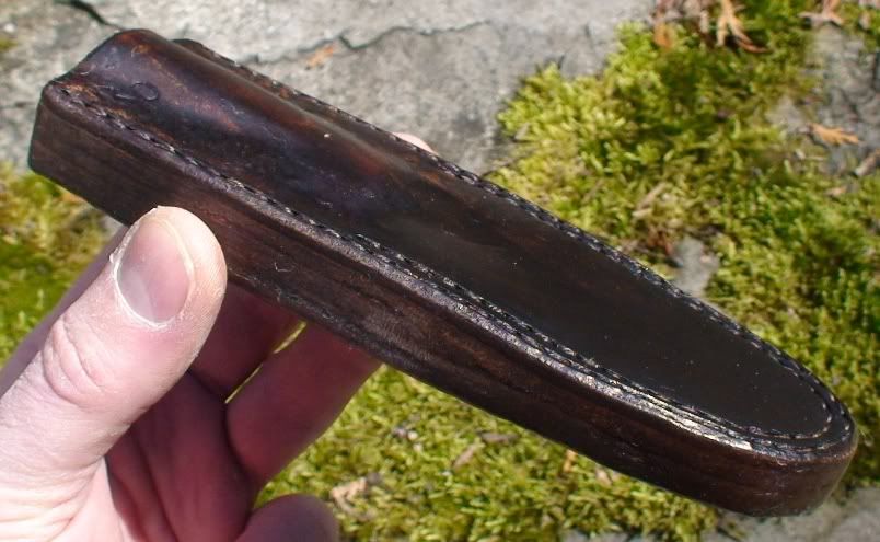

I tried to make a leather sheath but failed miserably...still debating on the sheath style - either pouch style or more like the original.
Picture from www.wcu.edu/library/digitalcoll/kephart (sorry if you saw this picture a million times
As usual, critiques are not only welcomed but encouraged!
