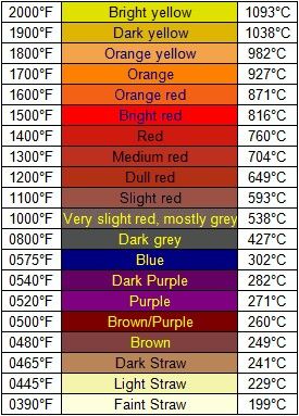

Based on the above post, and several comments that you have made in other threads, I think you are severely over thinking this whole process. All of this melting salt, fumbling tools, blower not being enough stuff.... Simplify it. First off, melting salt doesn't tell you anything except for the fact your fire is AT LEAST hot enough to melt salt. Nothing about how much hotter than that it could possibly be. A magnet is a much easier, less messy way of telling if your steel is up to temp.
Let's simplify this as much as possible. You need to heat the steel to non-magnetic then just a shade or two more, then quench it quickly. The quench needs to be fairly quick, but not so fast that you should be dropping tools, or dangerously handling the steel. Have your quenchant of choice close to your forge so you don't have to make any extra movements to get it there, and you should be able to do so plenty fast. If you are concerned about the process or think you won't get it done properly, practice with some scrap steel. If you want, you can take a billet of steel, practice annealing, normalizing, hardening, tempering etc etc etc with that. That's the great thing about steel, you can work it over and over and over... Then go to work on the blank you have spent so much time cutting out...
Look, humans have been working steel for ages. Long before there were thermocouples, or really any other way to accurately gauge temperature. They did it by color, and experience. If you are going to insist on knowing the exact temperature of things, and have to make it as scientific as possible, then go get a quality thermocouple and display or multi-meter that will read temps to at least 2000f. There are infrared thermometers that read that high as well, but they are rather pricey. Keep a magnet near your forge, and pull the steel to check it against the magnet. You should be checking it for evenness of color at the same time. Simple...
In my time I have studied literature, music, history, physics, biology, chemistry, mathematics, etc etc etc, hold advanced degrees, and I consider myself a fairly smart guy. I too was insistent on over analyzing the process and needing to know the specifics when I first started. It took simplifying this to its basics for it to click. I posted this chart next to my forge... It isn't perfect, and none of them are, but it at least gives you an idea of the gradient.

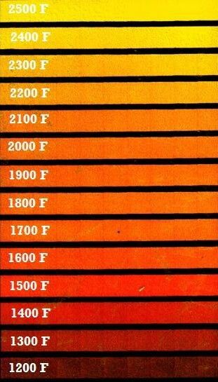

Here is one that even has the lower oxidation colors on it. And as you can see, there is some variation between the two charts. This is where you the magnet, scrap steel, and developing your eye comes into play...

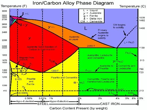

And if you absolutely need a visual way to understand the science of what is going on... Here, this is also posted in my shop...
I can tell you are eager to learn all this, and eager to share some knowledge. But, do yourself a favor and slow down, break it down to the basics, and develop your craft. Traditional education dictates that a foundation of knowledge be laid, and built from. This is the foundation you need to learn if you choose to keep doing the hot-work for yourself. There is no getting around the 'feel' and 'eye' that need to be developed even if the science is committed to memory.
