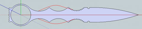

Since I just wanted a dull version as a trainer I went ahead and remade the blade with a few changes in autocad and had a local waterjet company cut me one out of 6160 aluminum.

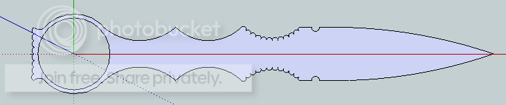

And since I promised - here's my reproduction of a knife that I wanted as a trainer so I could take a class with it - the production one should be out soon (again) and I'll be purchasing it.
Welcome to Bladeforums! Pretty cool design. Only thing I see is, do you really need an ambidextrous handle? It might be more comfortable with the finger grooves only on one side and then offset the little finger hole. I am a newbie so I can't really offer any advise for making it, but I can tell you that Home Depot etc. does not sell anything close to knife steel. I think their stuff is most likely 1018 mild steel. 1075, 1080, or 1084 are good steels and easy to work, and cheap. Fastenal, or similar stores may have some O1 tool steel or A2 or something similar.
-Xander
Why the symmetrical finger grooved handle?
Those points are going to dig into your palm and cause discomfort.
I designed it that way basically copying the design of the original knife which is currently not produced.
It's a self defense application tool - that's all I'd be using it for. The symmetry was so that as long as you got your grip the orientation would be the same weather you were hammer/pikal grip on either side.
I had considered making it just a palm swell of sorts - but I figured I'd make my trainer as close to the real thing as possible.

[Rant] I think you just got a lesson! Get rid of those finger grooves and go with the palm swell!!! If your smart you will listen to us, what are we? (hint...knife makers!) GASP! :eek: that means we know how to make a weapon/tool that wont turn your palm into hamburger! There's a reason that isnt produced anymore! Also dont come looking for advice if your not going to take it! just post "Come look and praise me on my great SD knife that does as much damage to the user as the perp! Holy crap! Where's the Tylenol! [/Rant]

Just for the record, I don't know that I've seen a worse "self-defense" knife design. If that thing was ever in production, it was marketed towards mall ninjas!
That knife design is most definitely not a 'self defense application tool'. Self defense starts with a solid foundation of logic and reason, not mean-looking cutlery. There is nothing about that design that makes it better for fighting than any hundred other blades on the market. What do the professional fighters use on the battlefront every day? Do their knives look like this? Is there a reason for that? What's on the local SWAT team's belts? Why is that?
People that really do have their lives on the line have a long history of trial and error, and they've come up with some pretty good solutions to everyday problems that you or I might have missed. Does the guy carry a small fixed-blade because it looks cool or because it's been proven to accomplish the widest array of tasks, including killing people?
The grip is all wrong for a comfortable day of practice sparring and will quickly chew your hand up. The points should go towards the bad guy, not your palm.
The circle on the end is for what? Opening beers? I'm cool with that, but the whole kerambit idea is outdated, at best, and is asking for a broken finger. While weapon retention is a good idea, sometimes being able to get shed of said weapon is also a good idea. The kerambit design traps your finger/thumb in a lock that could very easily break said limb if the bad guy has the luck or skills.
My thoughts? Less focus on the fantastic and more on the practical. More people have been killed with Kabars and prison shivs than any mystical Klingon apparatus.

Back on topic, I agree with most about the handle...and I too like the kerambit design but that hole looks massive. A tad too big in my opinion.

We're just trying to save you the time it takes between now and when you're looking at blisters on your palm in the shape of that grip and going "damn, no wonder they quit making that."

Whether or not you plan on using the advice offered here is entirely up to you. I'll echo what many have said here that there is no way that knife can feel good in your hand. Now you're saying you had one already water jet for you. If you honestly feel that wrapping your hand around that is comfortable then by all means go for it and good luck. Making a dagger style knife on your first run will likely end in a fair amount of frustration anyway. Keeping everything symmetrical is a challenge for people who have quite a few knives under their belt. There are makers here who have been at it for years who haven't even attempted a dagger blade.
You appear very interested in learning but look at it from a different perspective. You're looking for someone to help you make knives. You have plenty of people here willing to offer you advice and help you through every step of the way if need be. But have you ever tried to help someone who is very new to something and then have them reply "Well that's not the way I want to do it" Or something to that effect? It's very hard to give advice to someone who plans on doing their own thing anyway.
The advice offered here about the design is all very valid, again you can take it or leave it. But bear in mind when you combine the knowledge of the people you're asking on here you talking about hundreds of years worth and a lot of the guys on here do this for a living. Many of which are more than willing to give you step by step advice if you need/want it. All you'd need to do is take pics of your progress and ask how to go about the next step and more than likely you'll get it here. However, again, people aren't going to bother taking their time to offer you advice on how they would do it (again after having done this numerous times) only to have someone totally ignore them.
Either way, good luck in your journey and welcome to BF. Hope we can be of help.
If it were me and wanted to stick with a similar design I would go something like this. And again keep in mind this is a 2 second mock up in paint not a CAD design. Regardless I don't see how even that is comfortable in a hammer grip. What purpose does the hole in the butt serve in a hammer grip? Which finger goes in the hole? I almost get the impression it wants to be some kind of karambit but putting your index finger in there would be so awkward because your hand wouldn't fit naturally around the rest of the knife.
