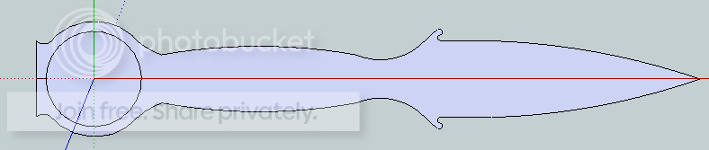

I've got a version made up that removes the finger grooves - I'll post a pic of the drawing during lunch today.

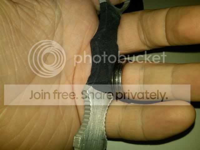

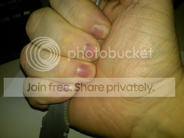

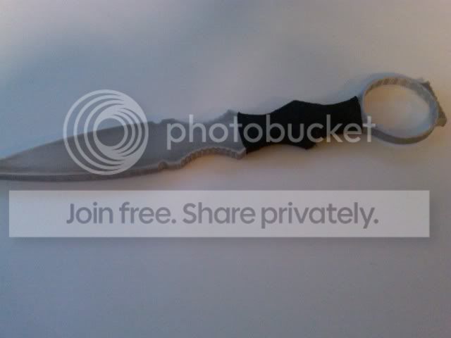

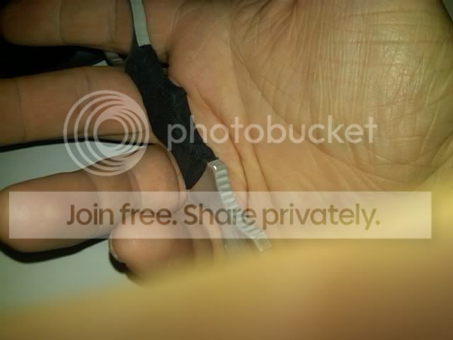

As promised - these were done with my blackberry, so forgive the quality.
The slight pinch I got on my right hand ring finger:
For inside the palm the groove points don't hurt at all, when I punched a wall bag while holding the knife I didn't feel any discomfort. Maybe when they're filed down toa more rounded shape they wont pinch the fingers.

Anyways... Here's a revised handle:
I made the inner ring opening smaller as well - haven't changed the outer part because I haven't decided exactly what to do there, I though I might see how offsetting the ring a bit does as well.
