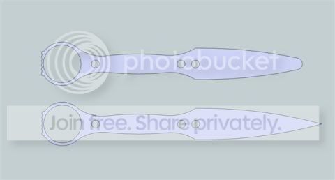

My first knife (design pics...questions)
K, not trying to be an ass, but rather share experience. You're in the R&D phase now, and that's basically re-inventing the wheel that dozens of makers have gone through over the years. There really isn't anything "new" in the knife world.
Logically, there is no reason for a spiky handle. If it was a good idea, you'd see it on a lot more hard-use knives. With the swell of the ring and the rear portion of the blade, you're hand is trapped fairly well. With a palm swell instead of the spikes, you have a comfortable grip that's resistant to slipping.
What the spikes give you, though, is a "cool" look. It's different and looks mean, but they weren't very popular with the buyers or they would still be offered.
You're learning, and that's good.

That was something I was considering (not neoprene, but scales of some sort). Considered goign down to 1/8" thickness rather than 3/16 and doing some thin scales.
I'm still slightly redesigning the profile, but thanks for posting that - I'll draw some scales up while I'm at it too.
So it changed slightly and here's what the jet cutter is making up for me next week. I took it to a knife seminar as well and went over the design with several people who make a living off training with blades - got some good input from there as well
Trainer version on top, actual knife design on bottom.
I've got a knife maker doing the grinds/HT for me as well, though I may have an extra one made up and try my own hand at doing the bevels myself.
