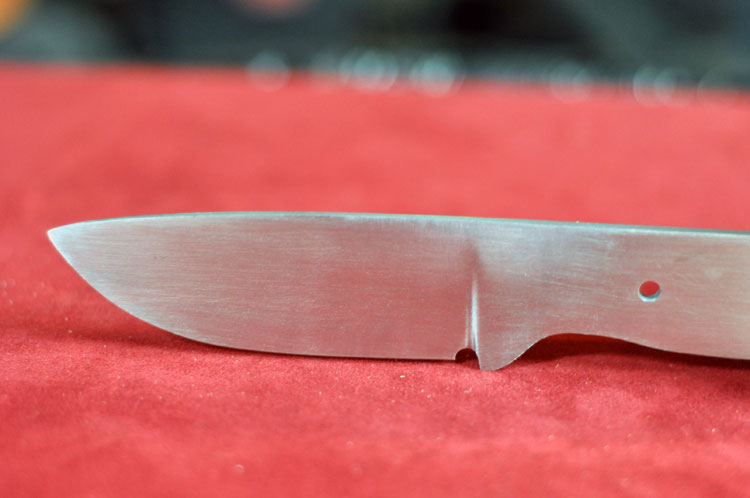

I spent some time (an eternity) draw filing and sanding and finally got the grooves out of the top of the spine from the wreckage I call my plunge lines. I did use the chain saw file and tried to do as I learned in the video. It made things better.

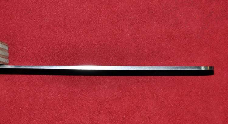

In doing the draw filing, the ricaso and blade are noticeably thinner than the rest of the tang of the knife. I took a few photos of where I had to stop today. I have used almost all of a pack of 100 grit sandpaper and am about finished with a pack of 150 grit sandpaper for one side of the blade. (my grooves run deep!)
My real question for today is, should I try to get the rest of the tang as thin as the ricaso area? I don't have calipers at this point. I did attempt a photo of the two points for reference.

Hmmmmm. This is a tough one. Your plunges are looking pretty good. As far as the tang being thicker now, you can proceed in a couple of ways. If you are obsessive and possess a touch of OCD then you will have to make the tang thinner to match the ricasso. If that is the option you choose, here is what I might do if it were MY project. With the limited tools you have to work with I'd try to get as much work done with the RA sander as possible. But here is how I'd go about it. You want the tang to be flat and even when you're done sanding it. If you just clamp the blade in a vise and attack it with the sander you will get very uneven results with rounded edges. I would use carpet tape which is double sided very strong adhesive and stick the knife down to something solid and flat. Butting up on each side of the tang I would stick down scrap bars of the same steel you're using for your knife in the same thickness. This will keep the sander from rolling over the edges. Use the sander as flat as you can and keep it moving it controlled passes down the tang. Don't press too hard with the sander or it will press into the gaps and soften your edges. Use light pressure and let the sander do the work. Don't run over the ricasso. Do the same number of passes on each side. Stop before the tang gets as thin as the ricasso. You are just trying to remove excess material quickly. Then I'd use double stick tape or spray adhesive to mount sheets of sandpaper to a granite surface plate or large flat marble tile or thick piece of glass. Do your fine sanding on that plate to flatten everything out and make your thicknesses match.
The other option to consider is just to blend the ricasso into the tang under the handle on a flat surface like a thick piece of glass. I don't think you need to worry about the different thicknesses as long as your handle material has a flat mating surface. That way you won't have gaps showing after glue-up. You can aspire to perfection which is a good thing. But be realistic about your circumstances. You have limited supplies and experience. When you are new to this the main take away is the lessons you learn not the knife.

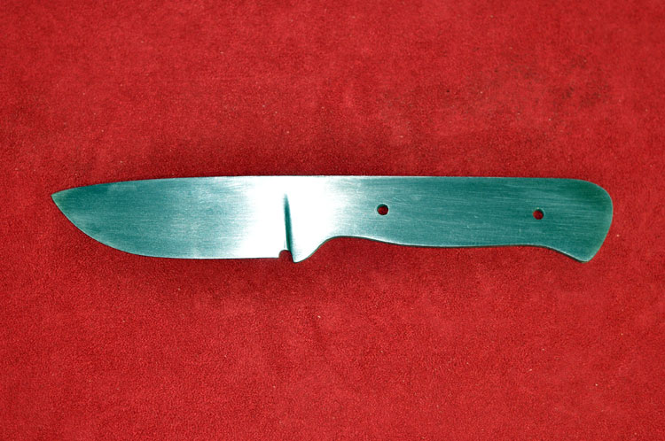

I have done about all the corrective work that I think I care to on this blade. I did take your advise and take just a small amount of thickness off the tang. Anal and OCD only hint at the level of perfection that I would typically live with. At this point, I feel as if I am playing golf with lawn tools and just keep hitting the ball back and forth over the green.
I am not really happy with any aspect of this "blade", but I do realize it is a first attempt with hand tools. My real question at the moment is, what grit sandpaper is appropriate prior to heat treating this - given the state of things.
From the ricaso to the tip, I have used 150 grit. I initially went lengthwise, then did a round from spine to edge. Mostly to get out the lines left when I used the chainsaw file to fix the plunge lines & grooves. I tried to do as Nick Wheeler said and not change any direction until no lines could be seen of the prior direction. Lastly I sanded again lengthwise. This time I also hit the tang, just to have everything flowing the same direction.
Should I move up to 220 grit before HT? Do more sanding at 150? I know the plunges will never look right on this project, but I don't want to leave it too half done either.

I don't mind your newbie questions and I don't think anyone else does either. That is the circle of life around here. We were all newbs once and we asked most of the same questions you are asking. We learn and gain wisdom and experience then we pass it along to those who come up behind us. They in turn pay it forward to those coming up behind them. You will be helping others in no time.
Some people may advise going a bit higher with the grits before HT, maybe 220-320ish. I think this has a lot to do with it being easier to remove metal pre HT then after the blade is hardened. The more finished you can get it now the better. But realistically you are going to have to grind again after HT anyway. I usually stop at 100x before HT. It's a lot more work after HT but this is MY way. Your blade looks very good now. I know you don't like the way it looks at the moment. Keep in mind, there is a lot more meat on a knife than you think. There is plenty of material on that blade to correct thicknesses, true up plunge lines, make transition lines crisp, change the profile, etc. The fact that some of your edges are soft is probably a good thing because it will cause less stress on the blade during HT. Heat treat the blade the way it is now. You should be fine. Then after the blade is heat treated and tempered you can do all your clean up including making your plunge lines crisp. Don't worry about the different thickness of the tang. Just make sure the surface around the edges is smooth and transitions well with the ricasso. You can even hollow out a pocket in the tang to hold more epoxy. Just stay away from the edges. When you glue up your handle slabs and clamp them, they should follow the contour of the tang and give you a seamless joint. You're doing fine. This will be a very nice knife.

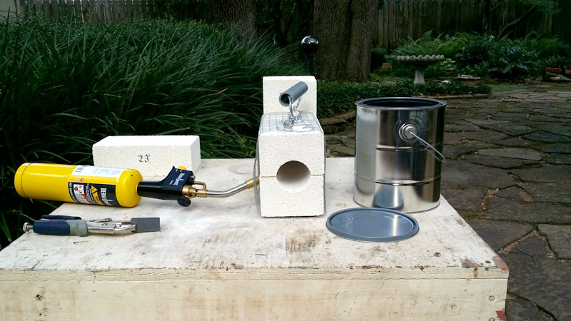

I now have to build my first "forge. I have 4 soft fire bricks and a large propane tank with a hose. I need to get a proper nozzle / torch tip for it. I am again using Aaron Gough's video on a small 2 brick forge for this. Will probably quench in vegetable oil.

As always, thanks for the insight.. Here is a quick shot of my makeshift mini forge. It worked like a charm.
