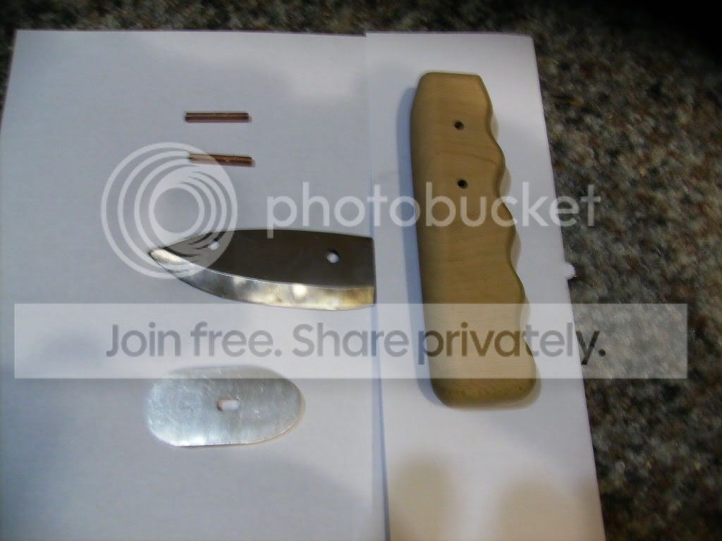

well i did that i drilled the first hole then placed a pin in while i drilled the second hole . my problem was i needed a finger gaurd so i found some aluminum slab drilled it shaped it nice then had to accomidate the thickness of the gaurd so i had to sand the end of the handle an 1/8 of an inch so the pins would line up and i didnt check both pins at the smae time with the finger gaurd on so when i went to put the second pin in whenb it was full of epoxcy so then i tapped the pin and it was making contact with the maple and snapped on my third hit. oh well . the handle was really really nice but not now lol

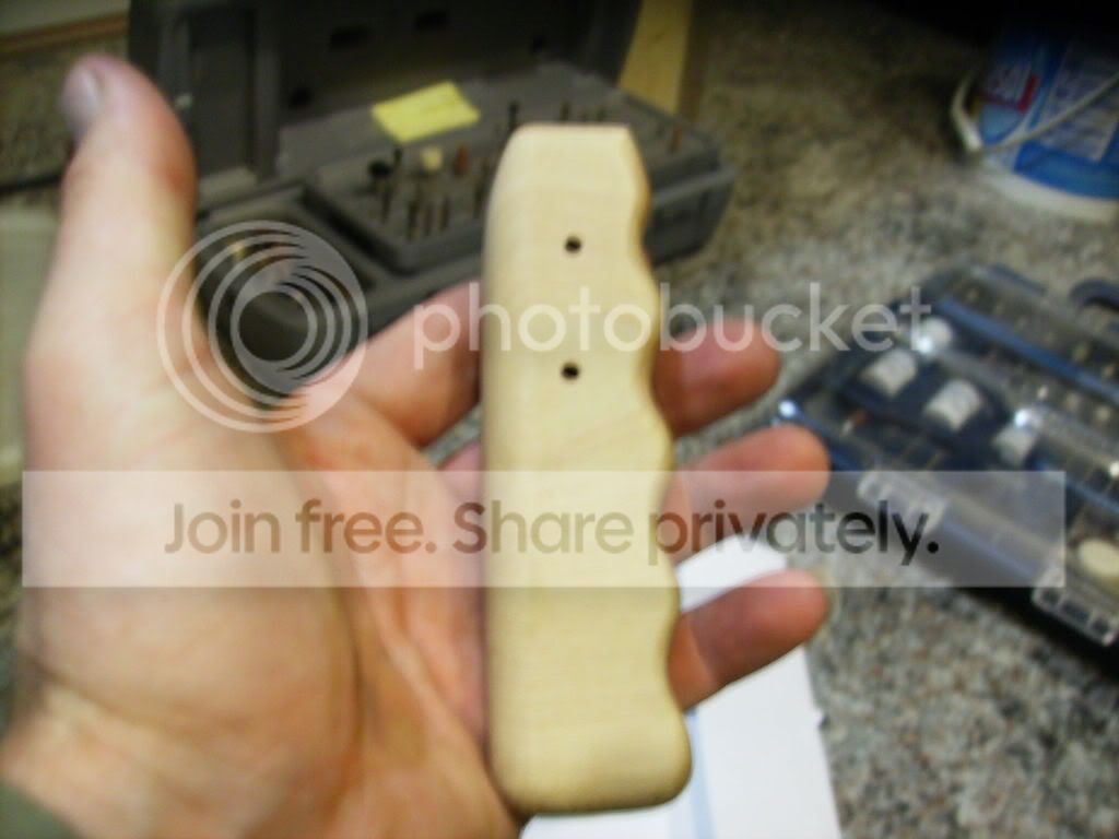

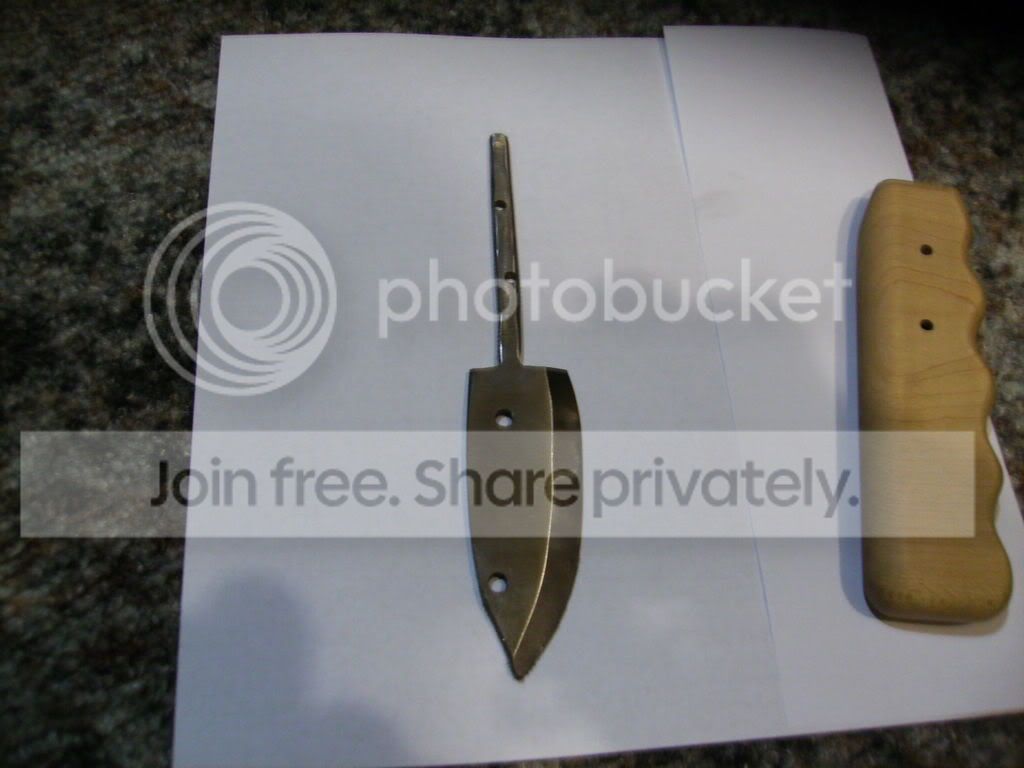

the handle was drilled blind with the help of calipers and a lazer drill press it was a solid block with finger groves ill show it just a min i have stages in the making ill show pretty much just befor i broke it. i had it sanded down to 400 grit polished the blade some and was sharp
here it is bfore i broke it
