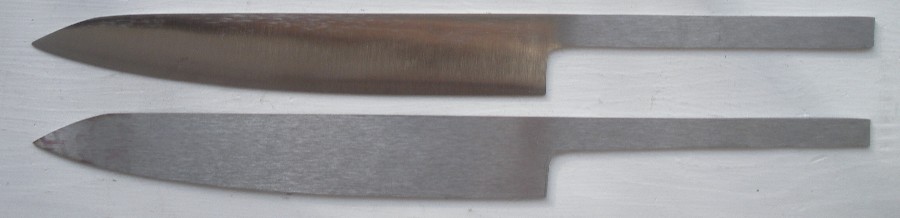

Things are going pretty well so far. I have two blanks cut, and I've spent two hours (and two belts) getting one of the blanks down to what I think is about a .015 edge on full flat grind. Taking it real slow and easy, doing a dip after each pass, and matching the passes one for one. No obvious gouges to work out, so I'll probably switch to hand sanding on that one so I can slow it down even more. On the whole I'm pleased. Feels good to be back at it again.
The two blanks cut from the bar stock.
One off its two hour grind session.
Since then I have started the hand sanding and have drilled the pin hole in each of the blanks.
Today, after opening the gifts, I spent some time at the grinder pulling the second blade through that step. By comparison with the first, it shows more problems at this stage, so it will take more work during the hand sanding stage. I don't think either blade has any irreparable problems, though, so I should end up with two usable blades.

Both blades have been hand sanded to 180 grit, and I believe both remain viable.
Blade B had a lot more gouges to work out than blade A, but I think I got them without compromising the blade. They weren't that deep.

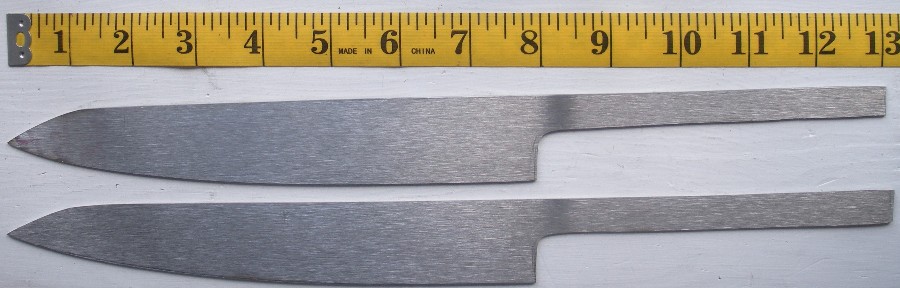

Update: I noticed that the profile of these blades would more accurately be described as slicers, not chefs knives. I informed the recipient of my error, and he admitted that he erred as well. His favorite knife is really a 6 inch chef's knife.
So obviously I'll need to start over again as far as he's concerned. As far as I'm concerned I'll finish these first. Also, I checked on Aldo's site and it seems they are out of CPM S35VN. So for now I'm stuck with what I have anyway.

This morning I spent some time sanding the blades a bit more, using a technique passed on by Nick, sanding at different directions with each change of grit. Good thing, too. I found a number of small but annoying scratches that needed to be removed. They would have stayed invisible for far too long if I was always sanding in the same direction. Now they are gone and I am realistically up to 280 grit on one, still at 180 on the other. I've also shifted from dry sanding to wet.
Looking good so far. When you think you have eliminated all the sand scratches.......... carry it out into the sunshine and view it from all angles. You will usually find something that needs a little more work.

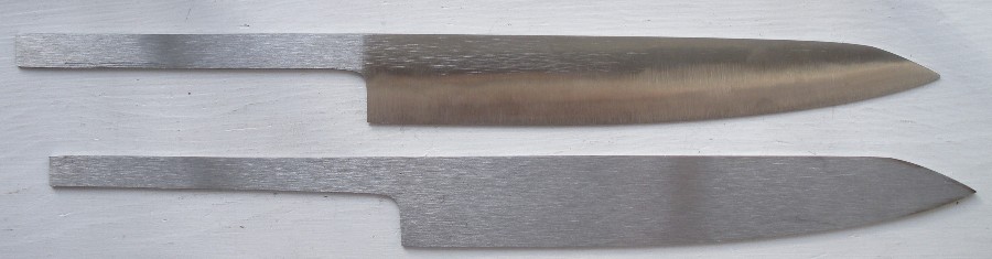

I decided to take a different look at the blades before getting too deep into preparations for HT. I intentionally ground the second blade more than I did the first, thinking that if I went too far on one at least I'd have the other to fall back on. In looking at the angles now, I'm concerned that I might have left the first one too thick.
By eyeballing, I'd estimate the B blade is about half the thickness at the edge of the A blade. I have a micrometer around somewhere, but I never got the hang of accurately measuring thickness on beveled edges, so I haven't really measured either one. That said, I believe the A blade to be about a quarter the thickness at the edge compared to the spine. I'd estimate the B blade edge thickness to be about half that.
Here's the A blade.
This is the B Blade.
