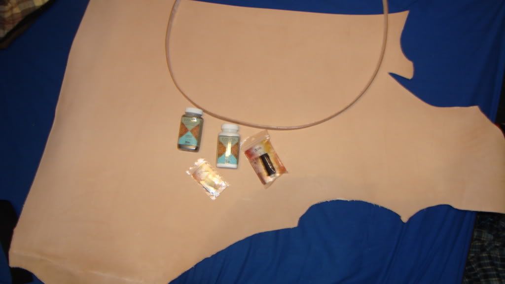

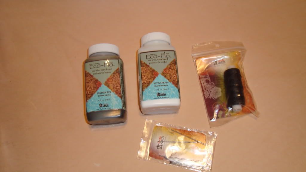

Well I just got home from picking up the last few things I needed to finish my knife up, most of the things I need to make my sheath. After much searching I finally realized that we have a tandy factory here so I picked up a single 6.1 squarefoot veg tanned shoulder 4/5oz, some black waxed thread, a bottle of timber brown dye, and a bottle of satin sheen. i also grabbed some needles and a belt blank.
I plan on wet forming the sheath, and just dying it with no fancy pattern work. I will be making my own awl to poke the leather from a broom handle ans a sharpened spoke. the one thing I forgot to pick up is a stitch marker so I will be making another trip to tandy on saturday. the belt blank will be shaved down to make the retention strap and possibly the belt loops, I am unsure of that one though. So by the end of next week I should be done this WIP.
Any advice on making a sheath would be helpful and maybe save me some leather.:o
Nice job on your knife, unky. 4/5 oz leather is a bit on the light side, but I guess it will get you started. 6/7 oz or a bit heavier would be better. If you are able, I suggest returning that EcoFlo dye and buying some Fiebings on your return visit. I started out with that stuff, and had nothing but problems with it. If you do some searching around, you will find that most people have not had much luck with it either.
I think there are some free tutorials online, but I suggest buying Chuck Burrows/Wild Rose Trading sheathmaking DVD.
Good luck.

I think I will stick with what i have for now, I went with the lighter leather just because the gave me a gold membership deal on it, it is almost flawless too, I can only see 4 little marks on it nothing bigger than 1/8" round and all out near the edge. The knife is fairly thick as well so heavier leather would make for an extremely bulky sheath.
