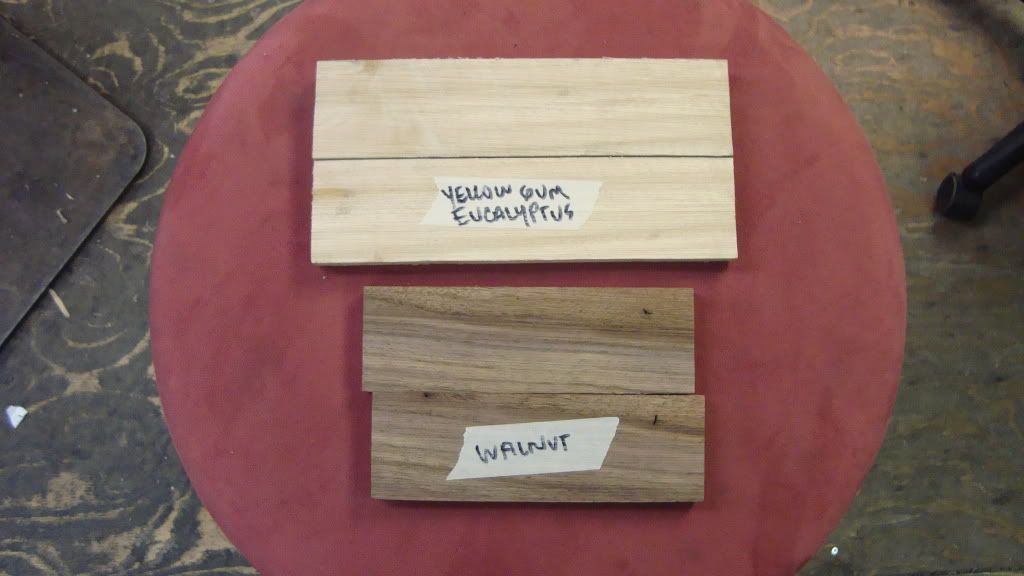

Well I got some wood from Burl Source today, I had scales cut and ready to attatch tomorrow, but I have to use some of this new wood, it is absolutely beautiful, and Iwant him to see the wood in use before I have to take a break to heal I wil post pictures of the wood tomorrow.
Well I took the pictures but forgot the cable for the camera at home, think I will go with the walnut on this knife

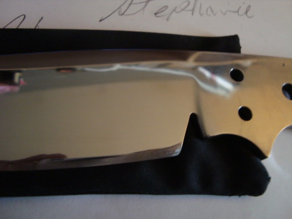

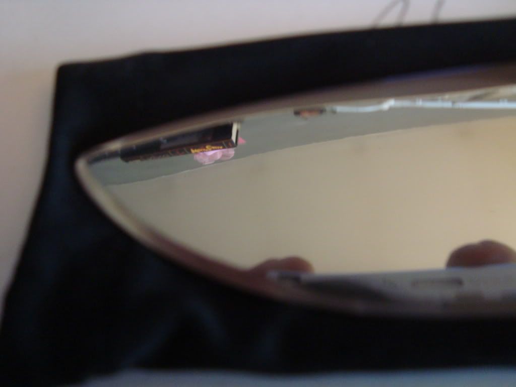

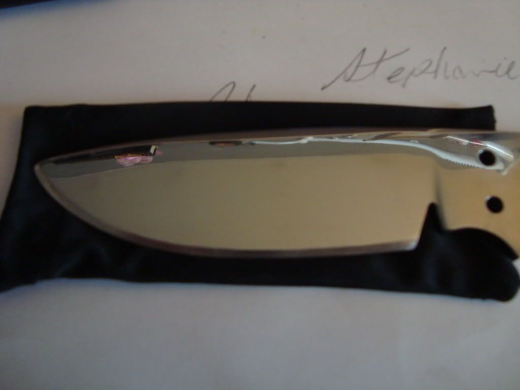

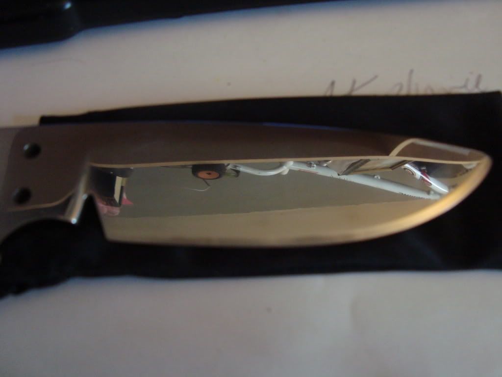

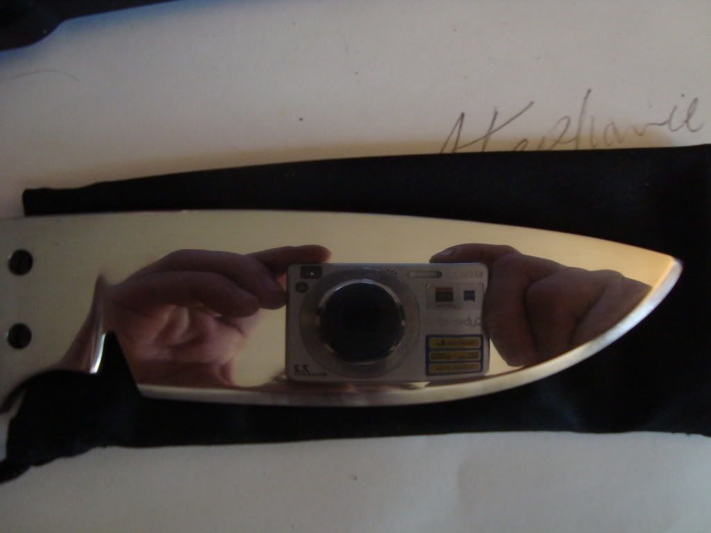

Well, after a number of tries to get the finish I want on my knife I feel I have to move on and get it finished as is. Here it is before adding the scales.
I can still see the scratches, but just can't seem to get them to go away :(
I will be using the Walnut I got from Burl Source on it

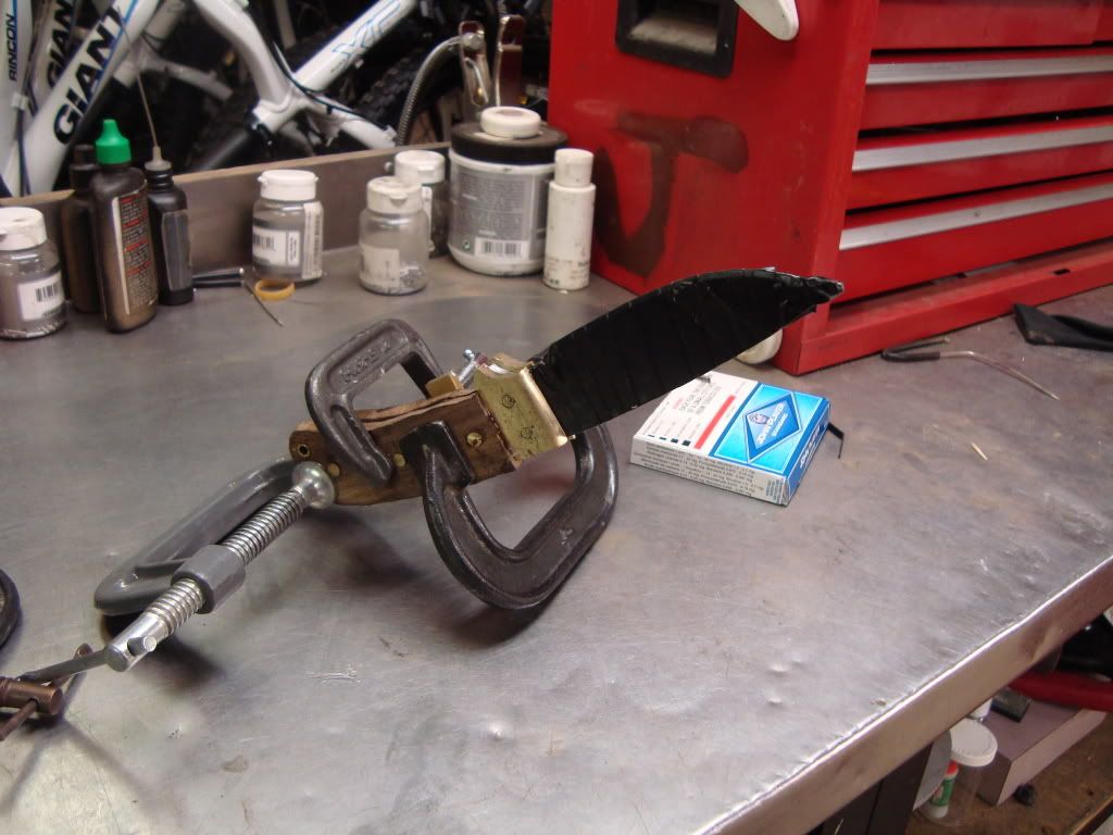

Well I have the scales attached and some what shaped, and just as I feared I managed to bugger up things while doing it
  1. I managed to get the scales and bolsters not square, tops are even but well out at the bottom
  2. I put a nice dimple in the one bolster,I have been sanding by hand for sme time now and its still there
  3. I have a gap between one bolster and scale
  4. One of the bolster pins is still visible at this time
  5. I managed to sand into the edge of the spine just in front of the bolster
  6. And I have some heavy scratching to clean up on the finger choils
I have a lot of finishing work to do to come back to close to acceptable and hide my mistakes. Over all the knife feels good in my hand, it is by no means a light weight knife so if I ever drop it I will know it just from the sudden lose of weight.
Enough with the talking heres the pictures today
finally a picture that you can see the little scratches I have been complaining about
Here you can see the lower bolster does not extend as far as the upper
and the little nicks I put into the spine while sanding, I didn't notice that the duct tape had worn through:o
the handle tappers nicely front to back when looked at from the top or bottom, but I should have thickened it just a shade more up and down and maybe made it a 1/4 longer. Lessons learned for the next time around. Right now the balance point is right at the point in the bolster so even though its a heavy knife it doesn't feel that way in the hand
