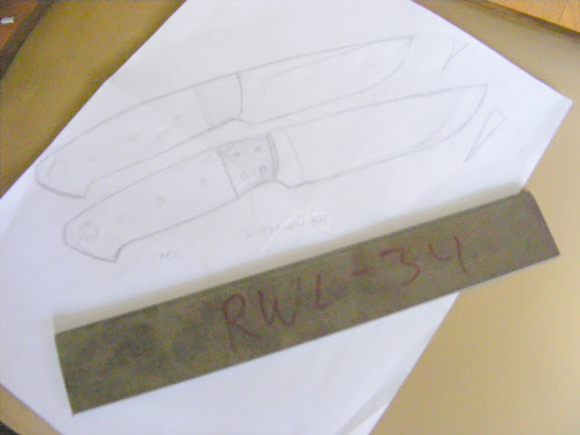

I finally got a piece ot RWL34. 4mm thick, 250 long, 38mm wide.
I have an intention to make a outdoor knife. Something like middle sized bushcraft-camping allrownd tool. 12-13cm blade and the handle will be from wood and buffalo horn bolster, or just wood.

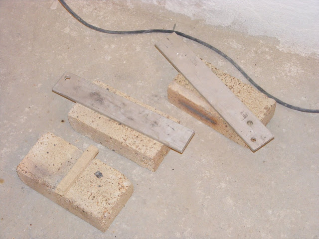

So, you recommend me a 30 min soak time. :thumbup: But there is a problem with the foil now. I have an intention to cover the blade with high temperature clay for heat treating, and perform interrupted oil quench for two seconds. Right after that I will use the plates to avoid bending. I have two pieces of aluminium, I hope that works.

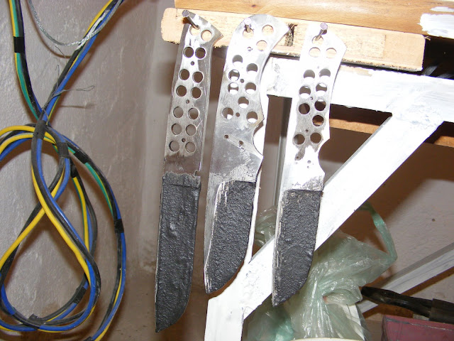

This is how I cover my blades with the clay. Will it works, or I will have to cover it all the way?
At those high temperatures oxidation and decarburization occur rapidly so cover the whole blade to save yourself a lot of work !

The clay may not work good for HT these kind of steels. You have to soak long. If you have a temp. controlled kiln don't be shy to let it soak above 30 mins. 40 - 60 min is good... But the clay will have some cracks, and these cracks will cause you too much trouble. If you have HT foil use it without a doubt... Also to clay coat only a part of the knife is not a way to go. You will have deep decarb + oxidation layers on unprotected places. Those will be very hard to get rid of...
The Al plates you posted are not big enough as far as I see. You need 2 - 3 cm thick, at least 40 x 20 cm plates. Don't bother with oil quench, I tried and it doens't do any good, instead warpage issues are PITA. Also to polish the surfaces of plates helps a lot. Steel cools much faster if the Al plates contacts better to the foil...

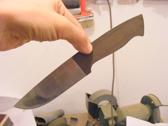

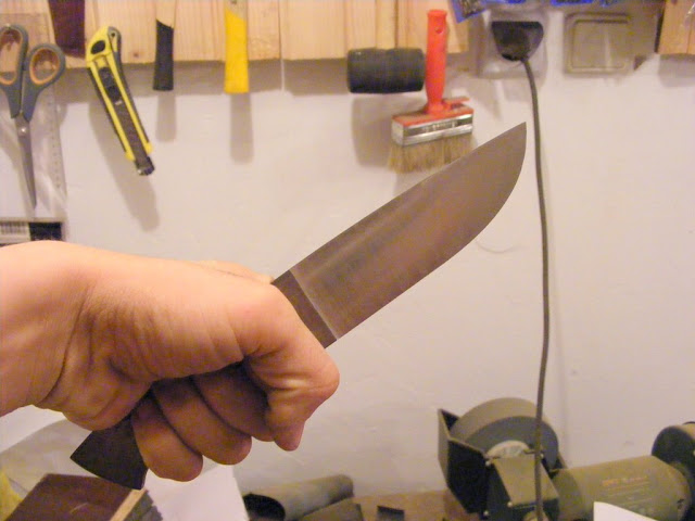

Flat ground to the back. Here I must say about my satisfaction from Norton 60 grit ceramic hogger belts. Only 20 mins to rough grind the bevels on slow speed, and this was not a fresh belt! Atleast 4 knives of 1.4116 stainless steel was rough grond on it before that one. After that I touched with 100grit blue zirc belt and Norax X100. RWL34 is the most grindable steel I have ever used. It is a dream.

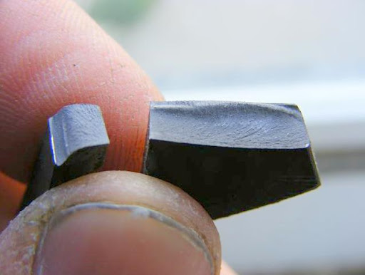

Now those are the excess pieces after HT. 15 min on 800C and than 40 min on 1050 and oil quench. They were protected with clay. After that 2 hrs on 220C. Is that supposed to be the look of the broken steel RWL34?
looks very good, one time I have learned how grain growth would be (by mistake of course) when this happens crystals are easily visible, as far as I can see it is not happened on your sample. And also I have broke lots of HT'ed RWL34 and inspected. First, when it is fully hard it is lot easy to break (like most of the steels) and the edges are very sharp. Also it is a good indication that there is a concave inner section is broke. When it is as hard as it can get it breaks mostly that way (like obsidian flakes). Also you might polish a side of it and spray salty water over it. After a day it should not develop any patina at all. This way you can be sure the chromium also diffused well and it has become stainless...
Great, Emre. Thanks for the tips. It is good to know that I am on the right path. I will make the stainless test with salty water. Small piece I broke before tempering, and big - after that. It is realy brittle right after quench. It snaped like glass. After temper I had to use double and up force to brake it.
