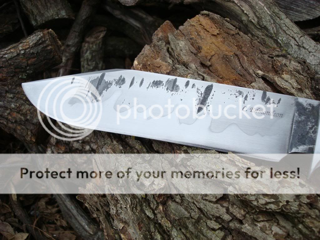

Heres the hamon after tempering and hand sanding to 400, shes really danced around on this one, Im filing the guard right now, gonna get some more pictures this afternoon

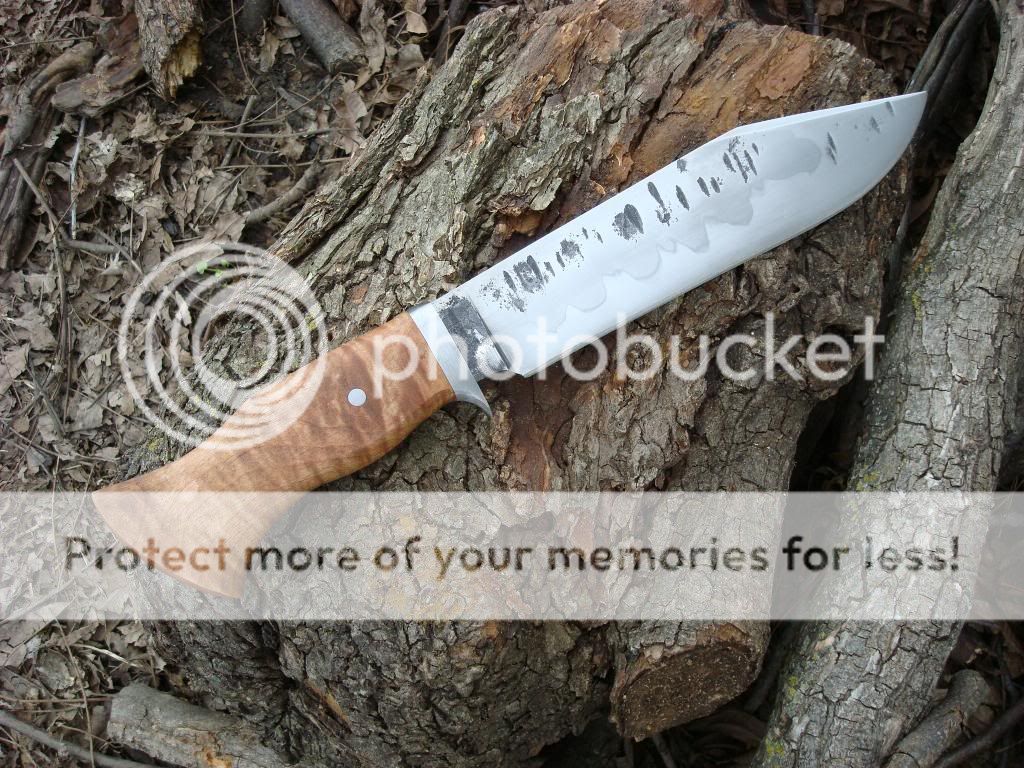

Got this one on Friday and just had a brief chance to take a few photos. I haven't had much of a chance to give this one a review or work-out but hopefully that will follow.

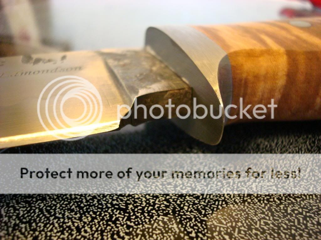

For a knife this size this one is surprisingly 'light' feeling and has a good balance. The handle is a bit large, but it feels good in the hand and I'll know more about how well it works for me after I get a chance to put this one to some use. The only thing I would change on this one is that the guard is pretty sharp where the finger rests right before the choil area. I can fix that and actually ran my diamond hone around it a bit to make sure it was dull and wouldn't scrape or cut my finger.
And now for the part we all like... some pics. Hopefully I was able to capture the fantastic hamon on this one.

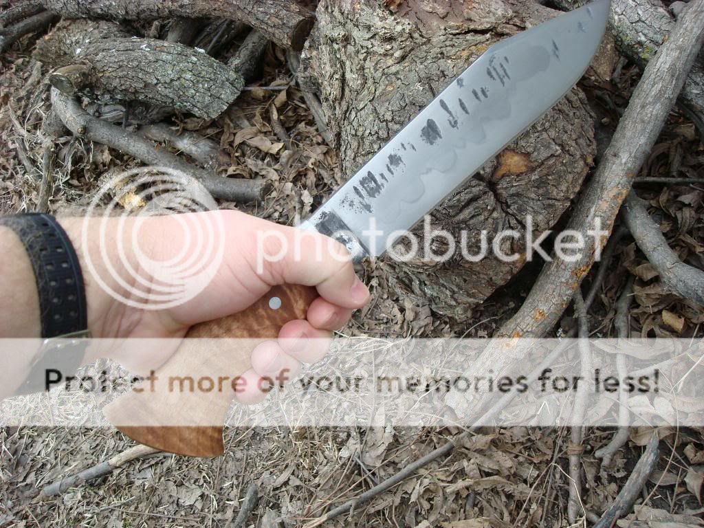

Here's an in-hand shot. I wear a Large to X-Large glove for size reference
Here is the area around the guard I had mentioned. This is after spending 10 or so minutes rubbing this down w/ a diamond hone... I'll do a bit more refining later...
