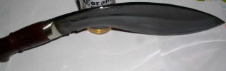

So there I was, bored and not lovin' my Foxy Folly anymore. I had been really hard on her and she hit the rocks a few times when I was clearing the acre of small trees, so she wasn't looking too good. I had nothing better to do so I started working on the blade and getting rid of the nicks and scrapes. After a while I decided, what the heck, let's blue her.
So I knocked down the shine a bit with a 180 grit sandpaper and dremeled down the back of grip cause it was biting into the palm of hand and cleaned her up before blueing. I think it turned out alright and I'm liking her again. The color is a very deep blue, the pics look almost black cause it's night here and there's very little natural light. Well, here are the pics:

I'd like to see it with more light. You sure must have cleaned her up- looks smooth and clean lined.

I'll take some more pics tomorrow when it's sunny outside, right now it looks really dark in the pictures. Really didn't clean her up much, just knocked down the shine a little.
I think you've got enough light in the pics (notice other objects are properly exposed). If you tip the blade back away from the camera slightly until the light falls onto the blade (reflects some light toward us) it would open up the shadows. Bright direct sun will not usually give good results.

Here's some more pics I just took. The bluing was worn a little where I stuck it in the stump, but she's no showpiece so I expect her to get some character. Rounding off the back of the grip has really helped in swinging it, it no longer bites me.
Munk, I did have to take a dremel to the blade, I forgot to mention that. The nicks were to profound to steel out and my file did little more than scratch my blade. Next time I won't swing so low to the ground.
As you can see it's not perfect, there are some character flaws in the bluing, but that's okay with me. I used Birchwood casey permablue paste and found that putting it on a papertowel and then spreading it on the blade worked best.

Beautiful blade and very good pics outside! :thumbup:
What a gorgeous shape the foxy has.
