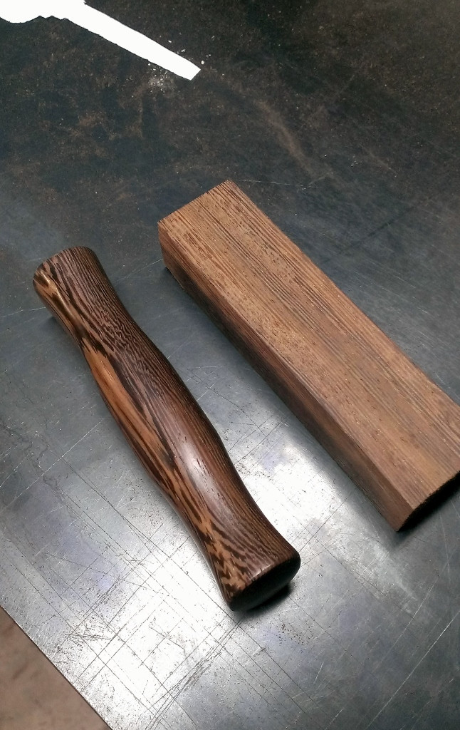

I had some wenge left over from a project, and it was enough for two nice sized handle blanks. I plan on making WIP knife #2 with some Black Limba and Macassar Ebony I have on hand. I may try to sneak a scrap or two of birdseye maple on, but not sure yet. I think I'm gonna do a brass bolster, but I might do S.S., just can't decide. I have some 416 pin stock already, so maybe I should just go with that for the bolster.
I basically took the handle blank to my 6x48 belt sander and went to town freehand, removing a bit here and a bit there until I felt like the shape had some promise. Then I moved to the bench and imitation pana-vise for a couple hours of hand sanding. It's kinda funny, just built this fancy new 2x72 grinder and didn't even touch it yet. Definitely not gonna tell the wife that. "Yep, couldn't have done it without this new grinder I built, honey." :D

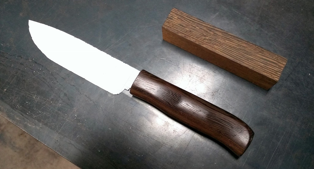

I know you are eager to get started, but you should fit the handle to the blade, not the other way around.
Rushing to "get them out" and hurrying to "get them done" will only lead to half-way quality knives. Take the time to do each step fully, and go over each step until you are sure it is right before moving on to the next one. When someone asks how long it takes me to make a knife, I often answer, "It takes as long as it takes."

I'm only eager because I've been prepping for about a month now to start these knives. I'm excited to finally be working on something in my shop. I'm looking at switching to knifemaking for my hobby, since I am having trouble with larger pieces these days. I'm pretty OCD, so even when I'm rushing my OCD takes over and won't let me overlook small details. My fiancé asked me last night, "How long will it take you to make a knife?" and I answered, "I don't know, haven't made one yet." :)
I know that usually you at least drill out the handle before profiling it, but once I get going sometimes it is hard to stop. I won't go backwards again, but in this case I might have actually lucked out. Because this is the first handle I've made, and I decided to freehand it for comfort, the tang socket angle ended up being slightly different on the finished knife than it would have been on the unfinished blank.

This is the blade that was intended for the handle I showed earlier; I also made a shorter version of this same pattern.
Hopefully this gives a bit of context to the handle I (stupidly) already finished. I found a piece of killer buckeye at tru-grit this morning, so I may end up remaking this same handle. The buckeye piece is gunship grey with very little blonde, and it has some neat curly figure with shimmer, but not so much burl. I had it set aside for me down there for when I pick up the blades from HT.

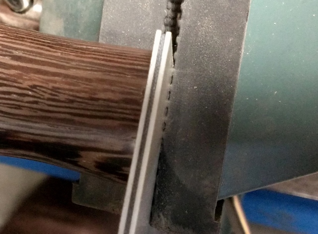

Things were shaky at first, but I found a few things that work for me, that I feel helped lead me to my results. I was having a lot of trouble judging what was happening as I swept out of the grind at the tip, but once I started using my sense of hearing as well as touch and sight, I had better luck. I also found that you need to hold the blade securely enough to be safe, but lightly enough to find its own path. The smallest blade took me repeated tries to get an acceptable result in the tip area.
