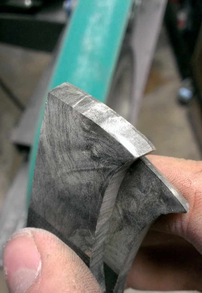

As far as the actual grinding goes, I'm doing that on a pretty traditional KMG setup, 10" wheel and flat work rest, everything is basically freehand. I'm not using any kind of mechanical aids like a stop/file guide, but I do use scribed lines and layout dye to mark my edge center and my plunge starting point.
Most of the knives in this batch were done by gut feeling, I just started sketching right on the stock and then went from there. I did have some plan for each, but I also let them evolve on their own.

I've done a lot of grinding high speed steel lathe bits, as well as re-profiling of boring and parting tools, which is similar to knife grinding in many ways. You have several angles and surfaces that need to meet up with each other in a specific location, plus surface finish, accuracy, and sharpness all dictate what cut quality you will achieve once you take it to the machine. I think that is what gave me such a good starting point for knife grinding.
Even so, the first blade I ground was still an adventure for me. I've had close calls on at least 4-5 out of the 12 I've done so far, and almost an outright loss on 2 of them. I learned several tricks on my first few blades that have served me well through these last few.
When I screw up or feel myself possibly screwing up, I immediately bring the blade back and step away from the grinder. I study what just happened, why, and how it relates to what I have finished so far. Then I make a plan to recover my mistake. I get up a bit closer on the machine, and with a very gentle touch, do a couple "repair passes" to see how my proposed solution will work out. If I still feel comfortable then, I will begin to very gingerly try to bring it back to where I thought it should be. I check regularly, and if it seems like I'm going off the rails again, I step back once more and study again.

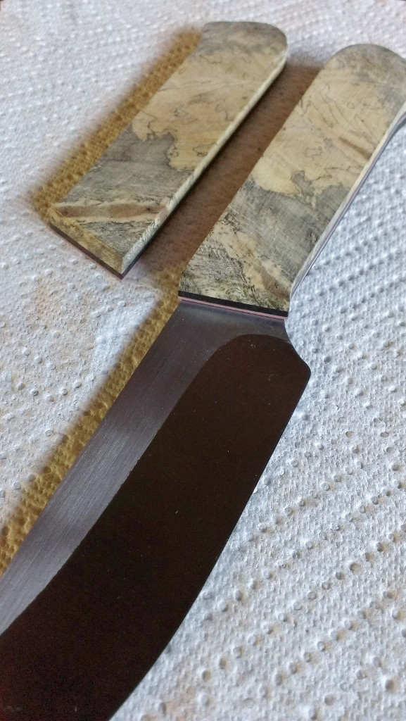

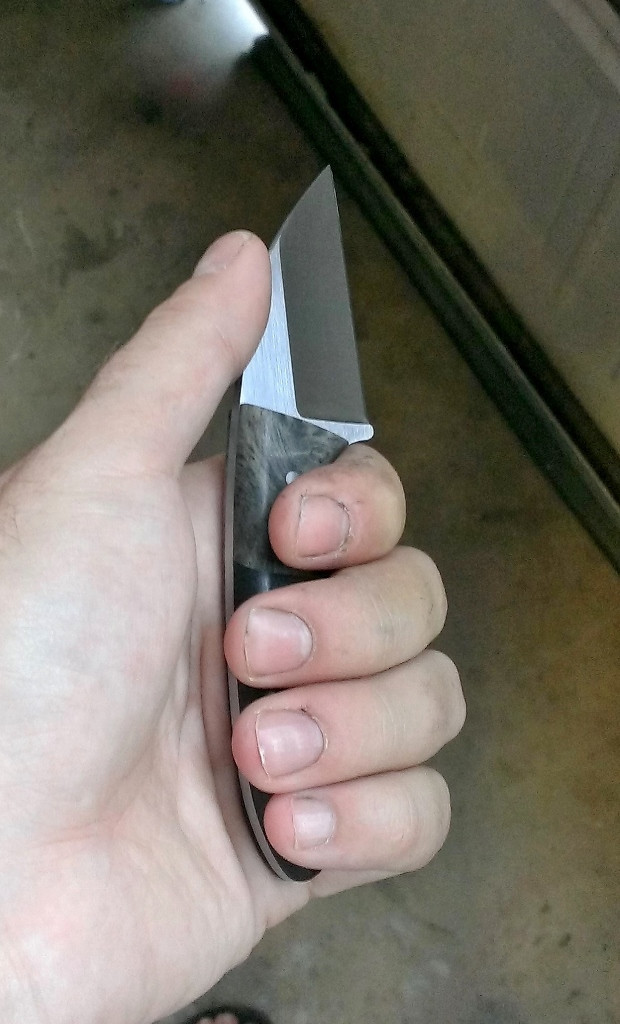

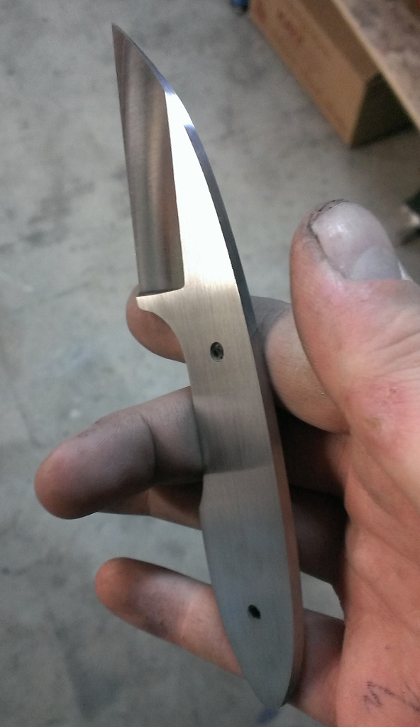

This weekend I finished up the small utility/EDC Wharncliffe. It was my least favorite in the beginning, but it really grew on me once I finished it.

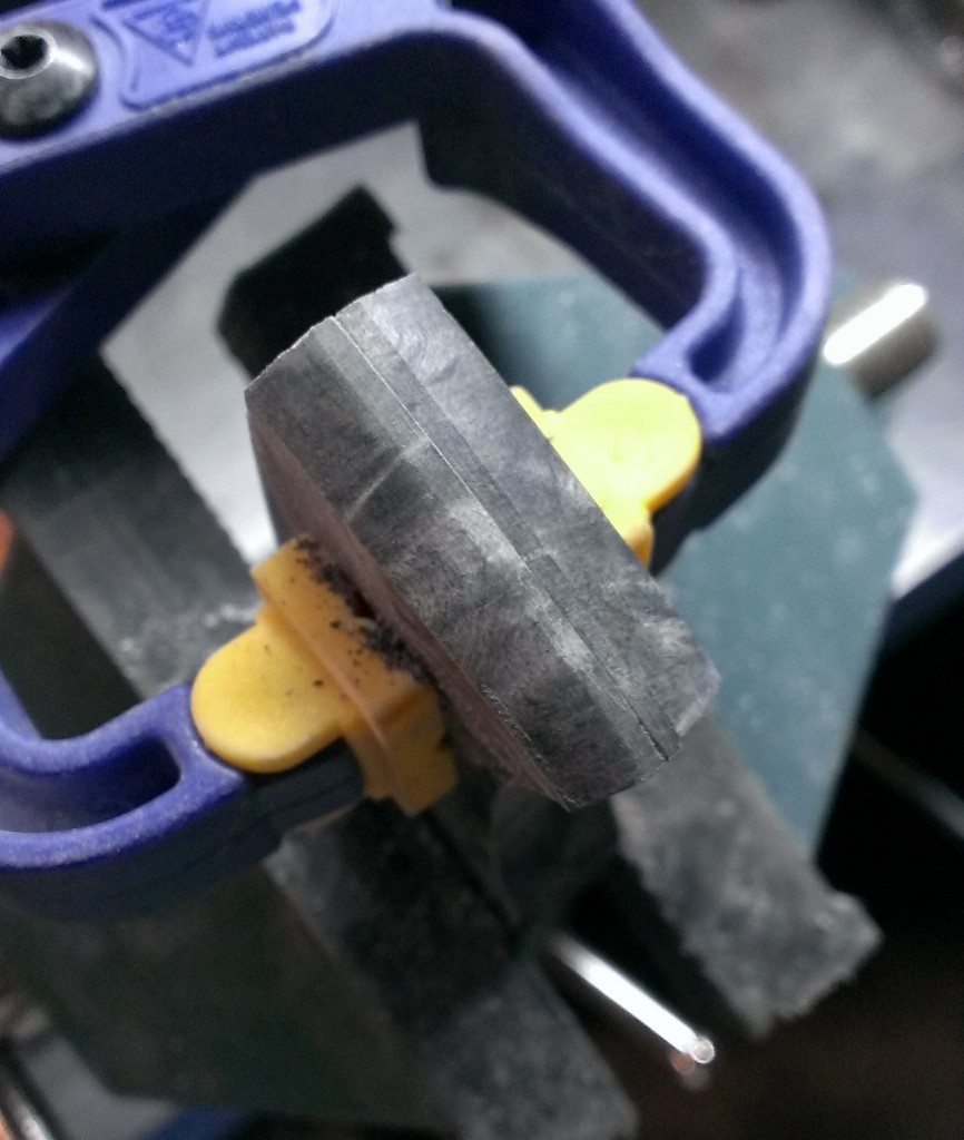

After post HT clean-up. I went to 400 hand sanded on the flats and 320 as ground on the hollow.
I made the scales out of 1/2 of a black G10 set, and a couple scraps left over from the grey buckeye hunter I finished a couple weeks ago.

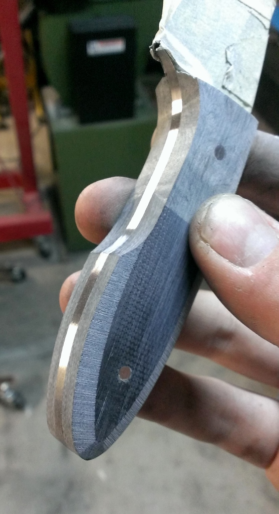

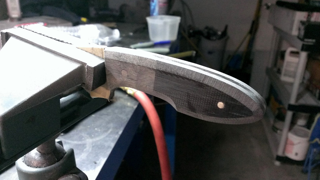

I beveled the scales on the 6x48 with a 220 belt, then hand finished with 400 then 1000 on my imitation panavise.
After a quick buff these guys really sparkled. I wish I had more from than same block.

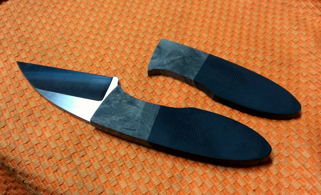

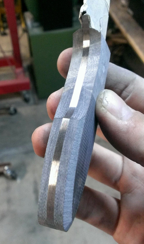

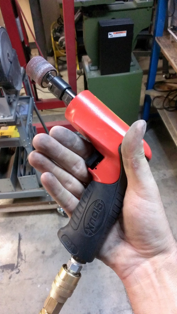

I used my pistol grip die grinder with a 1" drum to finish out the insides of the handles. I love this thing. Sioux is the OEM for a great deal of Snap-on's air tools, and I snagged this guy for cheap on ebay because not many are familiar with the name. It runs incredibly true and doesn't slow under normal load, so you can get amazing finishes with it.
It made very quick work of the inside curves on the handle.

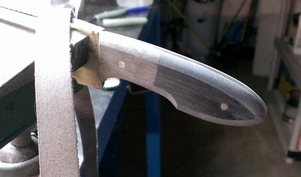

I used the 1" drum to finish pre-beveling the handle on the inside curve before hand sanding, then set it up in my panavise.
This is after rough sanding the top of the handle with a strip of worn out 220. I brought it right up to the edge of the tang, then finished out with a narrower strip of 400, then 1000.

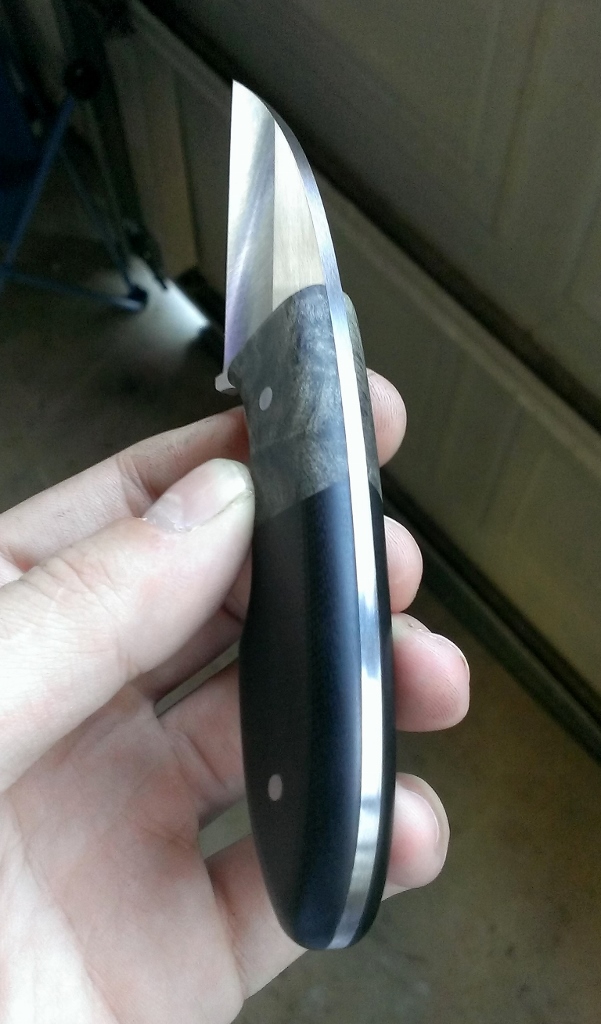

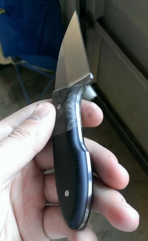

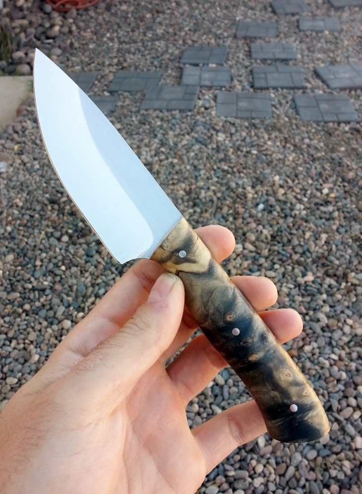

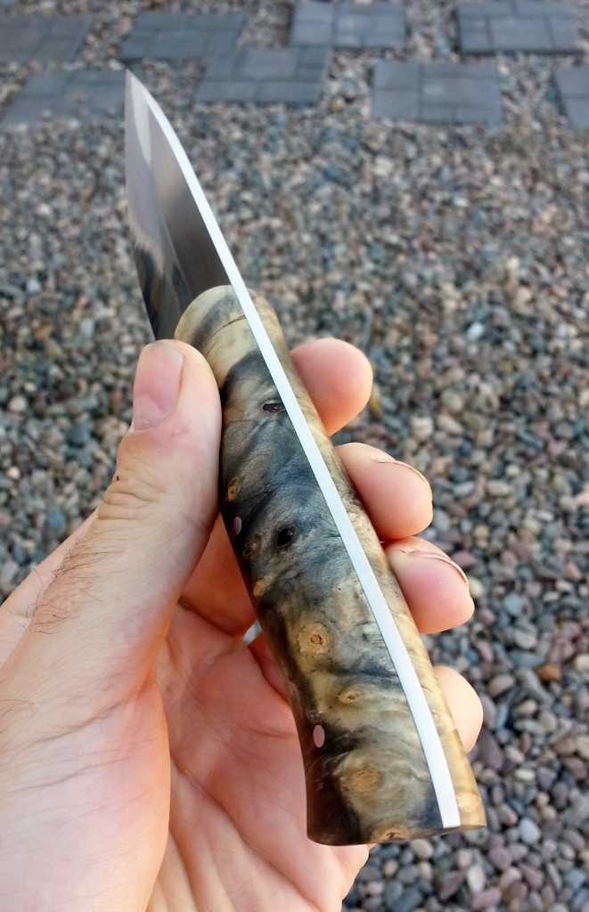

I had to wait for the sun to come up for decent pics, I'm really happy with how this little guy came out. It just sinks into the hand, and looks a lot more balanced aesthetically now that the scales are on and finished. That isn't a burr at the end of the blade, just some fuzz from me fiddling with it.
There was a small chip from peening on the front pin, but I didn't mess with it, and it ended up finishing out nicely with only a very slight shadow.
I'm very happy with the ergonomics on this. I was very worried about getting a good balance of ergos, looks, and compactness, I think it did fairly well. It also works nicely with an index finger on blade/middle finger curled under grip (like you'd use for zipping open a package), because of the double width choil.

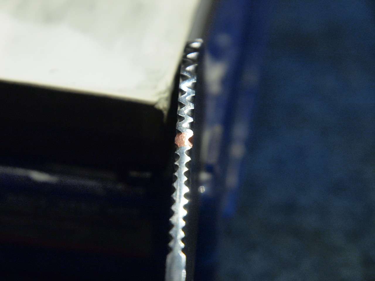

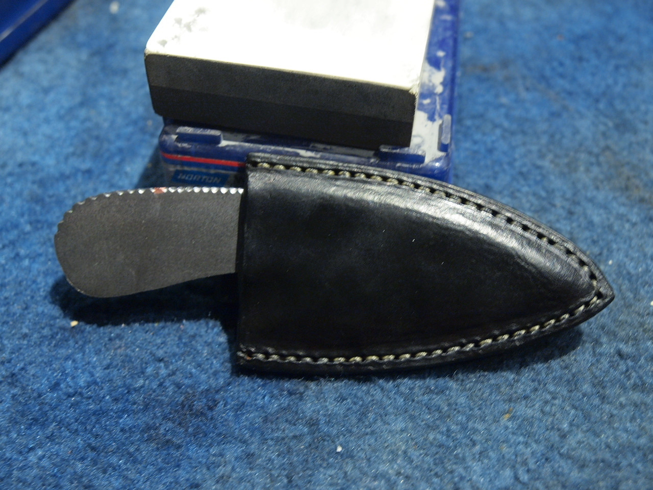

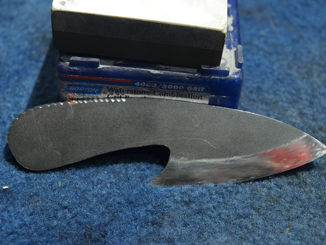

Here is my little knife
its 440c , its not heat treated yet. There is a copper inlay (i messed up the filework and for some reason just filed a notch out thinking it would look cool , then decided to try inlay)
I love the sheath i made for it. For some reason I enjoy the sheath more than the knife.
