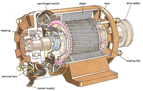

Changing bearings in ANY electric motor is real easy. Take it apart,(usually only 4 motor length bolts)(remove the pully) blow all the dust that is in there out (there will be dust even if it is enclosed), most have a snap ring holding the bearings in, remove it/them, replace bearings and reassemble. I could do it in about an hour. No point in paying for something you can do yourself. The only pain in the butt part if yours has brushes is getting them to stay in during reassemble, take a real small Allen wrench and hold them in while you slip it back together. Electric motors really are very simple. Pay attention to how you take it apart and just put it back together that way. I have rebuilt probably 50 of the things in all sizes for jobs I have worked in the past, so if you have problems let me know and I can probably tell you how to fix it. Even if the armature/rotor is messed up they can be fixed real easy. I had one that the armatures grooves where melted because they were rubbing on the stator, took a grinder and made new grooves, soldered a broken wire and that motor still is working today and that was about 8 years ago and it is used daily for several hours.

more likely the centrifical switch had some gunk or other problems, that got cleared up when you tore it down. That switch engages the startup windings at stand still and kicks them out at low rpm as the motor ramps up to speed. The symptom you discribed of running fine after you hand start it is typical of a failure in that switch.
On brushed motors, watch out for a strange shaped peice of metal that appears to serve no purpose. This peice is used to hold the brushes in position during assembly and just pushes out of the way as the rotor slides in and allows the brushes to make contact.
