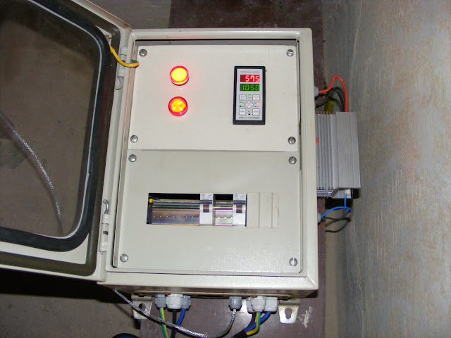

the last version of wiring that I will use. :)
I will rule the phase, but I will put an extra fuse between oven and SSR. I saw that on my friend oven.
Thanks for posting that, I was wondering the difference between an AC control and DC control SSR.
You just need to get a SSR that will handle the load of you elements and that matches your PID output. Most SSR are rated for so many amps and have a range of voltage that will switch them on. Most of the ones from Aubeins need 4 to 32 vdc to switch on. If the SSR doesnt match the PID the SSR will either fail to operate of one of them will burn up. Also if DC you need to wire it for the correct polarity or it won't turn on. I learned that one the hard way.
I discovered that a fuse between heater and SSR, phase comutating scheme cannot protect the SSR!!!. Manifactirer told me that the SSR will burn faster than fuse will turn off. Anyway, it is allready done like that.

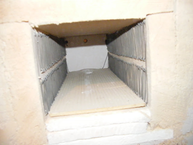

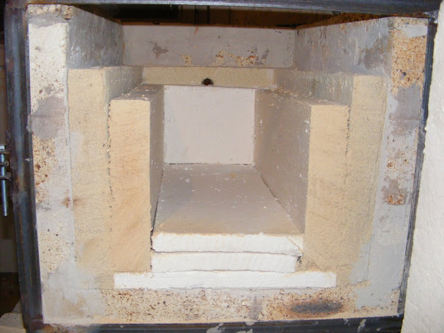

I have a dissapointment, guys. 3Kw heater is far too weak for my oven. It take 950C for 6 hours. Faaar toooo slow for me. I will remove the floor heaters and try it on 4Kw next weekend. If it doesn't work on 4Kw fast enough, I will add another layer of insulating plane 5cm thick and I will make heaters from thinner wire. Inside chamber will be 20x20x55cm if resized.
Clip from testing with controller.
I made a test without heaters on the bottom - 4kw and it reached 1050C for two and a half hours . I still think it is slow, and I will resize the inside chamber on 20x20x50cm. My next heaters will be 1.8mm thick heater on 4KW - the same mount with spikes.

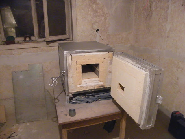

Guys, I finally finish that monster. 1050'C for 54 minutes on 3600W electrical power. I am in a profi league now. :D I HAVE HT OVEN NOW. YESSSSS:jerkit:
The only thing that I will repair in the future will be if the heater burn out, but I can made myself a newone. :D All that stuff costs me arround 500 EU. A lot more cheaper than factory made (not better, but certainly not lot worse), I can repair it by myself, and most important is that now I can make new one - even cheaper and better. If I have to make another one it would be arround 400EU all costs.
My advice - if someone is making oven like that - dont put bricks - use only fireproof insulation boards and lighter construction. Imagine the same oven smaller - without lightweight bricks, or if you like the same size - use the same insulation boards instead of bricks. More insulation - more speed and economy.
