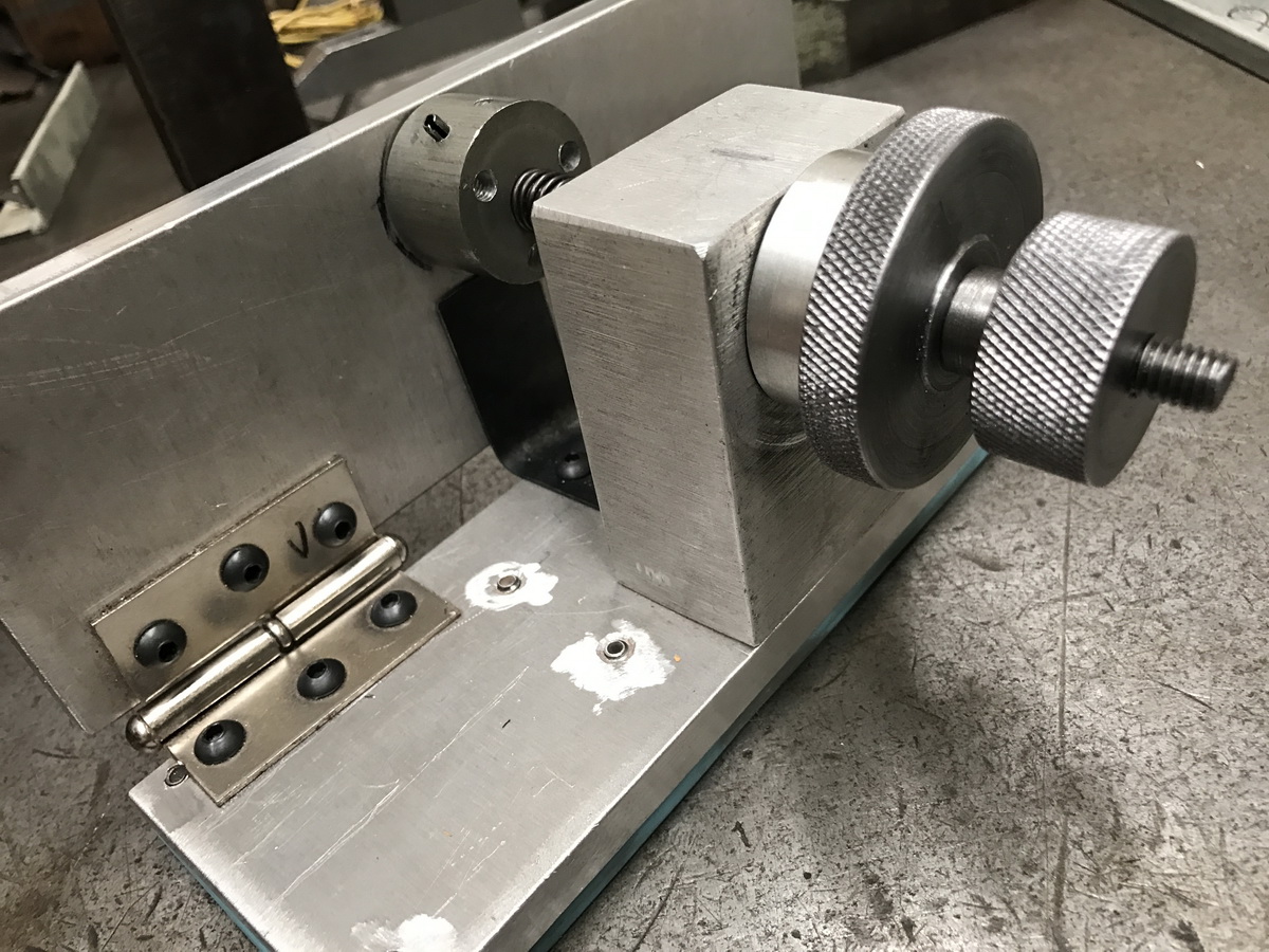

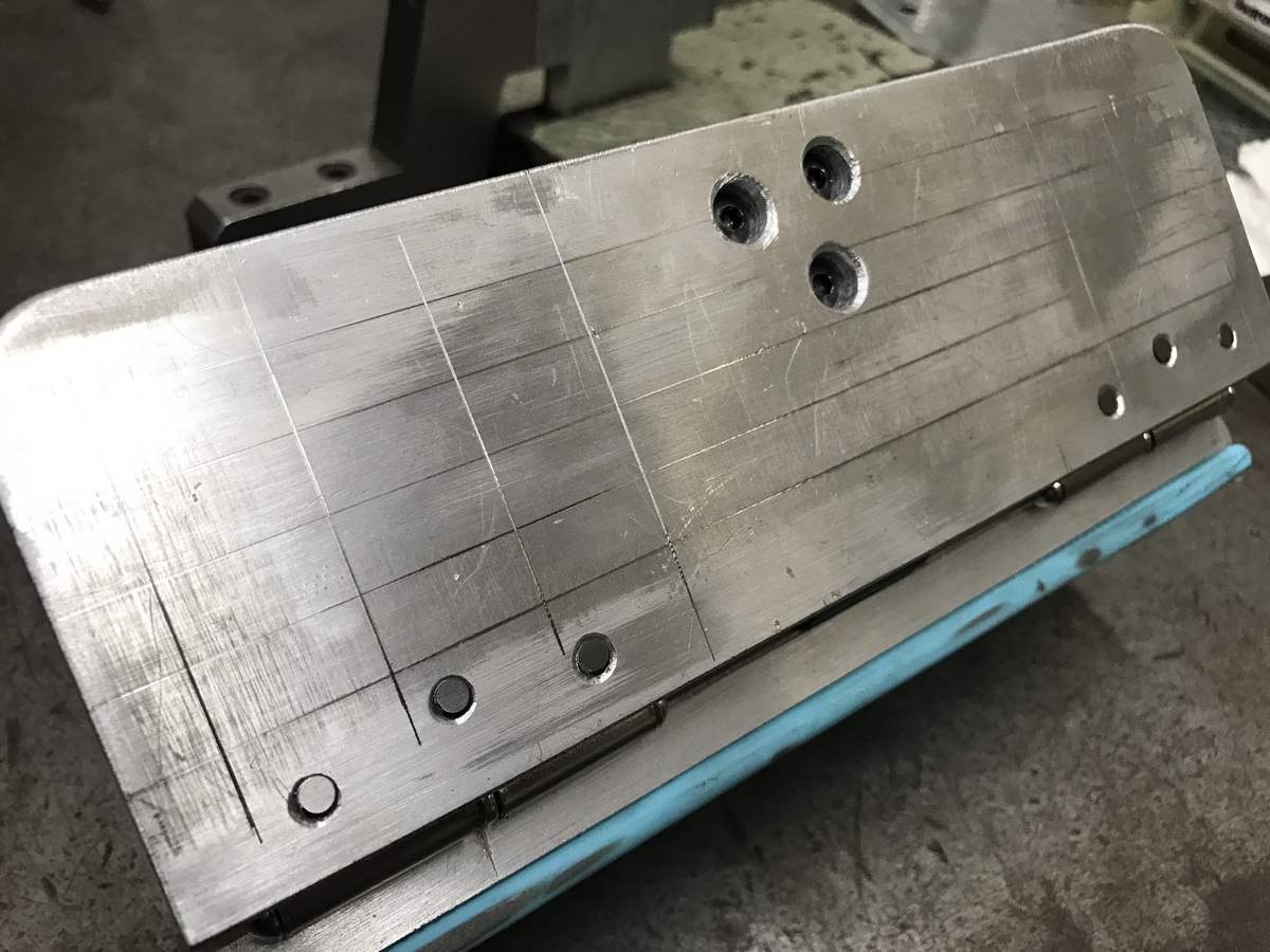

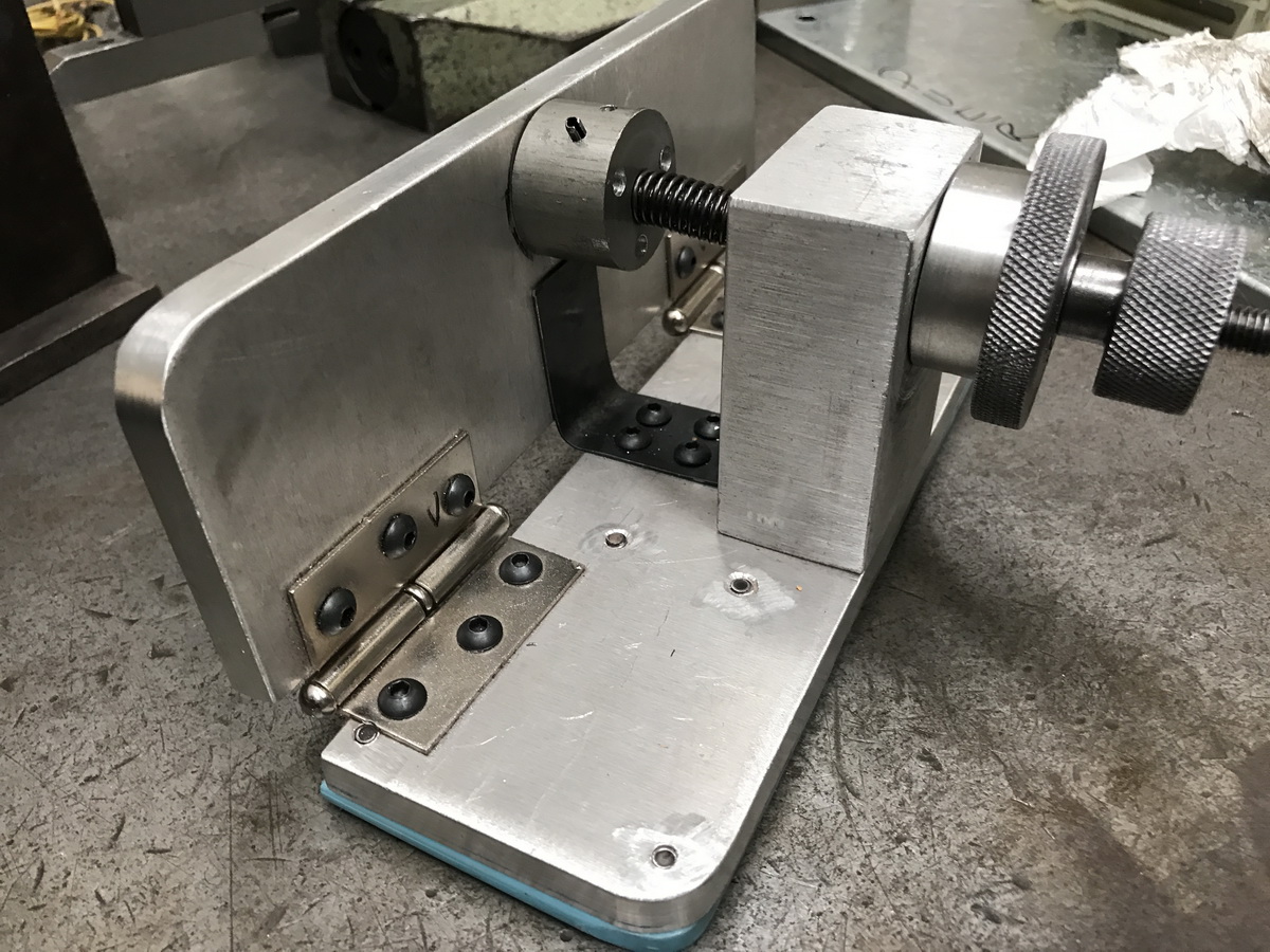

When I started making knives the mechanical head in me told me to make a jig so bevels would be easy, it wasn't if you didn't know a lot of things about making knives, so now, many years later, here is my new knife grinding jig, I only have to make the front threaded holes for it to be finished, but my work week ended so, they are going to be made next week, already traced with an height gauge their locations.

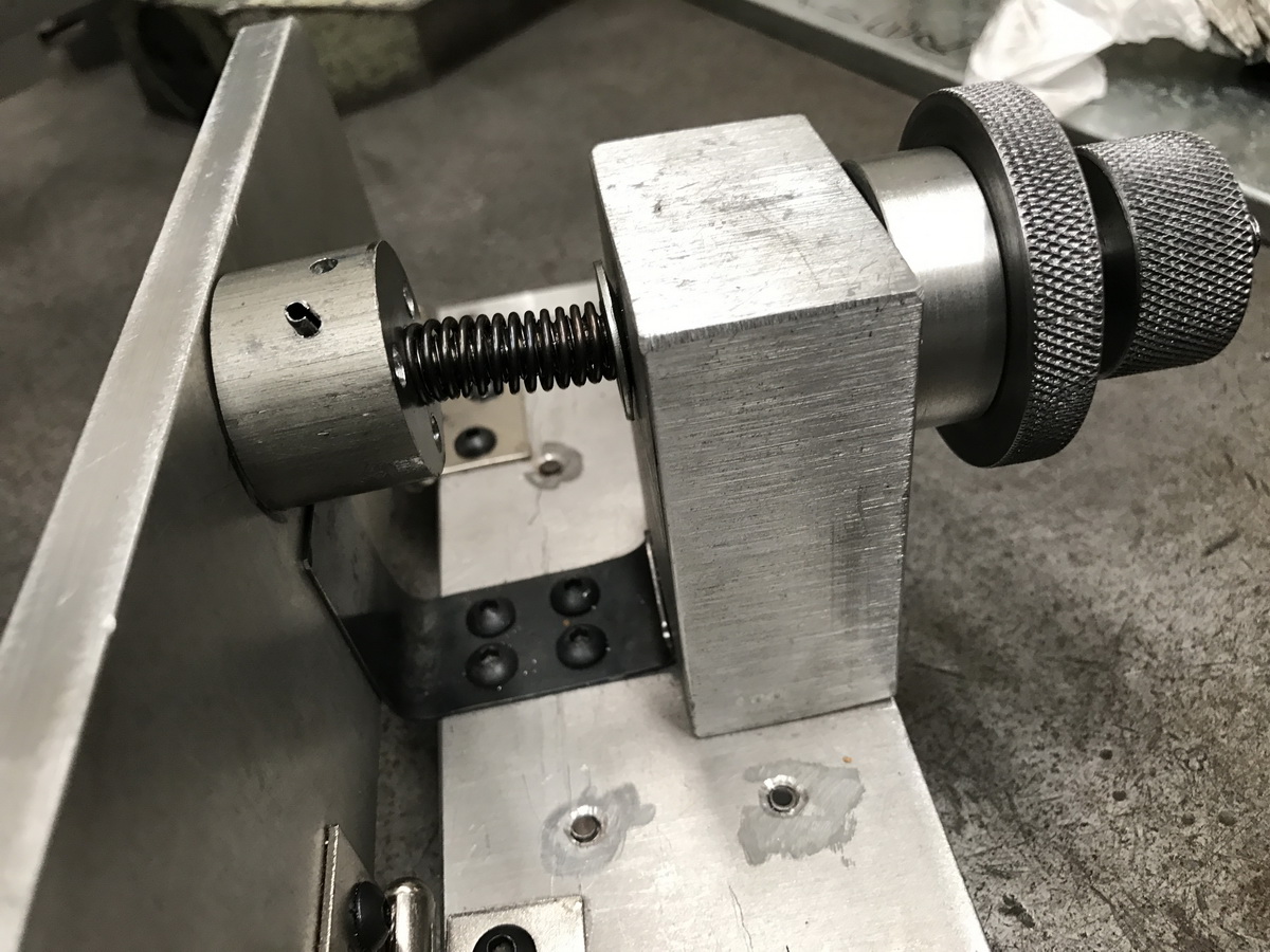

Planned it on the go with many ideas I saw online, since I used only stuff I had lying around I had to solve the varying angle of the platten with respect to the adjusting stand, other designs used rod ends or other mechanical solutions, I used a threaded rod with a hole and a spring pin, kludgy but works.
Hinges are regular small door ones, and the initial spring was the black metal piece of 1095 steel hardened and tempered to be springy, but later I tought to add the axial spring over the threaded rod.
The hole in the stand allows for some play of the threaded rod, and finally I used the lathe to make and knurl the main knob and the small one to keep it in place.
Total angle movement is around 10 degrees, more than enough for a flat grind. Finally added a piece of cutting board to the bottom to make it slide better.

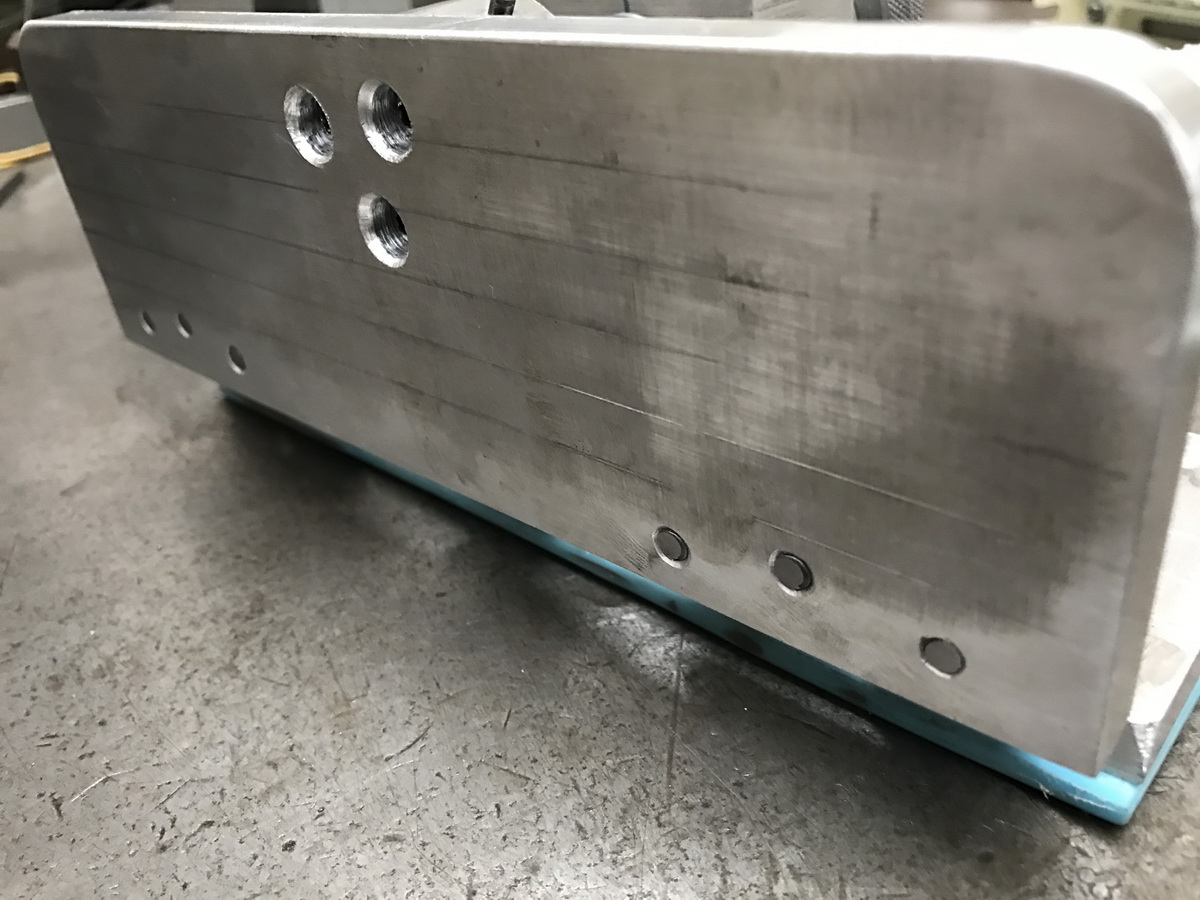

I still need to make the threaded holes, you put a screw or two to have repetability, align edge to top and then use the clamp of your choice to keep the blade in place

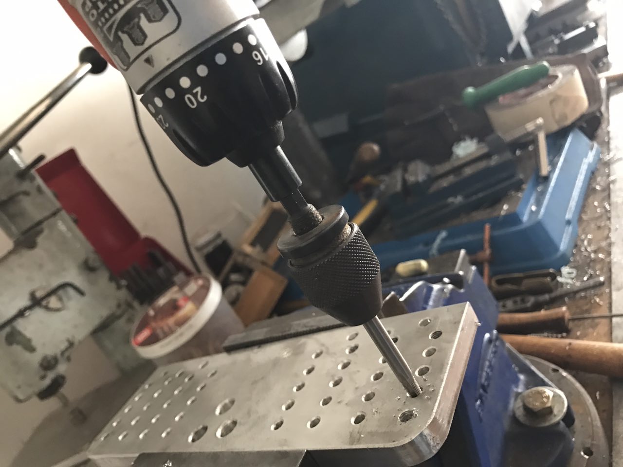

Finished the holes and threaded them all !!! If you ever need to do all these threaded holes this little chuck with hexagonal arbor does wonders, using an electric screwdriver with torque control you can do all the threads (40 in my case) in less than 10 minutes!
Of course, a tapmatic is THE solution, but I don't have one.
