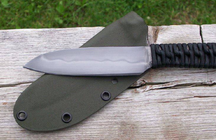

Here is a few pictures of my second forged knife from beginning to end…
Knife was forged out of 1084 1” X1/4”bar stock, under the watchful eye of Master Blade-smith Wally Hayes
This is the knife blank pretty much forged to shape
This picture,, the blank is profiled, although pommel changed slightly.
This picture the knife is coming to shape. Rough grinds are in, although I chased the grind all the way to the top and lost all of my hammer marks….Ohh Well!
This is the knife done , the clay temper line shows nicely…

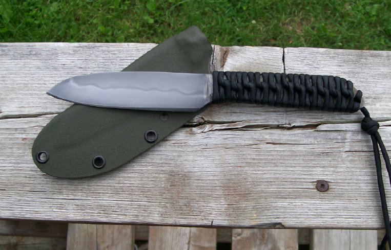

Another view. Handle is 550 cord wrapped with Cyanoacrylate treatment making for very durable non slip handle.
Anyway,, was a really fun knife to make, I’m for sure going to be making more of this model in the future..
Special thanks to Wally Hayes for all of his help and constant guidance.
Thanks for looking guys…

i love that temper line...

I'm very happy with the Temper line..

"Cyanoacrylate treatment"
Basically Crazy Glue,,, Shhhh !
I use Rocket "Hot", super thin and goes right through the cord and cures Rock solid...
Good stuff...

great work, love the clay temper line.
Whats the blade length and overall?
Very well done. I like that temper line too, kind of Samurai. Mac

that's a beauty! that hamon is really nice - sort of a cross between a bushcraft knife and something from feudal japan
