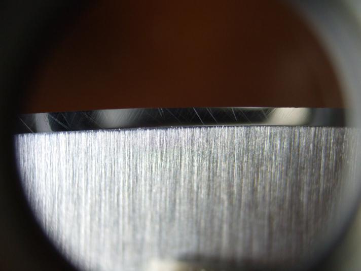

I finally had time to try out my sharpening rig.
The results are nice, but not perfect because I made some mistakes in my technique:
Actually, the results aren't as good as they appear because I made some mistakes. I found this out when I took some close-up photos of my edge.
First off, after the 600 grit MoldMaster stones from CongressTools.com:
The ruler is in millimeters.
Right now, I don't have an intermediate grit between 600 grit moldmaster stones and 0.5 micron diamond paste. So, things didn't work so well, but it wasn't horrible.
After stropping with 0.5 micron diamond paste on wood:
Oops! As you can see, I got the angle wrong on my stropping, so I polished mostly the back of the bevel away from the cutting edge. Oh well.

Nice work! There are some stray scratches and a little unevenness in the edge, but that's easily fixable. The loupe is an essential learning tool IMO.

Yeah, I'm still working on getting a better edge; I think something is wrong with my technique so there is some unevenness in the edge. I think I'm getting some micro-chipping when sharpening. :(
Thanks for the point that some stones may be flexible. I was thinking they're made of very hard (and therefore rigid) material. But I didn't think that they might have flex, possibly because of the binder. Thanks! I'll have to think about making a blank backing for the stones.
