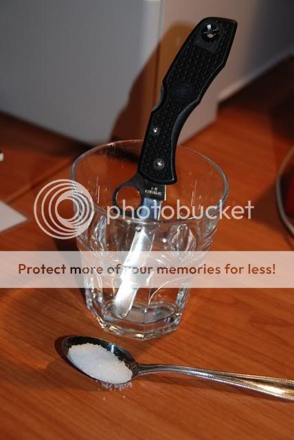

Sal is correct. I posed a similar question when I did a small stress test on my Salt I in a cup of salted water for 1 week.
Similar H1 logo 'tarnishes'. I was assured it was deposits from the etching/ engraving process. True enough it went away after I washed it.

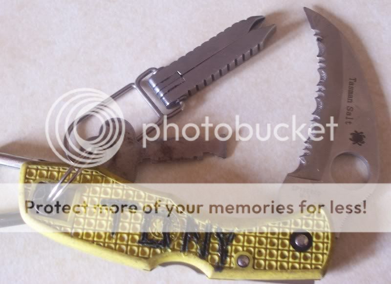

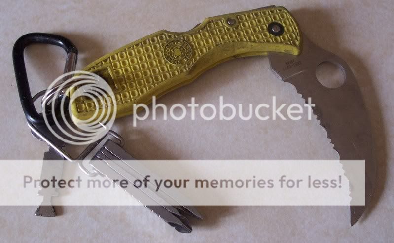

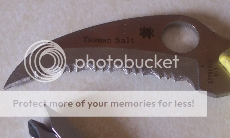

here are some pics of my tasman that i took when i was on furlough and they were washing my bunker gear:( so i had to take everything off of it. this knife has been clipped onto my jacket for about a year now (i used to have a clip-it but it rusted after just one fire) it has been beat to sh#t and has been exposed to alot of water/chemicals/soot but no rust...i don't clean it, i just sharpen it once in awhile...it also cut a guy out that was pinned in his car after an accident. if anybody was sitting on the fence with the salts...just go get one, you won't be disappointed.
edit...that isnt rust on the tooth that is missing...when i was at the pin in, the car was upside and i had to cut the wires to the power seat in order to remove it...it arced (sp?) and took the tooth off...a few strokes on the sharpmaker and it is good as new.
Now, these are the kind of pictures I like to see. I like to see how these knives stand up to real use, not just sitting in someone's pocket, drawer or display case.
Awesome pics, Tony. Thanks for sharing them.

Nice pic Tony :)
My Salt I is a bit scuffed up, but yours is in active duty. I'm not sure whose knife you have there mate....the burnt DIY name etching on it is rather faint. Can you read what it says on it :P ;)
Glad it managed to get someone out in a sticky situation. I like how you left the yellow to naturally patina with dirt and grime....very much in the spirit of the working H1. Good stuff.
