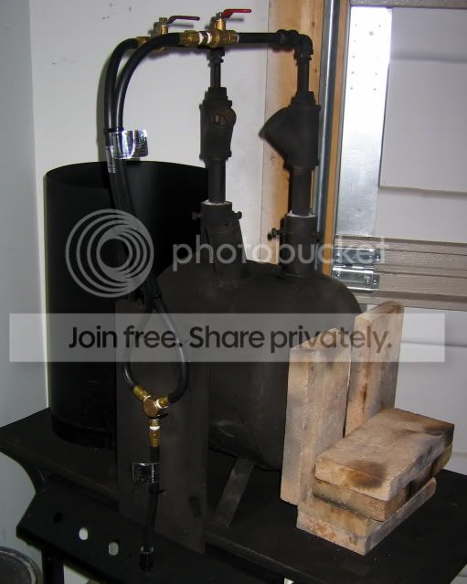

I finally got around to rebuilding my forge and making a new quench tank. I added a burner to even out the heat and run more efficiently. It runs perfectly at 5psi.... At 10psi, it gets to over 2400F.
Forge, anvil, Q-tank, water bucket, tongs and hammers...
My homemade propane tank forge. I just added another burner. You can see the old mounting tube...

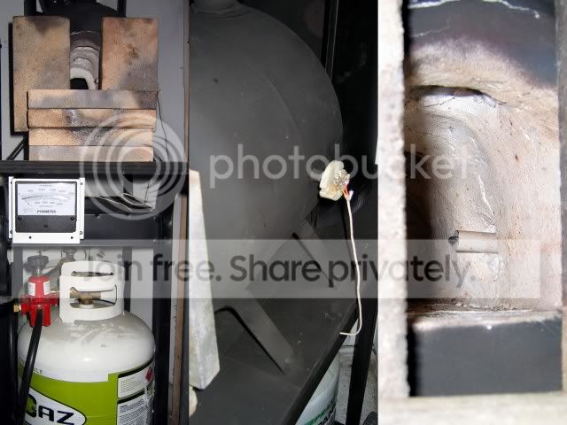

The regulator and pyrometer are located safely underneath the table. I also added a split manifold to run (2) tanks...

nice setup rick!
If you dont mind me asking how must did the forge run you? I have been looking to set one up for a while, also is it pretty easy to control the heat output?
Thanks Drew,
I put just under $200 into it (including the upgrade to 2 burners). It is not as exact as an oven. Under the torches is always hotter. When I run the forge at 1.5 - 2psi it hangs at 1500F and my tempilstix confirm.:thumbup:

Keep an eye on that white teflon tape on your fittings (looks like tape in the pics, could very well be compound :) ). I've heard that even though white is rated for LP, it can prematurely break down. Yellow is recommended for LP gas. Just a heads up :)
No prob. White tape's packaging says it will work for LP, but I would keep an eye on it. The yellow is thicker and more chemically resistant to LP.

What's the big cylinder on the stand behind the forge? Some sort of "thermal/smoke stack" buffering between your forge and the wall? Or....?
Correct.... its a split stove pipe that acts as a heat shield to protect my wall. It just slides off for doing longer blades... another reason for having my forge on wheels too. I can roll it away from the wall to do big stuff.

OOPS.... didn't even notice that, Yote. I forgot to put the thermocouple on for the pic. It is a wire that hangs over the edge of the tank and about 10" down inside the oil. It plugs into the side of the readout.
Rick
I'm still using a meat thermometer. I suck.
I'll have to one up you by installing a threaded thermocouple. or two, at different heights! :D :D
