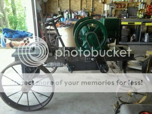

Do you have a farm equipment scrap yard close?
Spoked wheels from old equipment may work too.
Heck, peoople have those wheels sitting in their yards for decoration.
It has become popular for skid steers to use metal rims and solid tires.
Or you could maybe fab a wheel from iron plate for less cost... it would be heavy, though.
I agree that this a sourcing problem most likely to be solved by a keen eye for rusty stuff and recyclable items. Fortunately, I've been cultivating that for years.
It also turns my mind to thoughts of whether I could possibly fab an iron rimmed and spoked wheel or not. If the water could be removed when not in use, and the wheel was painted well with even zinc spray over primer, it could last a long time.
