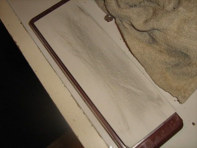

My stone arrived today and me being me I put it to use right away. The first thing I noticed is how the stone feels a bit sticky if you use anything but very light pressure and I guess you could say its not as smooth grinding as I would like it to be. The surface of the stone builds up fast with metal particles making the sticky feeling increase, the stone works great but this build up of metal brings concern to me.
The finish it leaves on the edge is a very high polish and the sharpness it yields is also good but not as impressive as I thought it would be. I'm sure I need some time to get use to how this stone works but keeping the surface clean and some tips and tricks to its proper use would be helpful if anyone has more experience with this stone?
Wow that does look like fast buildup, but it could also be a mind trick since you are use to the gray DMT stones. You can see the metal more clearly on the white backing than gray. That sticky feeling is probably a coating that will either wear away or get washed off if you are using the proper amount of water. I've also heard that waterstones do build up quickly and require frequent cleanings.

I lapped the surface because it was not perfectly flat but this did not make a difference in its performance. The only way to remove the surface build up seems to be lapping :confused:
No pre-soak but I do keep the stone very wet, their is also no slurry build-up but I think this is normal.
The polish is better than the DMT EEF but its not nearly as sharp.
FYI, DMT EEF should never be used for lapping.
It's a resin stone, so I think it will keep the sticky feeling. My 10K also gets a lot of swarf very quickly, I just rub my fingers over it to clean most of it, I keep the surface very wet. I use an artificial nagura from King every now and then to clean fully, and have lapped it a couple times with a coarse DMT. I don't know if you can get any kind of 'bite' off this stone, they are kinda popular with straight shavers, and they don't like harsh edges much (such as some preferring chromium oxide to diamond for final compound stropping)

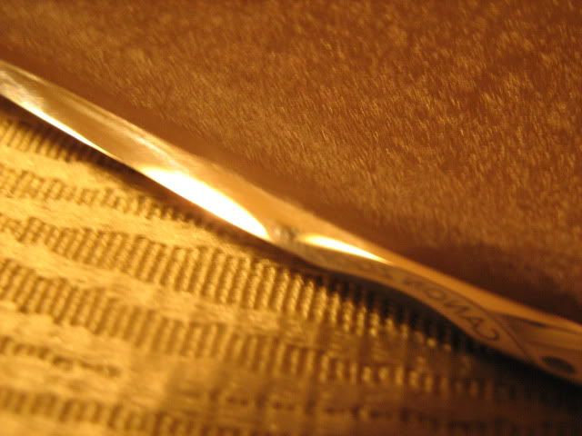

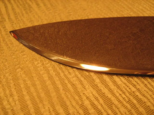

A little more work and this stone is showing its true colors, the edge is not really hair whittling but its very close and I'm sure with a little more practice I'll be getting those results every time. My main reason for getting this stone was for the finishing carbon steels like my SR101, O1, 1095 and others, though my diamond stones worked well these type of steels seem to like a smoother/higher polished edge than the diamond are capable of. I'm on to stropping the edge now and like I thought this is where I'm starting to see the difference. Thanks to all of those that helped me with my decision in my other thread...... looks like I'll be getting more of these :D

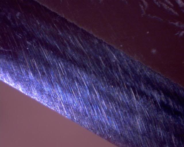

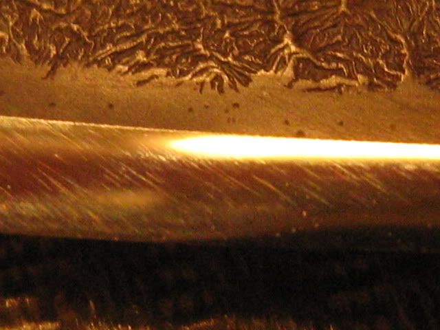

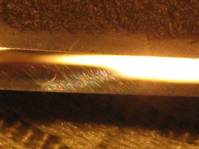

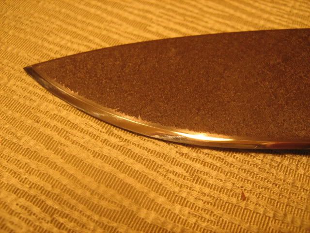

Looks better in person but if you catch it in the right light this is what the scratch pattern looks like.
Scratch pattern at 100x
Looks good, the pictures look similar to what I get pre-loading of the stone. Yes this stone is notorious for loading up easily, but for polishing it works better this way. The finish is finer once it's loaded up, though it will cut very slow which is expected. The only way to clean it up is to either lap it with DMT 8XC or rub the surface with a slurry stone, but if you're moving up from an 8k Naniwa you can just leave the stone permanently in its loaded-up state as a dedicated polishing stone.
I'm getting biting edges with mine, though it typically already has a biting edge from the previous stone (Shapton 6k "High Carbon"). The Shapton's are less gummy, harder, and doesn't load up as easily. The Naniwa's are grittier and provide more feedback. Same results though.
Good to know, I was expecting a better/finer scratch pattern for the rated grit but I have a feeling I will need the 8k and blue aoto I plan on getting next to see the results I feel it should be producing. I'm still not a fan of the gummy feeling but that's not a big issue.
I think you're on the right track, some stones work better when preceded by the same type stone.
FWIW, I've had good results by using more pressure at the beginning, then finishing up with lighter pressure. You may also want to try not lapping and/or using the diamond nagura on it as much, and it won't feel as 'sticky'. (I say that because I don't lap mine that often... when I do, it feels a bit soft for a short while, but it goes away). It may look loaded... but it will still polish.

I thank thombrogan, and I kick myself in the a$$ for not checking in the first place. I was wondering why at some angles the edge looked like it had a perfect polish but at other you could see a scratch pattern :confused: and then at a third angle I spotted the problem...... this stone is REALLY fine. That's when what thom said in the DMT 8000 thread made that little light flicker in my head. This stone is 0.5 microns and I was trying to use it directly after the EEF :eek::foot::o
