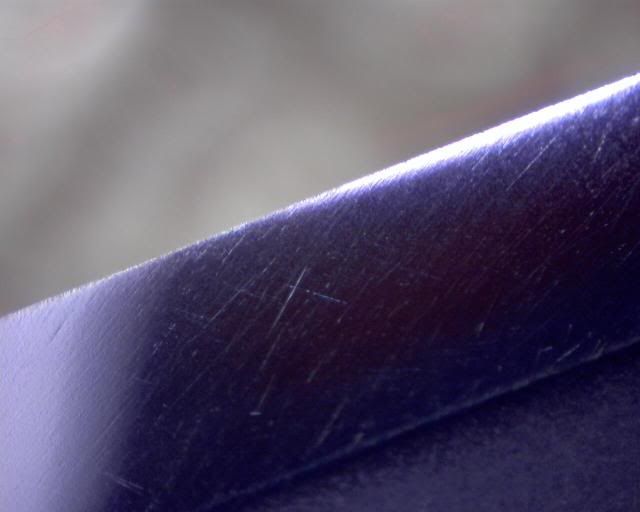

After my Naniwa 12k loads up and I keep going, I eventually end up with a clean mirror polish:
I'm starting to get very good results but still need the 8k stone to do things right. The scratch pattern of the 12k is a little confusing, the edge when done feels very smooth and very sharp like after using chromium oxide but the edge finish even when the stone is loaded is not as polished as you would think it would be. At 100x is where I saw the real scratch pattern though, to the naked eye it looks similar to 2k sandpaper but under magnification it looks like a edge that has been polished with micro abrasive. I can get it to whittle hair sometimes, something I find strange because of how sharp the edge feels, cuts flesh like no other though :)
The other thing I find a little odd is that 1 micron diamond compound is too fine to properly remove the marks left by the 12k.
Yeah I find the 1 micron diamond to be finer and comes after the Naniwa 12k. Well 1 micron is 15-16k so that's what I would expect.
With thread test the Naniwa 12k performs worse than from a 1k stone in cutting the thread, but when I shave with it, the Naniwa 12k is indeed a lot sharper than the 1k. I know it's sharp... just couldn't find a test to prove it other than to shave with it.
Its very "different" you could say, I like the sharpness and cutting ability of a edge after my DMT EEF better but the 12k was not really purchased to improve on sharpness as it was to improve on finish. I can't lie though the 12k edge is about as good as you could ask for without the use of a loaded strop.

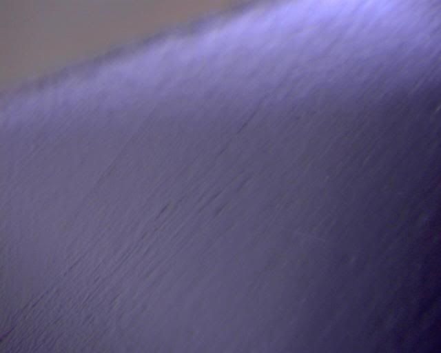

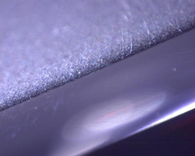

I tested it out on some CPM-D2 that was already polished to best see the results. I was happy with the finish but the method of letting the stone build has raised some questions.
In this pic it looks like metal smearing, opinions?
400x
Looks nice at 100x though :)
Not so close up view

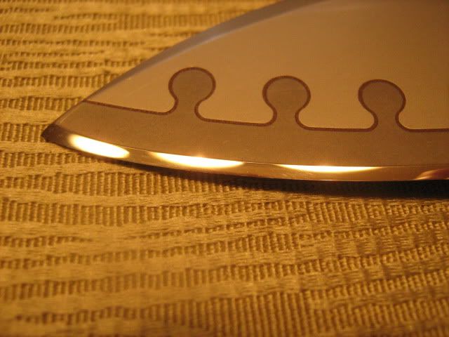

That last photo is about as perfectly a polished edge as I've ever seen. I'd like to use a stone like that just once. I've heard about them, but never seen one. I don't know if I even own a knife whorthy to be run across that stone. Anyway, nice job!!
