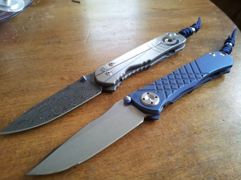

I'm doing a comparison between nano oil weight 10 and Chris Reeves's fluorinated grease. Both knives were broken down and cleaned thoroughly, both knives have perforated washers. I used the nano oil on a Large Sebenza and the fluorinated grease on an Umnumzaan. Both knives are smoother than they have ever been. Both lubes are really great. I'm thinking that the Umnumzaan with the grease is slightly smoother. It's almost too close to call. I've had to have my kids work both knives and they also lean toward the grease. So now ill pay close attention to which holds up better over time. These are definitely the two best lubes I've found so far for my CRK's.
