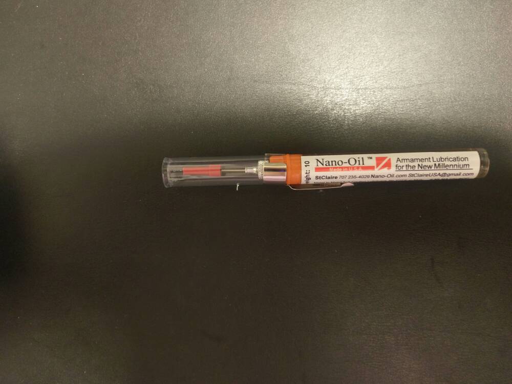

Been using CRK grease ever since I started with CRK. I have heard a few good things about Nano oil though. So, I ordered one and will be giving it a try on one of my user CRK when the time for cleaning comes up.
