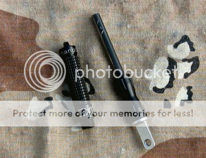

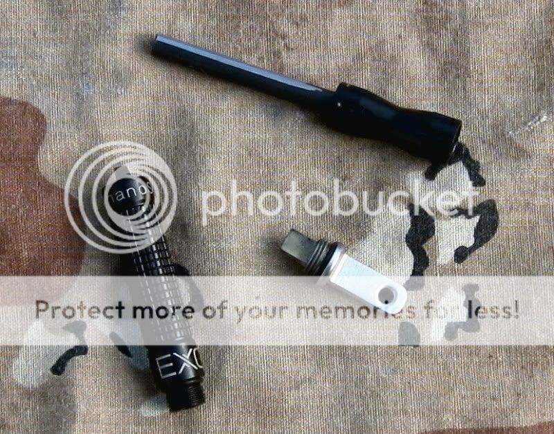

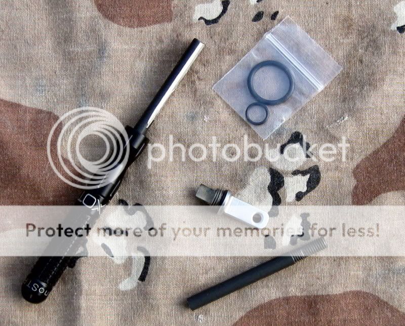

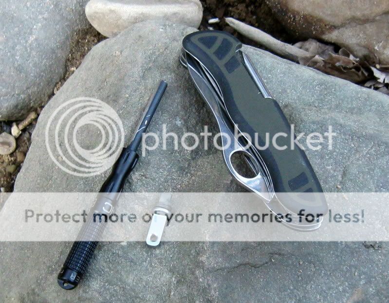

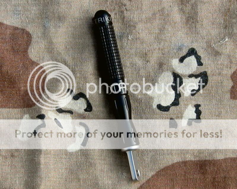

The following pics show the configurations of the tool. One
really cool thing about the nano is that the ferro rod is easily
replacable without having to have any tools at all. The ferro rod
just threads in. The small o-ring in the pack is a spare the nano
striker, the larger one is for a matchsafe.

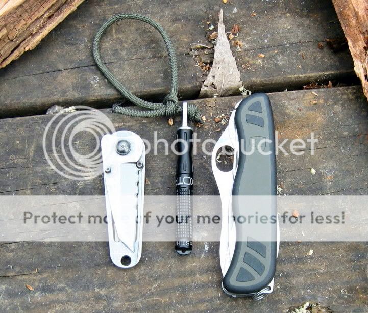

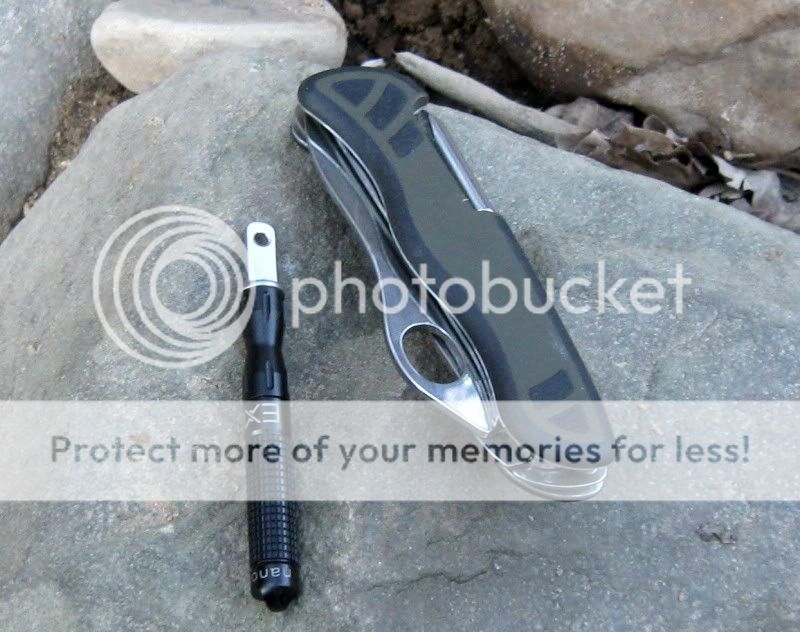

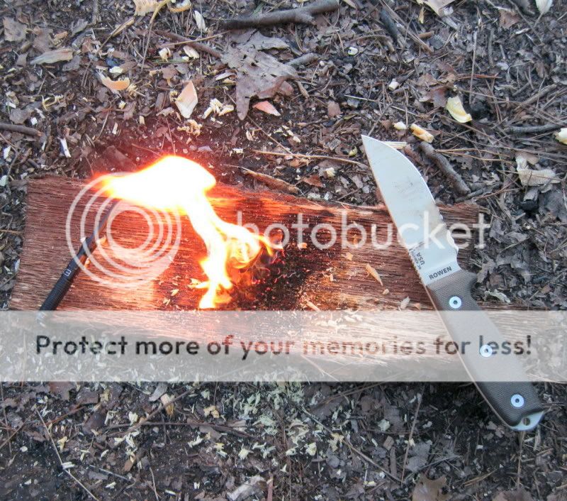

The serrations on my RAT RC-4 work great.

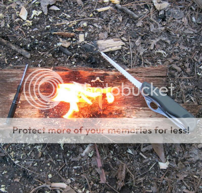

as does the spine of an SAK saw

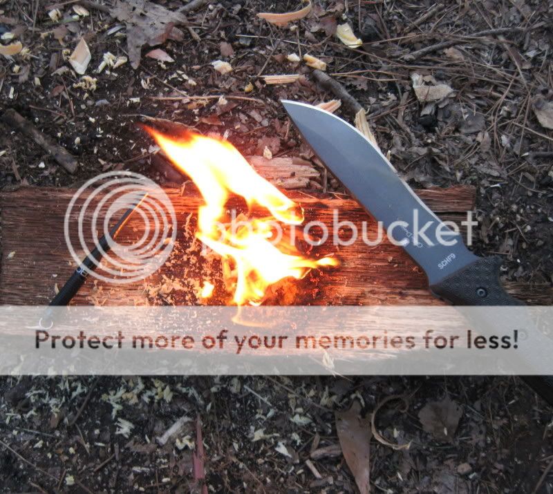

even the edge of a larger knife.
