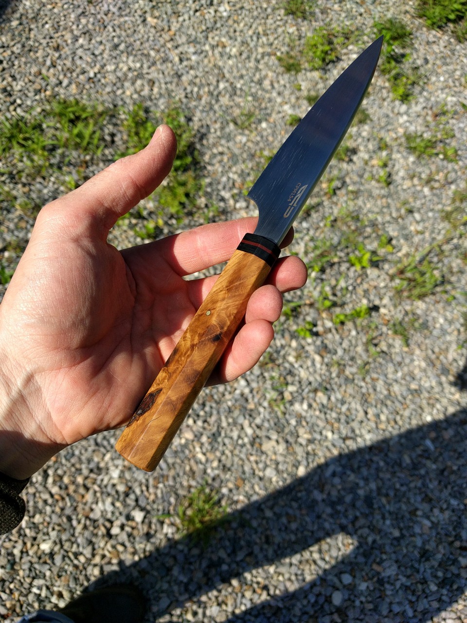

Make sure you post a picture of that when it's finished...it looks promising!
Finished it today.
Any number of flaws with this scrap knife, but given the 5 hours or so I put into it (not including waiting around for heating-treat processes), I'm ok with it. Learned a bunch, which was the goal.
The wood is some variety of white oak - the kind that smells like oaky vanilla when you grind it.
It's hand-sanded to 400, swilled in some BLO, and then waxed. I soaked some superglue into the cavities several times during the process.
