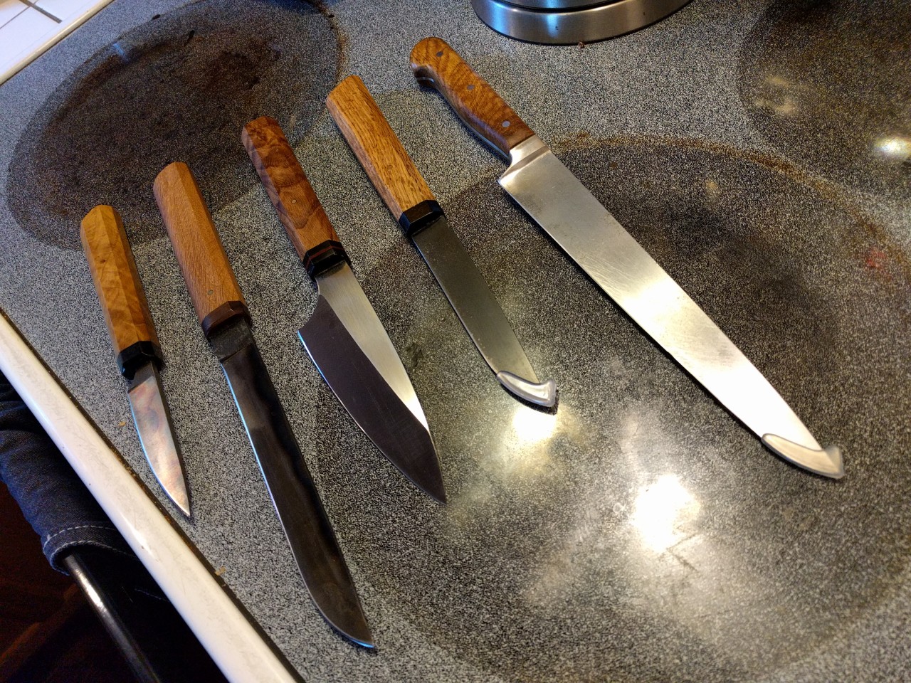

This is un-stabilized iron wood and zebra wood finished with Teak oil after about a year and a half of pretty steady use. Wash and dry after use...NO DISHWASHER...:grumpy:

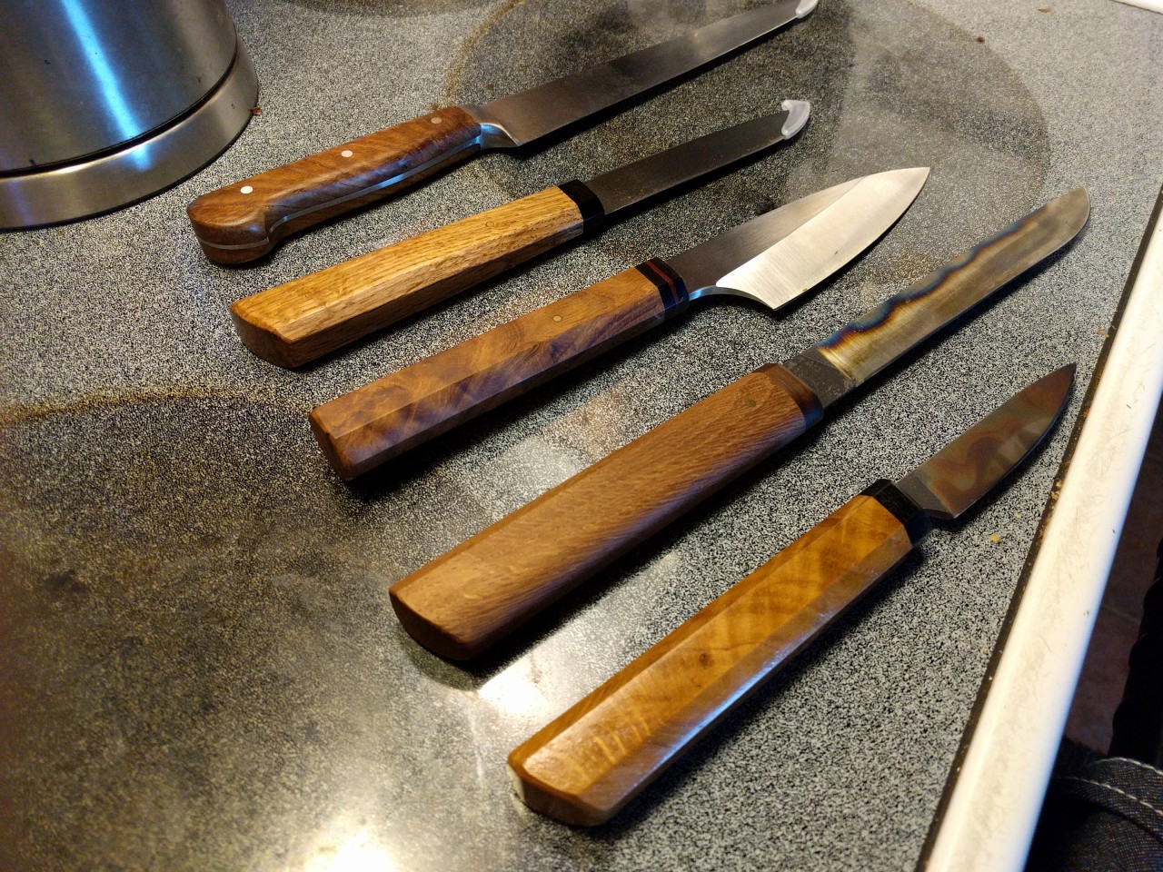

I was oiling some stuff up, and realized white oak really is my go-to material for scrap knives, and a lot were in one place at one time. These are all in the kitchen (actually distributed across two kitchens). The long integral is an old Wusthof that needed new scales.
