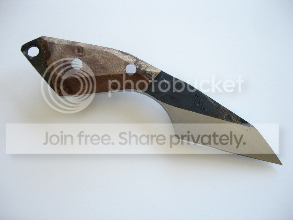

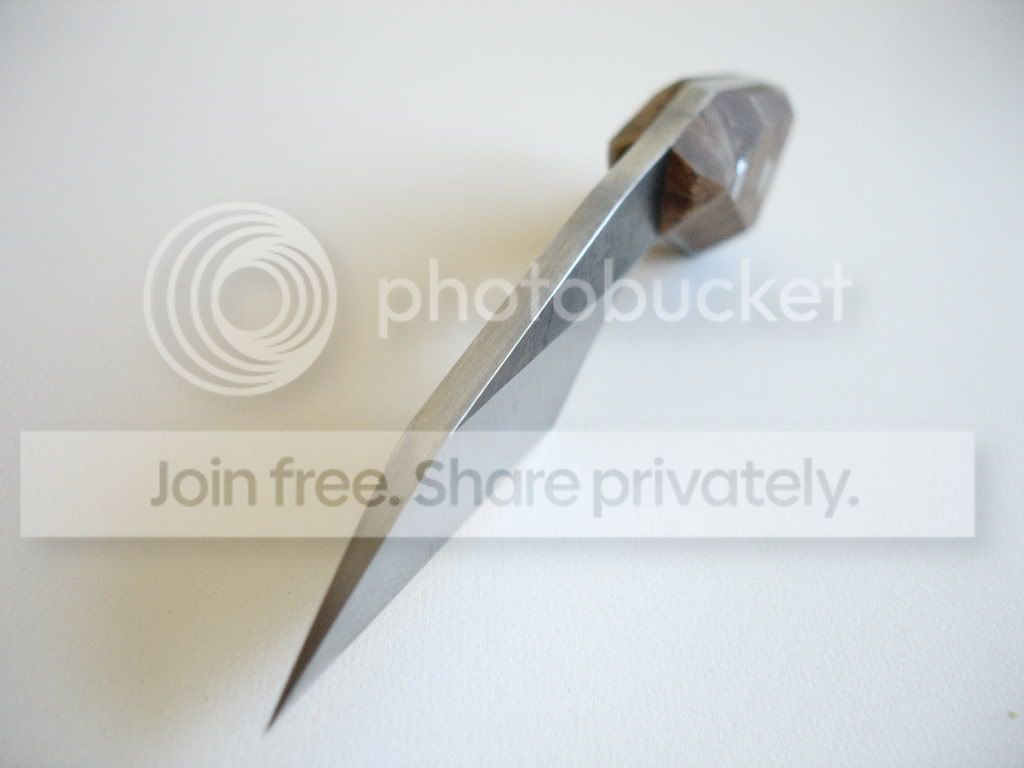

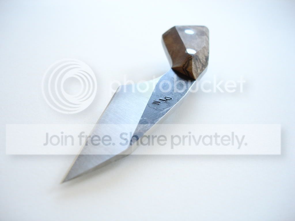

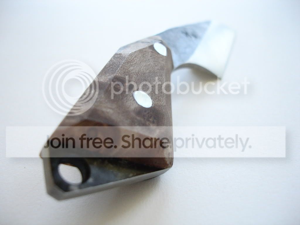

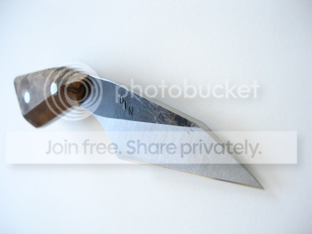

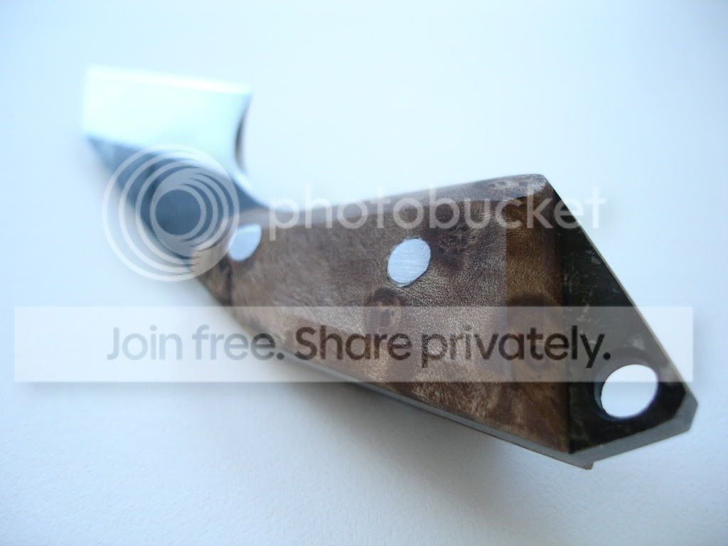

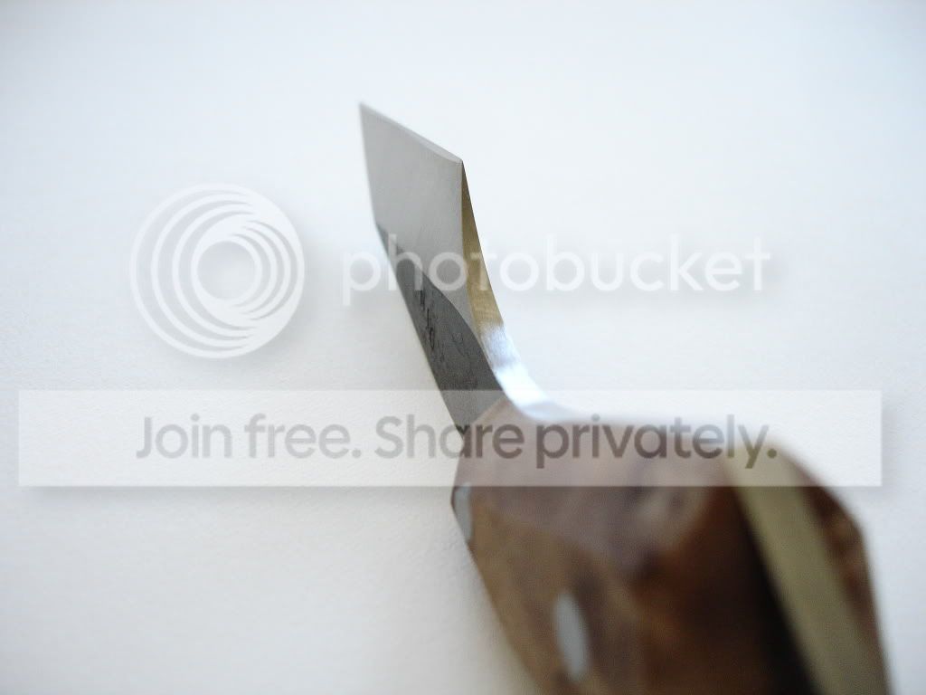

Little experimental knife made using extra material from chef's knife. I've never had any experience with knives outside of the kitchen. Clearly there is a lot wrong about it - aside from glaring fit and finish mishaps, what are the biggest issues? Anything good?
Thanks for your time!

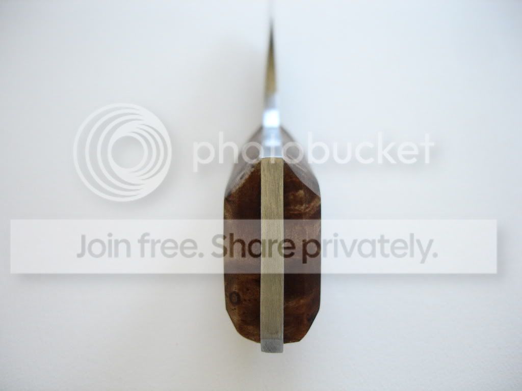

the only thing I don't like are the angles on the handle. For wood, and something that small I think I would prefer rounded curves, but then again they do flow with the blade shape. hmmm I cant decide what I think about the angles now they are growing on me. Seriously though it looks great. the blade looks clean, and I like the black scale. That's a good job!

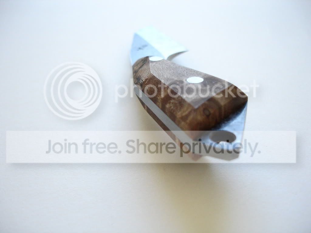

There's a glue line around the rearmost bolt, and it would look better a bit higher and a bit further back. The front bolt could be a size smaller and also moved back a touch. Other than that I sincerely like the handle design, dropped-edge style and the keenness of the bevels. The attention to symmetry on the faceted handles is excellent. It's unique and looks really handy - that could be a "signature" design that sets you apart from all the other neckers that pretty much look the same. Make more!! :thumbup:

I'm thinking that maybe the tip might be a little weak. I wouldn't use it to dig rocks out of the ground or screws out of a board.

I agree with the pin placement now that I look at it. The glue line will be gone tomorrow; it was really difficult trying to remove all the material using sub-par hand tools, so I'll just be sanding that down with the grinder tomorrow.

Would it be better if the tip weren't so sharply angled, and maybe a little bit more 'square'? I do enjoy making these; compared to the larger chef knives they're a nice break - and they're much easier for me too!

Personally, I really like the very keen tip and acute bevels. That knife cries out to be used for fine work. Of course you easily make it a little more robust as you say.

The basic design is as good as they come. I agree with the comment on the pin placement and my own
Preference would be for a less blocky handle, but otherwise I think it is perfect.
I think the basic design is really good. I would use smaller pins, 1/8" or 3/32", maybe but that is just personal preference. I tend to use smaller pins on my small knives so maybe that's just me. A fine tip on a small neck knife is fine; you should be carrying a bigger belt knife for heavy work anyway. :)

A agree with a lot of the comments here. The basic design wins. The handle looks too angular
to be comfortable. Pins could probably be smaller but I lumped that in with the rest of fit and
finish and ignored it.
If you'll really whittle then you'll find the Wharnecliff handy ! The handle should be smoothed out.
I agree with JT on the F&F issues. I would like the scales to be a little shinier or smoother or something, but honestly I would buy it just how it is if you were selling it.

Maybe i am an odd ball here but i like the angular handle, it is what gives it the stealth look. Pin issues aside, i think it is a very cool little necker. Good job Don, let's see some more :)

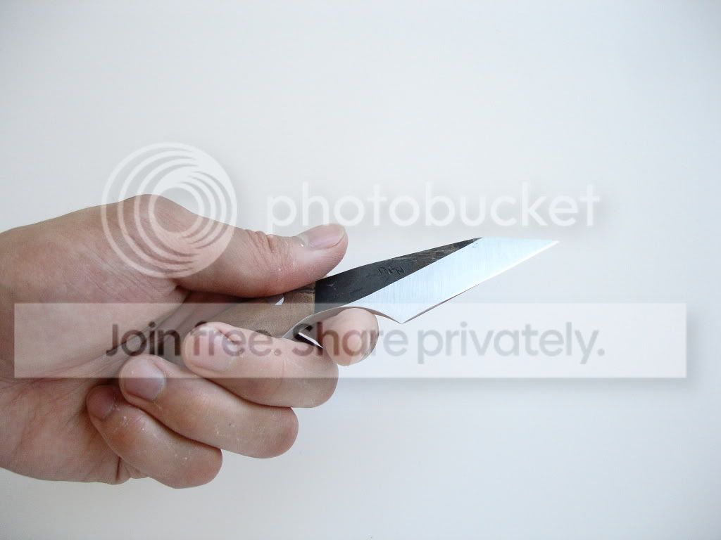

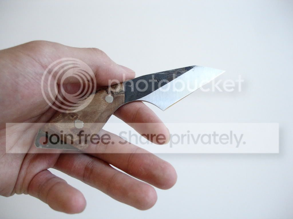

Very nice to look at, angles and all. Is it comfortable in the hand?
I don't really know, since I've never actually used knives for anything. Plus, since it's a really small knife, it's quite different than what I would be used to I think - I don't even know the proper way to hold such a knife :)
Though, gripping it in different ways, I find that there are no uncomfortable parts. With the geometry and angles and whatnot, it rather follows the shape of my hand unexpectedly.
