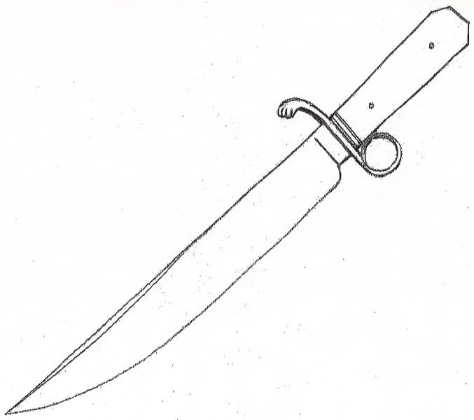

I would like your help on a design I have been kicking around. It’s a Ring Guard Bowie.
We see San Francisco Bowies equipped with double ring guards, however single ring guards on bowies seem more rare. I’ve seen photos in the past of historical examples and liked them. It’s kind of cool how they can be twirled (similar to side arms) while sheathing them, though not so sure I would recommend it.
I’m planning on having this piece (or an altered design of it) made. I have a maker in mind to possibly create this bowie. Though I have an order with him coming up very soon we have not discussed this design. Before discussing it with him and getting his input I would appreciate feedback (positive and negative) and suggestions from you here.
I’m wondering how much interest there is in Ring Guard Bowies?

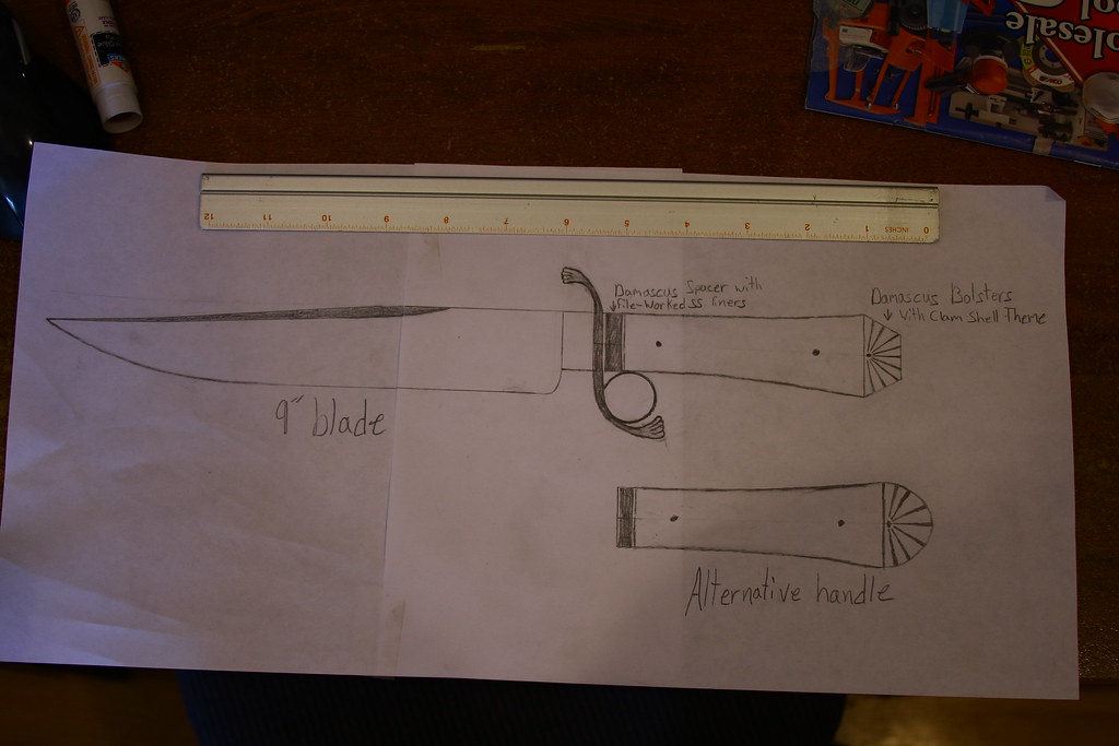

These are just sketches, the proportions are close however they are not scaled drawings.

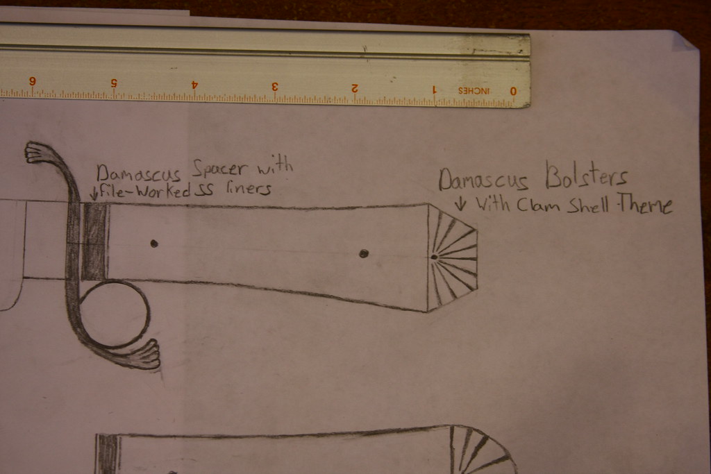

The first has an approximately 9” Damascus blade and the second an 8” with a slightly different blade profile. I believe the guard, frame and fittings on both will also be Damascus though I haven’t decided on a pattern as of yet. Spacers are fileworked stainless steel. Frame constructed coffin shaped handles w/stainless fileworked liners and mammoth ivory slabs.
• Any suggestions/input as to the knife make-up?
• And which blade length and profile do you prefer?
Thank you in advance for all your comments, opinions and feedback.

Kevin, I like the blade profile on the shorter blade. The straighter the clip, the better for me. I think the frame coffin handle will look great. You might review some of Dave Kelly's frame handle work for an idea or two concerning the parts of the handle. A lot of really nice decorative file work can be done using the liners and spacers and yet be very subtle.

Either look good to me, Kevin, even though I prefer the shorter blade.
With a dramatic Damascus pattern blade and cleverly matching handle
material you may probably come up with an amazing piece of knife art...

I like the nine inch version of your designs
I'll have to reiterate Lorien's observation- I think you should really consider making an equal clamshell on the ring side as well. I think it's a great pattern, and deserves to get off the paper as soon as possible.

Not a bad idea at all. I have no particular preference for one blade over the other. They are very similar and one doesn't have a greater affect on the overall design than the other.
Here is how I would tweak the details. The single ring guard is the dominant feature of the knife. As you've drawn it, it is top heavy. The upper piece stands out further than the ring. This throws the visual weight of the knife to the top. I think you should increase the diameter of the ring and decrease the height of the clamshell guard so that they stand out the same distance, or the ring stands out a little more.
Would the guard be made by forging the ring around into a circle, or cut from a solid block of material? Either way, carving a clamshell in the ring to match the carving on the other end is a nice idea, but it's not really going to be seen. Now if the ring were carved in such a way that the main element, the clamshell, was at the rear of the ring (where a finger would bump up against it), not at the end, and the rest of the material that finished up the ring continued on around to finish the circle, it would work. However, I've just created an organic element, and a clamshell doesn't fit the theme. Maybe something more scroll like.
I think the coffin shape suits the overall design. I would probably flair it out a bit wider toward the butt end.

David nailed it (big surprise)--first thing that came to mind when I saw your drawing was "Gee, that looks top-heavy".
The design looks great. Like the suggestion of the double clam shell vs a ring on the knife you sketched, Kevin.
Understanding your question relates to a single ring knife, I'd personally have a shorter blade. If you do spin it the blade length will need to be proportioned to your body, particularly forearm length. Don't know if you have martial arts weapons experience but balance will be everything on a knife of this design. I wouldn't be able to resist practicing with it. Taping the blade is a trick some butterfly knife folks use when practicing (although you can't close it).

I think your second drawing is very nice. If it was me I would go with a blade like your second drawing but with a 9" blade. Also I would make the guard a little smaller on top and a little bigger on the bottom, or better yet make it a double clam shell with the ring guard as in the picture. I would also put a set of rear bolsters on the handle and make the handle a little larger towards the end. As for damascus I would go with an Explosion, "W" Ladder, "W" Feather or a tight pattern of some kind with lots of shimmer.
Here is my take on your drawing. (please excuse my lack of skill in drawing)

I think Kyle and I drink the same coffee in the morning! His flaired handle is what I had in mind, and I do like the idea of the rear bolsters. If you went with clamshells on the guard, then replicate it on the butt as he said. If you want with a more organic guard, then carved scroll-like elements on the rear bolsters. It would work well with stainless or sterling silver, and in damascus with selective etching and texturing. If you like engraving, make the butt bolsters and the ferrule flat, and you'd have them and the stainless false tang frame for some nice engraving.

+1 on a rear bolster. Likin the idea of echoing the theme from the guard there, too:thumbup:

The maker I have in mind for this piece often utilizes finials for his handles. I left the butt condition off my drawings as it will most likely require a rear bolster condition to allow for ivory lengths. There's so many options for the rear condition I thought it better left for discussion with the maker rather than draw something in this preliminary stage of the knife's creation.

David, thank you for putting so much thought to this. Just what I had hoped for. You addressed several items of the design that I had struggled with.
The top guard does perhaps extend away from the blade too much making it as you say appear "top heavy". I believe I over compensated as I deplore when shell guards crowd the blade spine. I like a finger width between. I drew it with what appears to be a bit more than that.
I was leaning more towards forging the ring rather than cutting from a block of material. I like your idea of integrating a second clam shell into the ring. Would be interesting.
As far as the taper of the coffin handle, I prefer a more subtle flare as opposed to one that screams coffin at a glance. I hope others will give input on this as well.
I also agree the second blade profile especially screams for carbon steel with a crazy/wild hamom, however I'm a damascus "NUT". :o ;)
