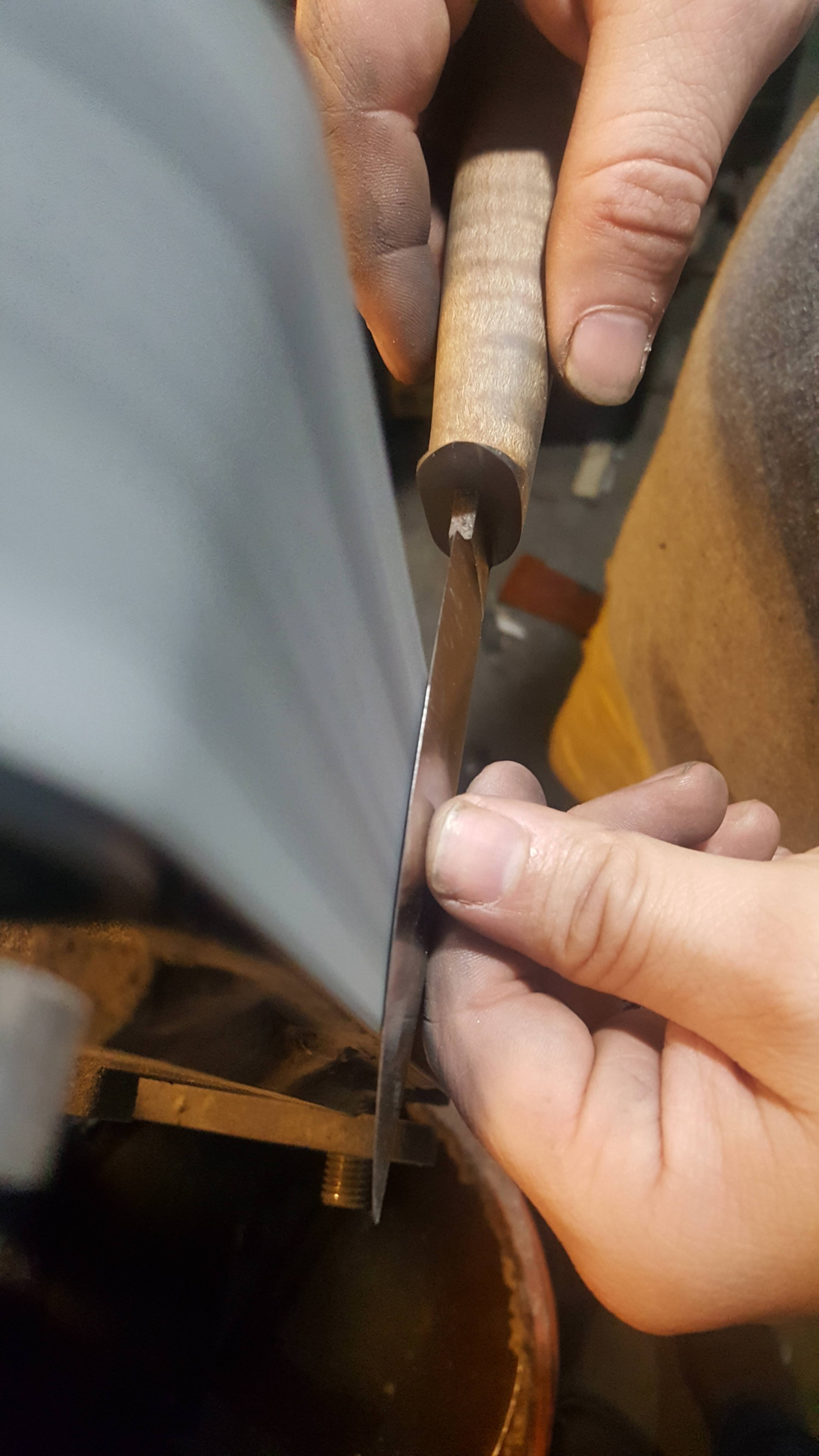

Not sure how well you can see this. But im using a ceramic glass platen on a very nice waterjet cut home built grinder. Im guessing the ceramic has worn out in the middle. As now when i grind the blade only touches on the edges. I plan on getting one of Nathan's platens when payday rolls around.
This is only a year or so of use btw
