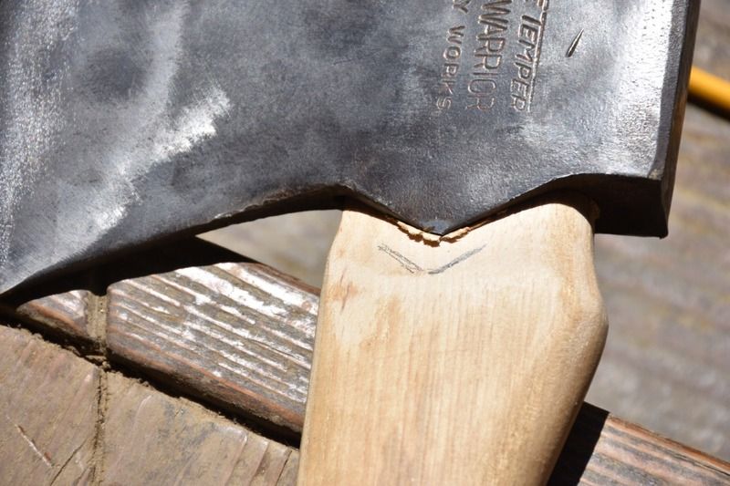

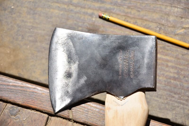

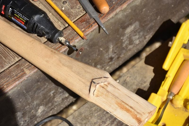

I’m trying to hang this Kelly Works Red Warrior, but it’s not going well. The lugs are so narrow and tapered inward at the tips that they need to dig in deeply to the haft for the head to seat.
If I rasp/sand the haft enough to accommodate the tabs, the head will be loose everywhere else. The only thing I can think of is to chisel out bays on each side of the haft for the lugs to slide into (where you see the pencil marks).
The inside of the tips of the lugs measure 0.0657 inches. The base of the lugs measure 0.715 inches. Maybe the lugs got bent inward, but it's difficult to tell.
The kerfed haft is tapered enough so that it slides in easily from the top, hanging up only when it hits the tips of the lugs.
Before I start to chisel deep lug bays into the haft, I thought I’d ask for some advice. I’ve never hung a head with lugs before.
You will either have to cut them in or slim the haft. You look to be pretty close, I would just cut them in.
OK, thank you. I'd just never heard of people having to cut bays into the haft for the lugs. Figured I must be missing something -- which is always a safe bet.

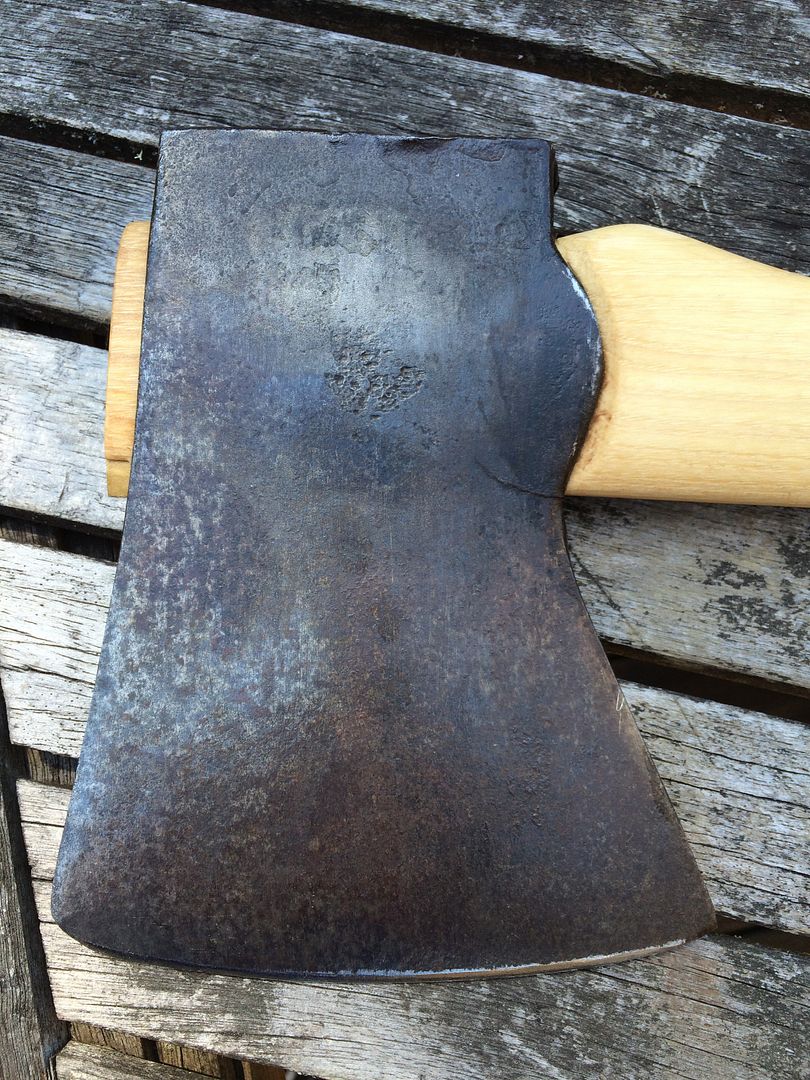

A plumb 4lber I cut the ears in. And a council from the factory with just the handle under the ears.
A Kelly perfect with the original handle and ears cut in. And a plumb with a handle thinned ears "over".
A close-up of the four pounder to show the ears are indeed cut in. (Crappy photography night)
Well I'm starting to cut the bays in about an inch, which means removing a lot of wood from the shoulders. The thing is that the points are so crimped that if they're tight against the haft, the base of the lugs will be loose. Seems like a good way to have the head come loose.

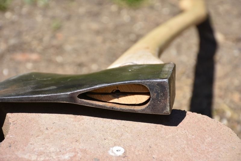

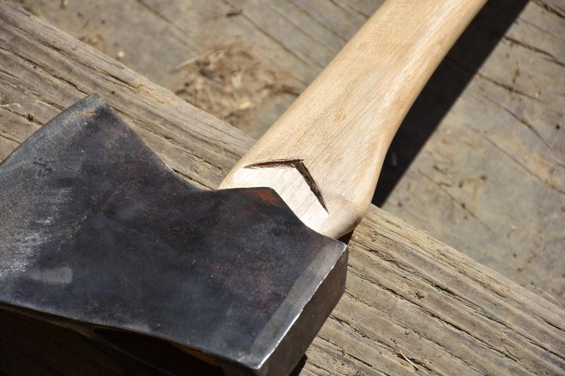

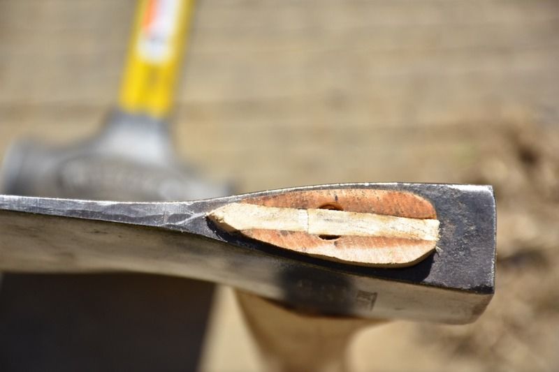

Well, it didn’t turn out that well. It’s difficult to cut those bays into the haft because you have to cut them precisely enough so both sides settle evenly into their spaces.
And you have to leave just enough width to the haft shoulders so the head jams on hard. All that was beyond my ability, short of making this a weeklong project.
A lot of wood had to be removed. This was my second extension of the bays.
Here’s the bay with the lug approaching. You can see how deep that cut had to be.
Here it is fully set. The gap is ragged, and much of the resistance to further seating came from pressure against just a few spots, but at this point the head was stuck on hard.
The wedge went in tight, but it should have been longer. It could have gone in more. I ran out of wedge. I poured a lot of Swel-Lock into the kerf and on the wedge first — but it turned out that I grabbed the wrong bottle and poured Axe-Guard in instead (metal protectant). Either a senior moment, or I was in a hurry. At least the wedge won’t rust.
Otherwise, not a bad axe. I’ll try soaking it in BLO later. Maybe that will help.

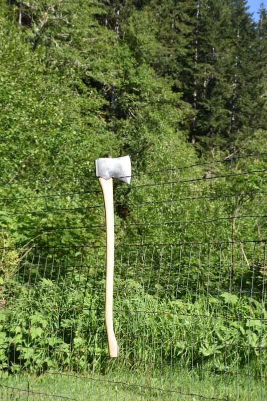

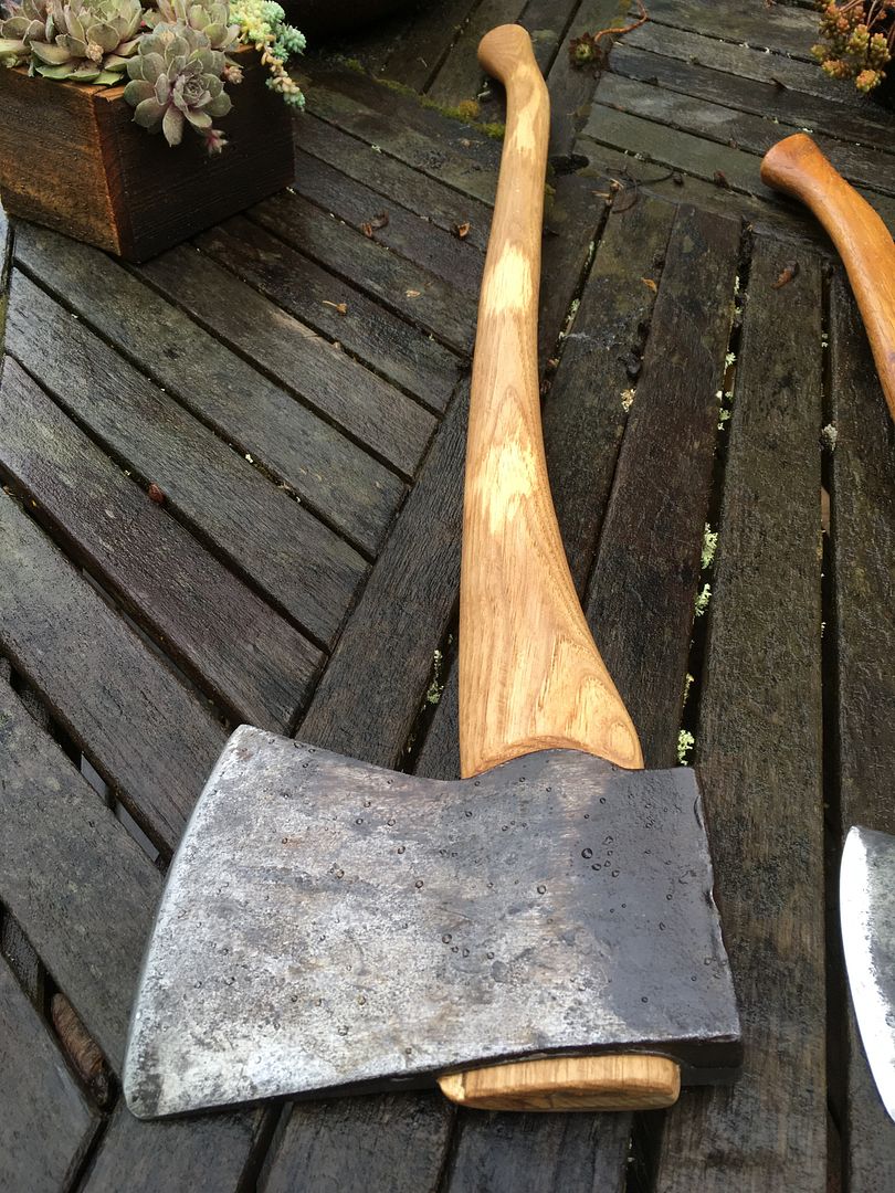

Those lugs totally make a Jersey. They are classic but to hang them you pay into it as work.
One option is taking the whole handle thin all the way and not fight it:
I think cutting-in looks good and lets you keep a little more meat on the handle if you want. Same head, two handles:

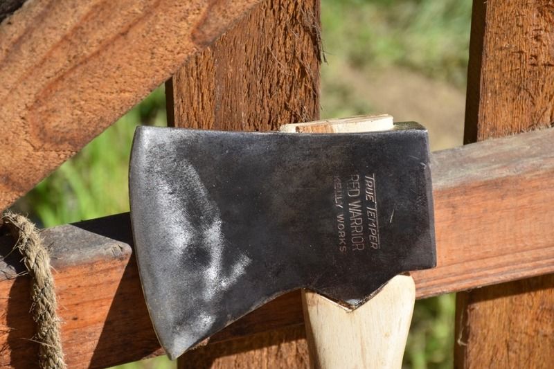

Twindog, I think that is a really nice looking package in that axe. If it is wedged tight then it is a fine head on a shapely handle.
Having the head fit just shy of a ledge takes patience and is sound for the first life on a handle. You can always use it and change the shoulder at your leisure.

I did go too fast, but I remounted the head about 8 times. Poor skills certainly were an issue. Once those bays got off by just a bit, the whole hang went sideways. I'll clean it up, soak it and see how it holds up to a serious splitting session. I drove a couple small copper nails through the exposed haft and into the wedge, leaving them just proud enough to block movement of the head. I'm guessing it will be good. Makes me appreciate the fine hangs I see people doing here.
Twindog,your hang looks good,and solid,and hopefully it serves you well and long.
