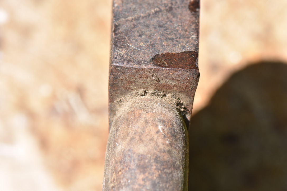

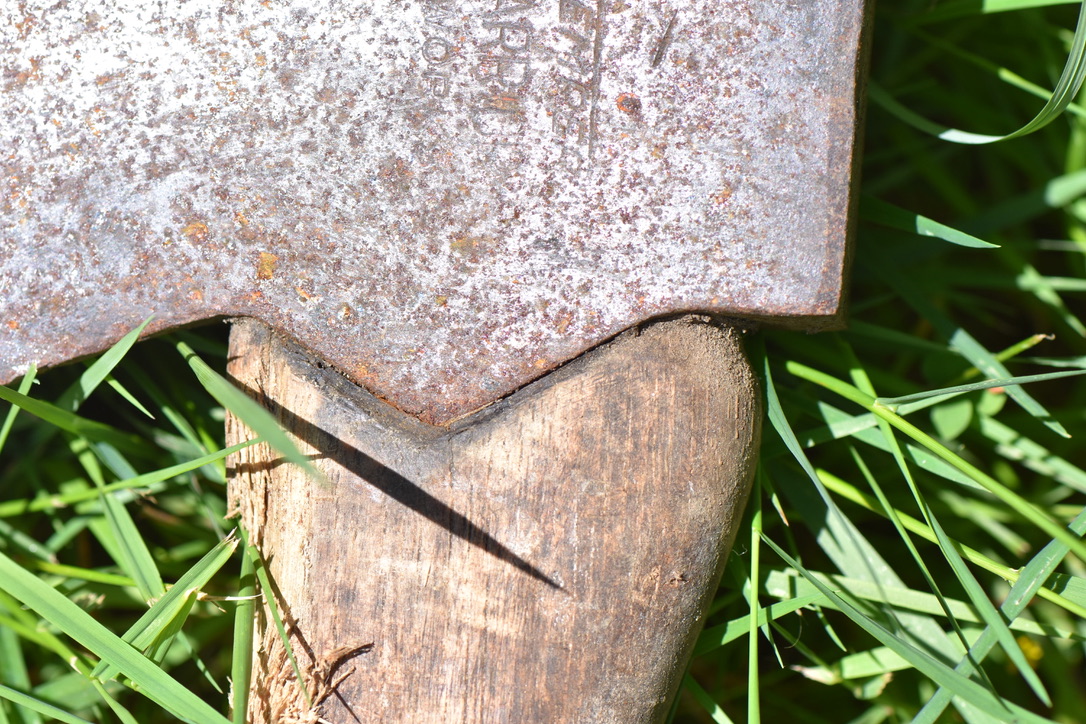

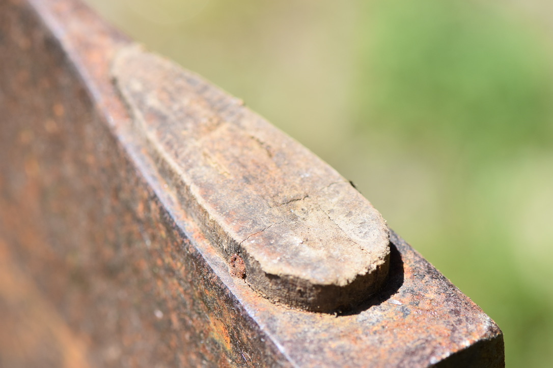

I did notice your dremel tool. The sanding band in my one picture is only there halfway - the unsupported part rounds over the rubber.
Normally this is properly installed:
But when you start with it like this it makes it pretty easy to round the edges of the "bay" from the shoulder to the tongue as it gives over the end some.
Straight or in an "arc" under the lugs.
Ends up wearing like this one:
But what I didn't have to contend with is the lugs on mine being pinched in - that is a challenge in itself.

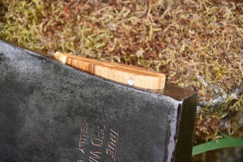

Just to close out this hang after overnight soaking in BLO:
I took some of the advice above and cleaned up the bay boundary with a file and sandpaper. I let the sawdust mix with waterproof glue. Not as good as the examples posted above, but OK for now.
And because I lubed the wedge with Axe Guard by mistake (rather than Swel-Lock), I thought I’d better add some mechanical protection against the wedge sliding out. I used a small copper nail on each side of the haft, long enough to penetrate the wedge. A little hokey, but I was out of bailing wire and it feels like it will work.

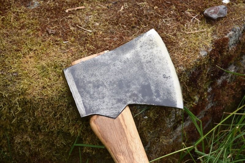

I don't cut them in. I just hang them the same way I would any other pattern - thin the tongue and shoulder and remove material in the tight spots until it's seated. With an axe that's going to be splitting in particular, I don't want the shoulder to be fat.

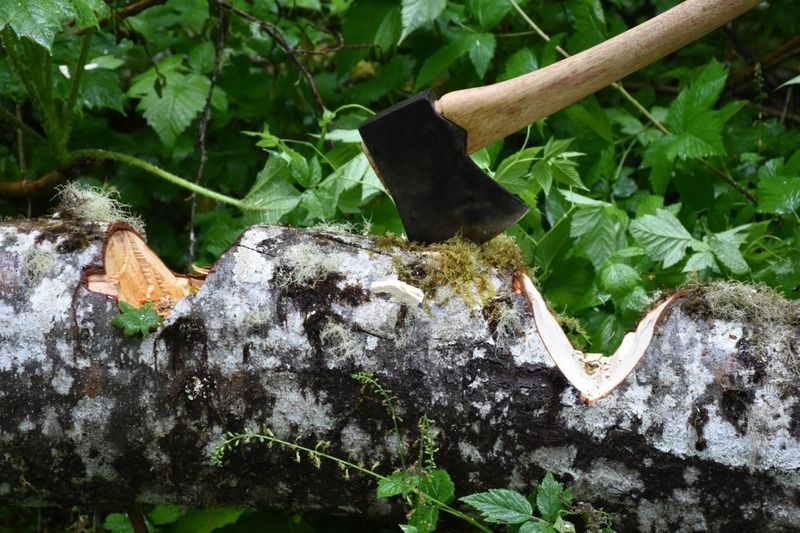

I took the Red Warrior out for a chopping session, and it’s rock solid. The head didn’t move at all on the haft. I chopped a test log that I’ve used for other axes. It did pretty well — although because of geometry and handle length, not hang. With half the chops, it cut a V twice as deep as my smaller Council Hudson Bay. It did want to stick a bit, but nothing troublesome. Sent big chips flying.
I did some normal chopping, including some off angle strikes to test the strength of the thin haft. I hammered on a log with the poll. And I did a few not-too-hard over-strikes on both sides, hitting just below the lugs to get a feel for how solid that thinned haft is. It’s solid. Felt good. I’m not worried about this axe.
Thanks for all the help and suggestions. I learned a lot with this hang.

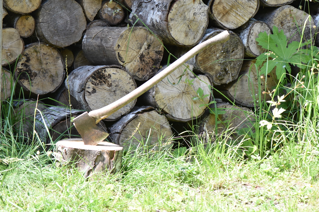

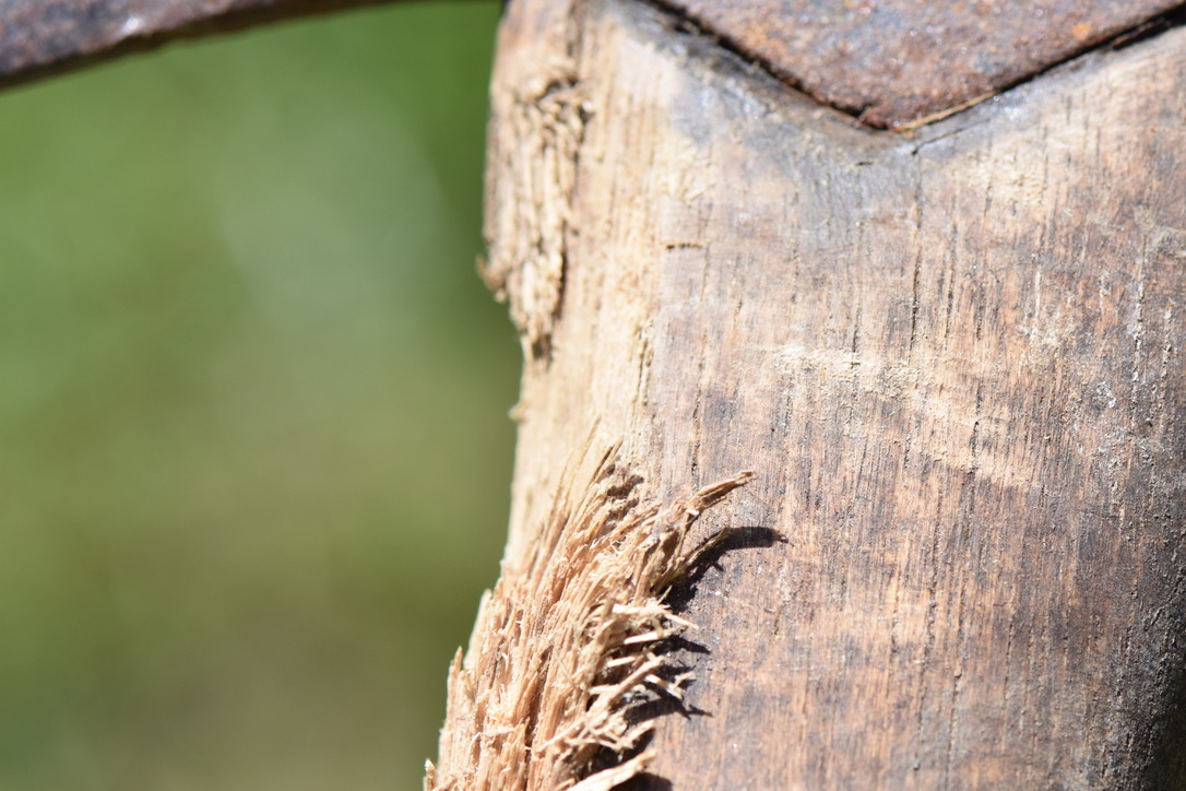

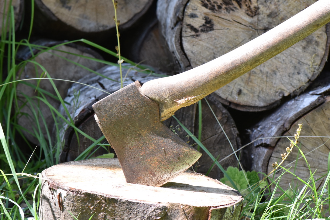

It's been a little more than two years, and this lugged Red Warrior axe has seen it all. I loaned it to a neighbor who learned to split wood on this axe. You can see all the over-strikes. She left it out in the rain. Beat the holy ghost out of it. And then left it laying outside in the dirt after she left. It split about 12 cords of wood -- fir, spruce, hemlock and alder.
It wasn't my best looking hang, and I wondered if it would hold up at all. But, dang. Once these lugged axes get a bite on your hickory, they don't let go. She's still as tight as a Scottish tick. Thought you all would like to see the long-term performance of this troubled hang.
hoffman_axe_fit by city_ofthe_south, on Flickr
3lbtruetemper_fit by city_ofthe_south, on Flickr
Edit; I see now it's a Liam Hoffman. Would you mind sharing the brand of axe in the top photo? It's very nice looking. I think I might just need one if they're available... Beautiful hangs btw...!

The proof is in the pudding! For all the trouble it caused you it sure turned out a great hang. Well done!
