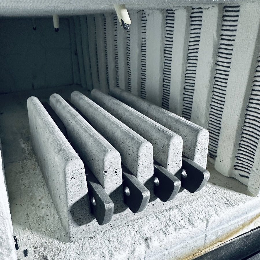

Oh wow, I have never seen a rack like the one Luong just posted. Well, if it's something like that, which I never would have imagined anyone using, then yeah, that's a possibility.
Was the rack fully heated when the blades went into it? I would think if is was heated fully to the same temp as the kiln before blades were put in, it wouldn't have much effect? Or are the blades cooling the rack down when they go in, slowing the heating process?
I preheat the rack with the kiln and it goes up to temperature along with the oven. I also let it preheat for at least 20 minutes. If the blades are cooling it down, I don't know. I hadn't considered that.

That's the rack I use. Do you think a longer soak time will help? I have been preheating the rack in the oven beforehand.
20+minutes soak would ensure blade in the middle aust properly. There are 3 main factors need mitigation to resolve heating issue: radiant occultation, flow(gradient air) restriction, rack divider mass.
or easier just use standard ht rack.
