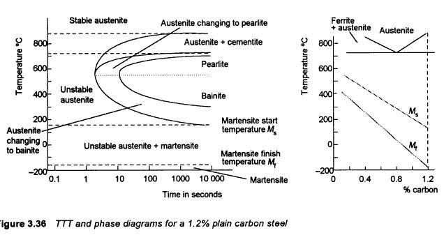

The conversion is not continuous. It starts at the Ms and stops at Mf. Most steels we use have a Mf well above room temp. In O-1, virtually all conversion happens between 400F and 200F. Once past the Mf, any austenite becomes retained austenite (RA). The amount of RA in O-1 is nearly 0. Any that stayed would not convert until a very low temp, around -90F. Between 200F and -90F little will be happening. At -300F the carbides undergo some conversion. That temp is cryo. refrigerators and such won't get that cold. -90F is sub-zero quench. Refrigerators don't get that low either.
I'm also not wanting your question to re-start the refrigerator topic, so I'll just say that no quantitative internal changes occurin most steels between 70F ( room temp) and 0F (top grade home freezer), or even -30F ( top grade commercial deep freezer).
Notice I said it's continuous, but non-linear, between Ms and Mf :)
The Mf for high carbon steels are well below zero. That's why sub-zero quench works.
