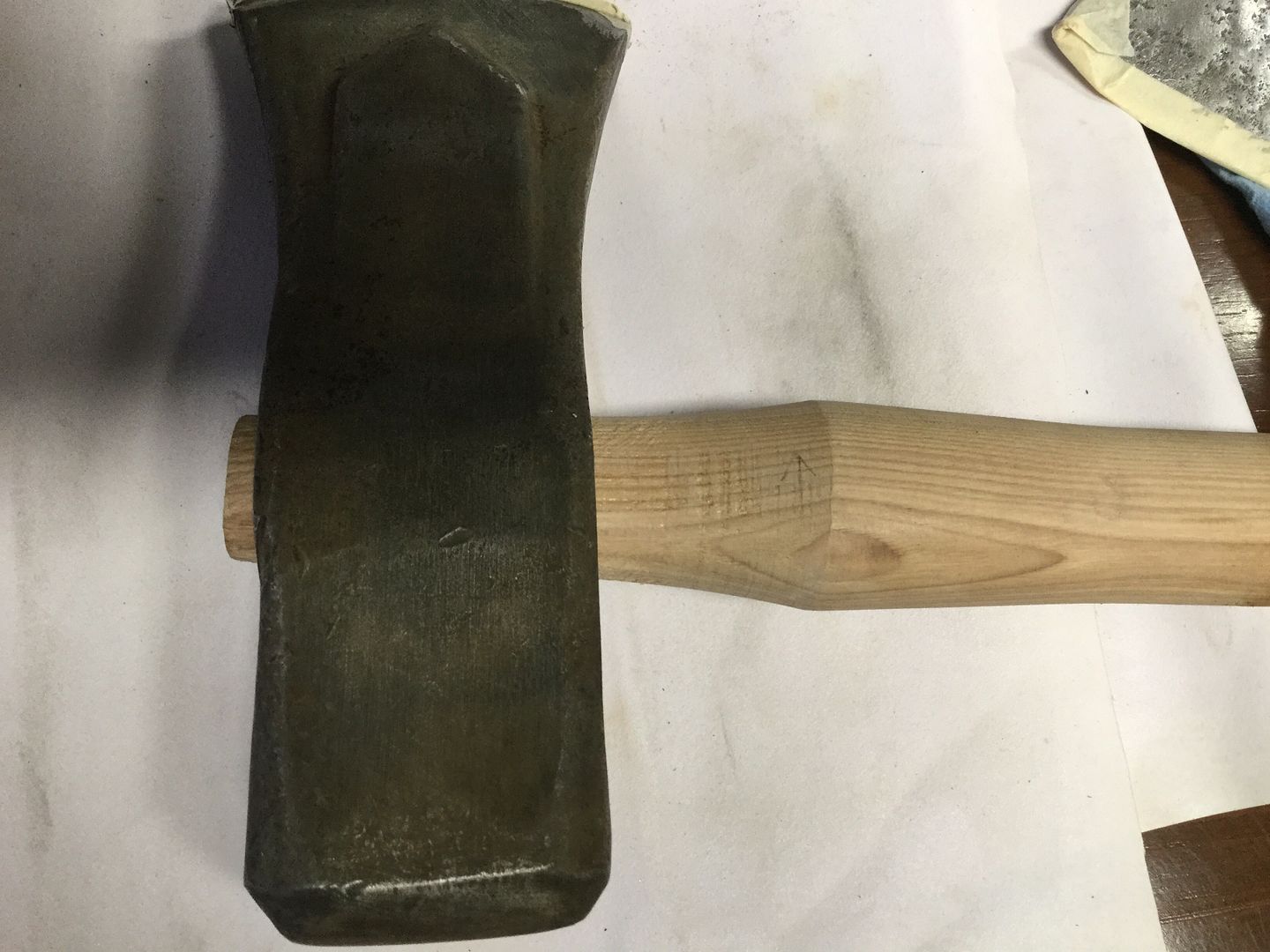

Hi Guys,
This is my first hang, not a fancy maul head but, it has been fun. I am also doing the Jersey axe at the same time but, do I have to go another inch deeper? Will the cut of the top of the handle open easier when it will be higher? Cause I believe now it is no way I can put the wedge
Thanks in advance for the help
If it were me, I'd take a wood file to it and bring it back some, closer to the shoulder. I also would take a handsaw to the kerf to open it up for the wedge.
Handles/haft need customizing most of the time.
I've only done a few rehangs, so there are people here more knowledgeable than I in this area. But basically you need to reduce the angle to as close as it can get to the eye. You want the wood to be filling the whole eye and in contact with the steel before you even put the wedge in (or as close as possible). So you can use a knife if you're good with it or drawknife, rasp, and sandpaper depending on how much material you have to take off. Looks like a fair bit to me but you still have to be careful.
You can just put the head on loosely, then use a marker to draw some lines where the material should be removed. You may have to go more than an inch, probably two thirds of the way to that arrow. You just want a gentle slope so that the kerf is open but the handle just slides in snug all the way through the eye.
Read through "An Ax to Grind" or one of the other free publications.
yeah go ahead and bring it down a little. By taking off some material down where it's tight, the kerf will likely open up some.
You will most likely have to still use a saw to saw the kerf/wedge area anyway once you have it where you like it as it will not be deep enough. 2/3 of the way seems to work fine.
Plus what I do if a lot of wood protrudes past the head is cut it before the wedge.

Put it some more down and it open the kerf....now I have to test it

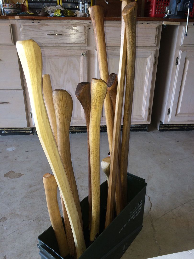

The last thing I do before I drive the wedge in is give it a good coating of BLO. It helps lubricate the wedge, and it may create a bit of swelling. Once the wedge is in and nicely trimmed, invert the axe (so that the wedge is at the bottom of the container) in a container with 1" of BLO in it. Let it sit in there for 48 hours. The wood will swell inside the eye as it absorbs BLO, giving you a secure fit.
I have started to on my more recent hangs, drive the wedge as far as it will go, then letting it sit for a couple of days before hammering on it again to drive it in more. And it will move further no matter how far it went originaly as long as there is space left in the curf. once all that is done that's when I cut the excess of and soak in linseed oil
linseed oil or boiled linseed oil? I'm either confused or see conflicts. Some say linseed oil is better than BLO and only use BLO in a pinch. Does it matter?
Something along these lines?
I use BLO. I just usually end up typing in linseed oil because it's quicker to type. Sorry for the confusion, most people I know use boiled, so we know what one is talking about when we say linseed oil.
