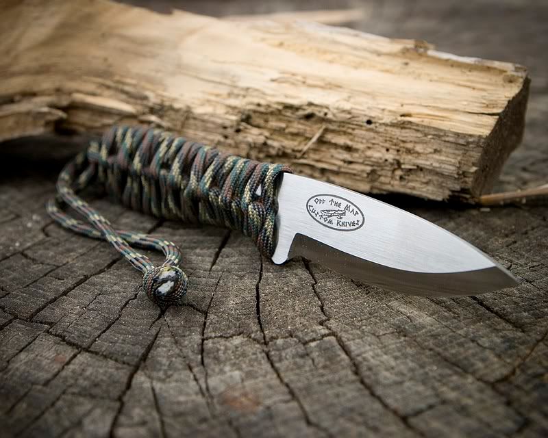

Well, I have solved a couple problems and created a couple more with this one :D

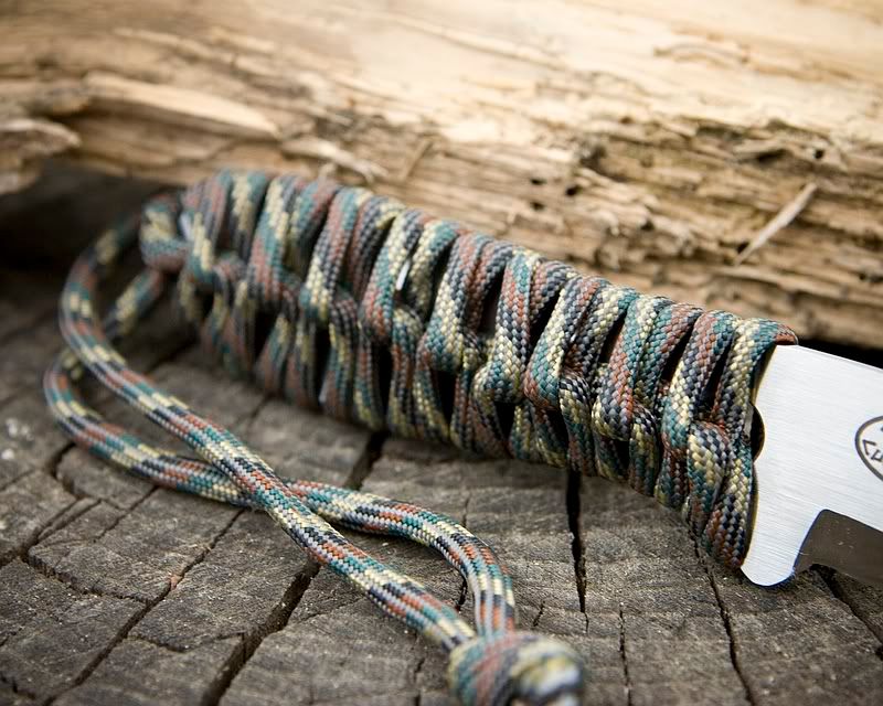

I found a way to cord wrap the current handle, with the current hole configuration.
Bottom line: I like the knife both with and without wrappings. But, with the wrapping, I have a couple problems.
1) My leather pouch neck sheath I made no longer works, because it sits too deep and the cord stops it. Would have to go with a different style.
2) Cord wrap adds bulk, and I am almost not sure that I wouldn't rather have scales. Although, this is inexpensive.
3) Kydex looks out with cord. I wanted to do leather and kydex sheath. However, with the cord so high on the handle, I don't see a good spot for kydex retention. Without the cord, the post-guard area (and first hole) would have been perfect.
So far, I think I am going to do this 3 ways. As is, cord wrap, and thin scales (to keep it a necker). Just got to figure out what to do for sheaths for all those options.
I still think I'd try wrapping one with epoxy soaked leather cord, tightly wrapped this will make it less bulky than the para-cord and will look nice and traditional sat in a nice leather neck sheath !!!!
Looks great.....but yes... sheathing it now seems to be a bit of a toughy. hmmmm...
Brian, I have a couple of ideas for the sheath, but they are going to require alot of explanation, so be expectiong an e-mail.

A necker with a cord handle is a good idea because when I think necker, I think survival knife, and the cord wrap gives you some emergency cord.

My suggestion is from experiance when I designed the project w with Ray Laconico is to bevel the handle profile and holes in handle and then leave the blade spine squared for firesteel use. It makes the blade as comfy as it can be w/o a cordwrap. Plus eliminating the sharp edges on the handle saves wear on a cordwrap.
This would be stellar in CPM154 for corosion resistance, but IMO its not nessisary really. The O1 in the project w did ok.
