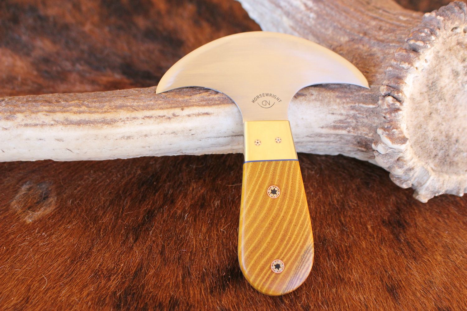

As a leather craftsman I would find that design limiting for what I do. I would find that design great for straight cuts and long sweeping curves for instance if I were a saddle maker. However for a lot of the tight inside curve cuts that I make, welt trimming, lining trimming etc I would prefer to use (and do) something with more point on the end. The pointier the end the sharper curve that you can cut. Something like this I think would be more practical for general sheath work. This went to a BF memeber.
My own personal one:
Here's some examples of the type of cut I'm talking about. On the holster by the trigger guard and on the Beltless sheath on the right bottom curve from the sheath body to the belt loop strap.
Or these curves on the leg yoke for this pair of woolies we were making.
Even something as simple as these ladies spur straps I would find difficult with that design:
Where that design would excel would be these martingales or rifle scabbard. Long straight cuts and sweeping curves.
So maybe think on the use of the knife before locked into a design.

They come in all kinds of sizes. From as small as2-3" across point to point to as large as 6-7" across or bigger. My own personal ones are about 4 to 4.25 point to point. Many commerical roundknives (I'm thinking of some of the Tancy ones and the Osbornes) have too much handle. They were desinged this way on purpose for the end user to reshape as suitable for themselves.
I have made some with more of a blunt nose on one end. They cut well but I still prefer a little more pointy.
Understand thats just my preference and doesn't make any other way right or wrong.
This is what you are trying to get. Slicing easily through 10oz saddle leather. Doesn't take much to stick it in the cutting board. When I started making my own roundknives I had to switch to this Hydroma cutting board. I'd get stuck in the roller mats or the white polys.
How I hold the knife and use it for probably 90 percent of what I do. Again not right or wrong here just what I'm use too. Trimming a welt in a sheath here.
