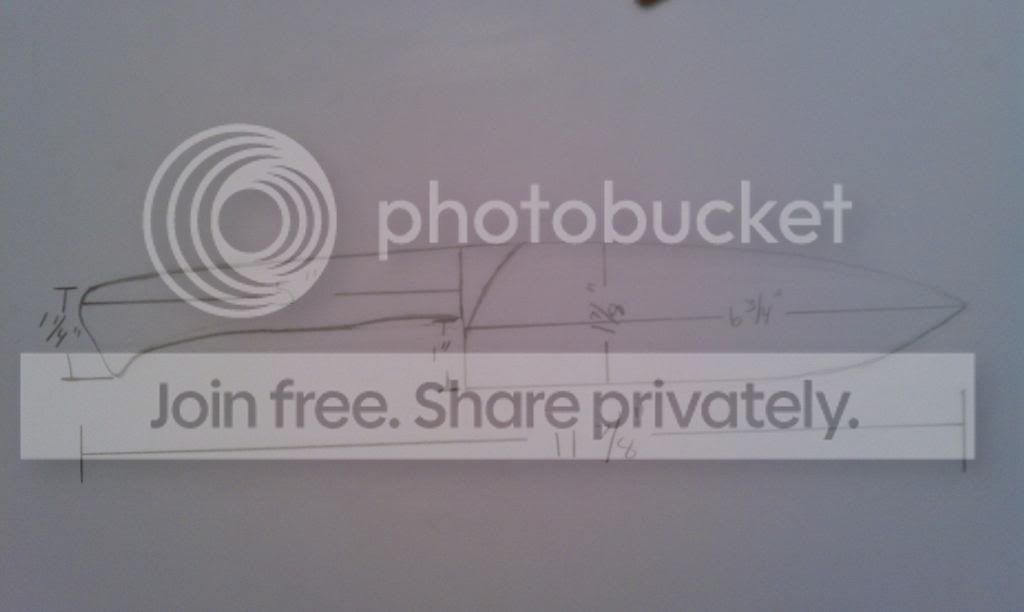

So here it is, critisize it to death, I know my drawing isnt very good but it is the best I have done so far. Here are the dimensions.
-OAL 11 5/8''
-Blade length 6 1/2''
-Handle length excluding ricasso 4 3/4''
-Ricasso is 3/8'' wide from handle to blade and 3/4'' tall
-Thickest part of the handle is 1'' which is at the Butt
-Spine to edge thickest part is 2''....looks kind of funny I think maybe a little smaller???
- 154cm stainless steel 1/8'' thick
If you guys need any other information let me know, Thanks

Looks pretty good to me.. You could drop the tip a little bit and stretch the curve on the spine along the entire blade to help the "flow"
I like the blade sketched above it! That looks pretty sweet :D

I'm guessing that you mean the Bolster is 3/8" by 3/4"....not the ricasso.
My drawing skills aren't all that great, but it might be the bolster. I read the definition of both and I think it is the ricasso, Idk. See the part in my drawing where it is shaded in with a pencil? That part is going to be flat and the bevel will start right where the pencil shaded portions turns to marker. From what I have read I thought a bolster was part of the handle, in the drawing it is going to be flat, but the more I look at it, it does look like it will be part of the handle. I am going to make a new drawing today to refine this one a little. Thanks for the feedback

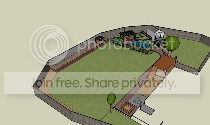

here's a rudimentary layout of my mother-in-law's backyard we were helping her with... show her the final product of sorts so she had something to work towards...

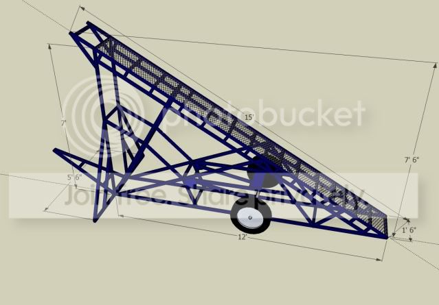

here's a mobile articulation ramp i designed for our offroad club
so alot can be done with it...
