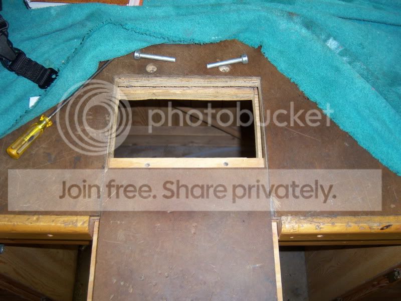

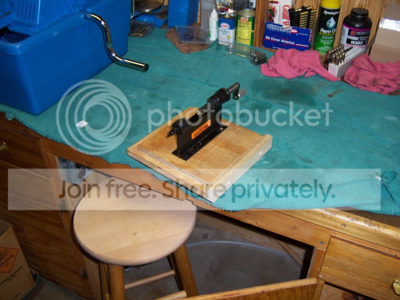

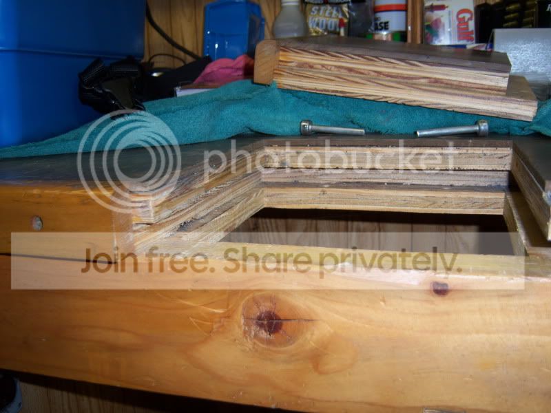

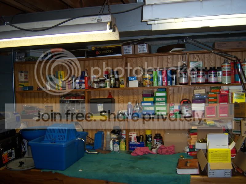

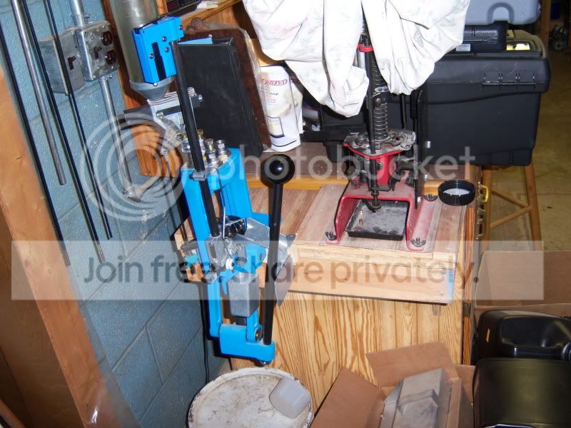

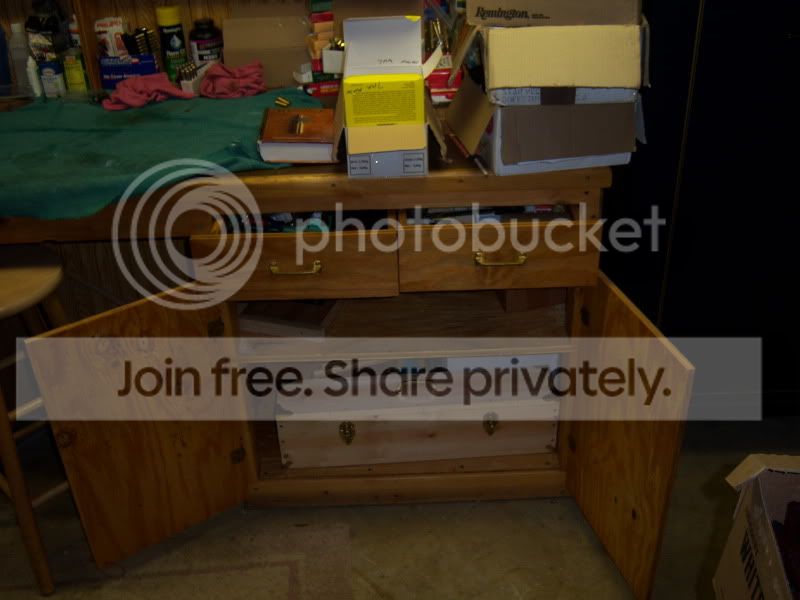

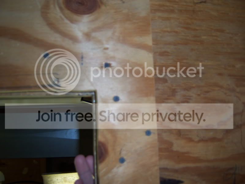

This is the bench I use for my gunsmithing and most of my work. The other "wood working" bench is just a sheet of 3/4" over a 2x4 frame. This might give you some ideas on things to add into the bench. The center is removable, and the bench is powered. Powered as such it has working outlets, light and all built in. Though the light is a magnifying jewelers type of light.
Its a 2x4 frame with a masonite top. The removable inserts are pictured, as is the underside of the assembly, and the side storage for them. You might want to build cupboards topside as the grinder is going to throw dust all over whatever is behind it, or just skip them there. Another thing comes to mind.. leaving more room open on the left or right side for tools to be setup. This is only setup for one thing at a time and it works great for processing alot of ammunition, but as a knife maker you might be using several tools at once and changing them could get to be a hassle.

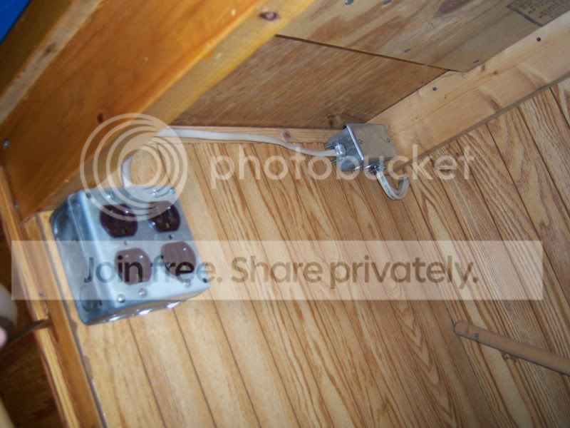

Lighting and electric are always nice to have close at hand.
