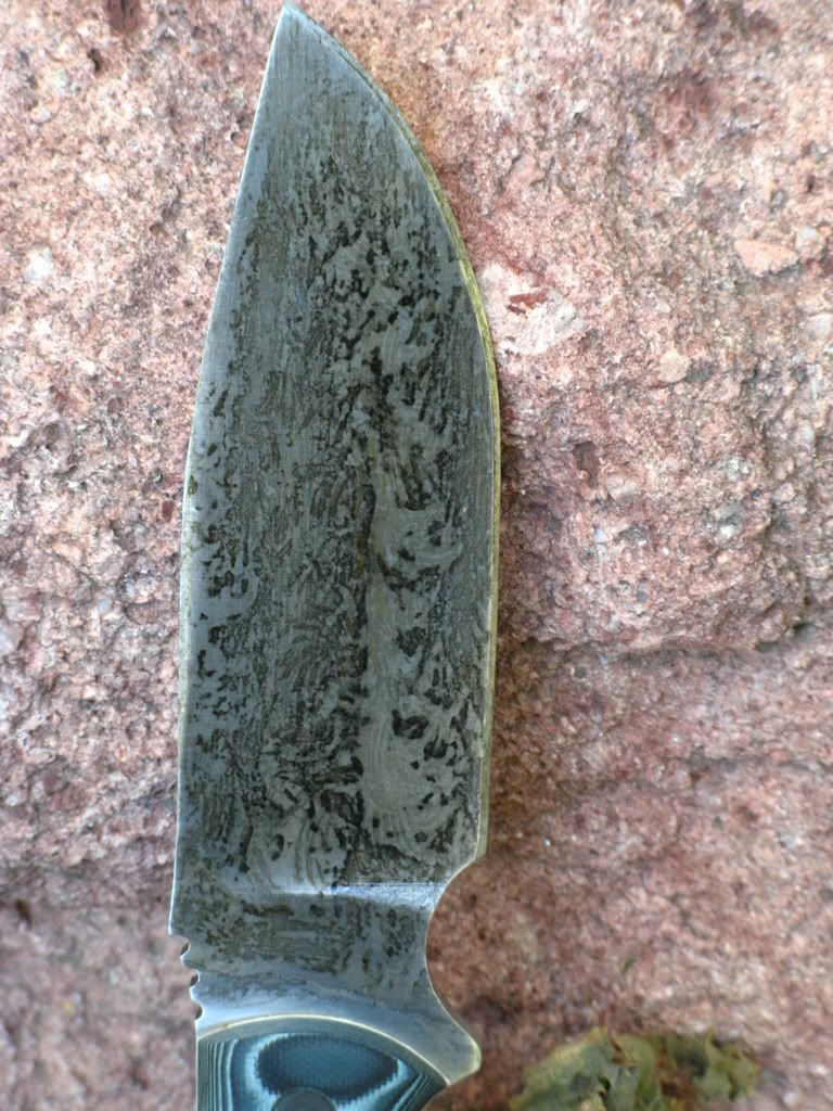

Crappy pics:

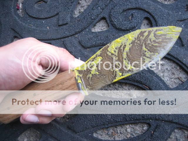

Smearing
Tight finger swirls:
You'll notice the first application works best.
It will darken mostly in the areas where the mustard isn't. Did that make sense? I did this Ranger a while back.

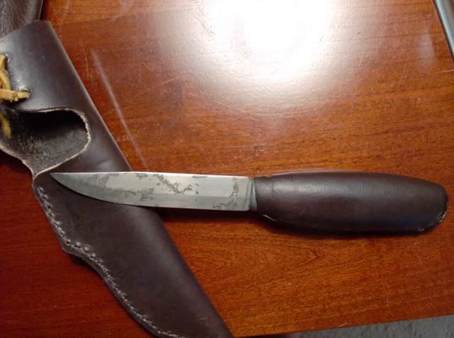

I've used both. The lemon (or lime) juice will work well. Just fill a glass with it just enough to cover the blade, when you dunk the knife in blade first. Make sure you clean and degrease the blade fully before soaking it! Just let it sit for about 45 minutes or so, then take it out and rinse it off. Good to go.
Here's a mora I did last year-

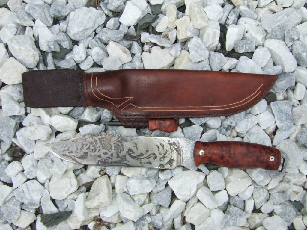

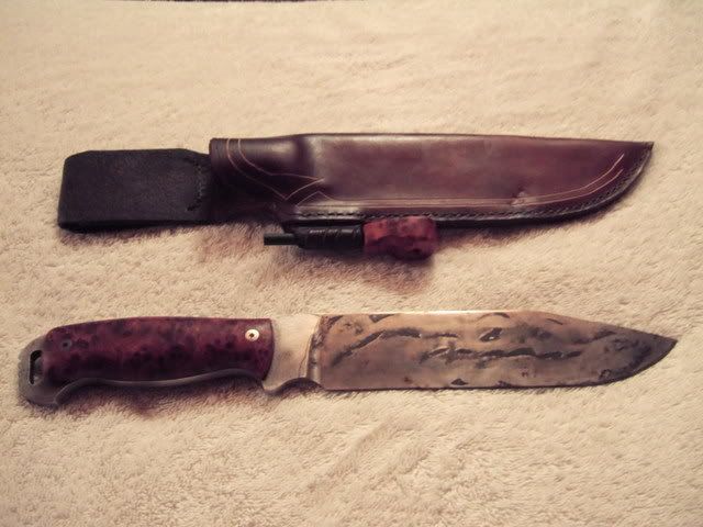

Edited to add: Here's another mora that I added smeared some mustard on and then soaked in lemon juice:
